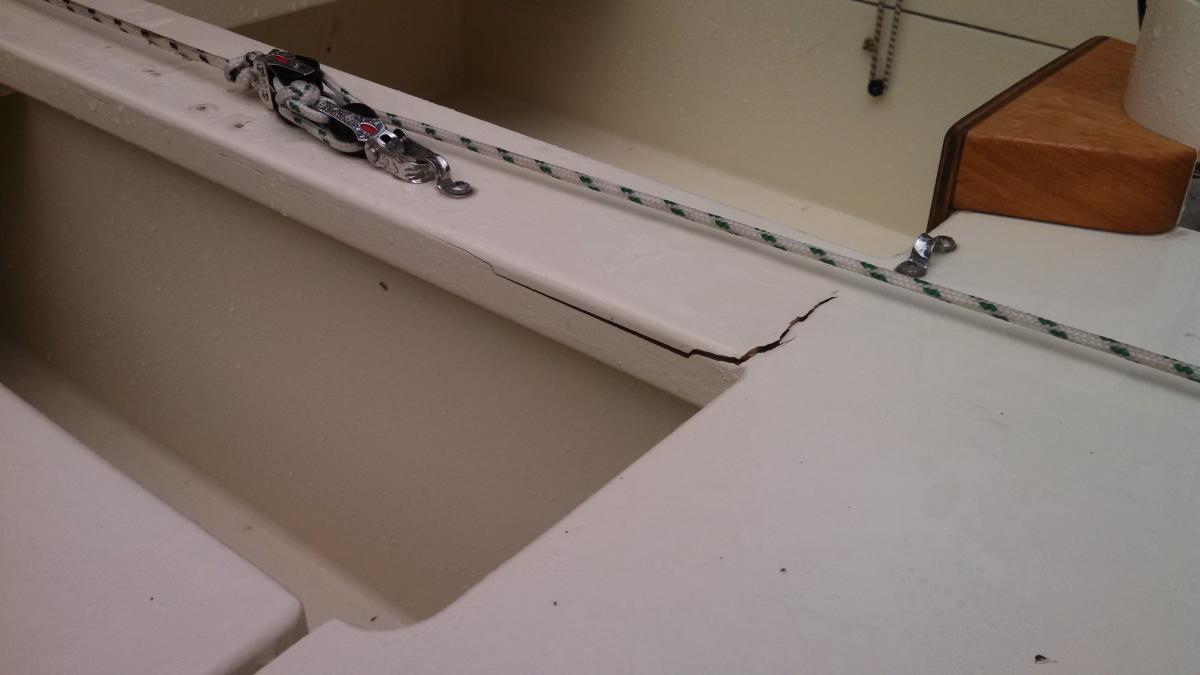

The tip of the centerboard is lead and quite heavy.  On the 11 hour drive home when I went to fetch the boat last October, the highway road bumps were enough to bang the centerboard into the top of the centerboard case and crack it.  Be sure to put a bumper inside the case if you plan on building one of these boards.

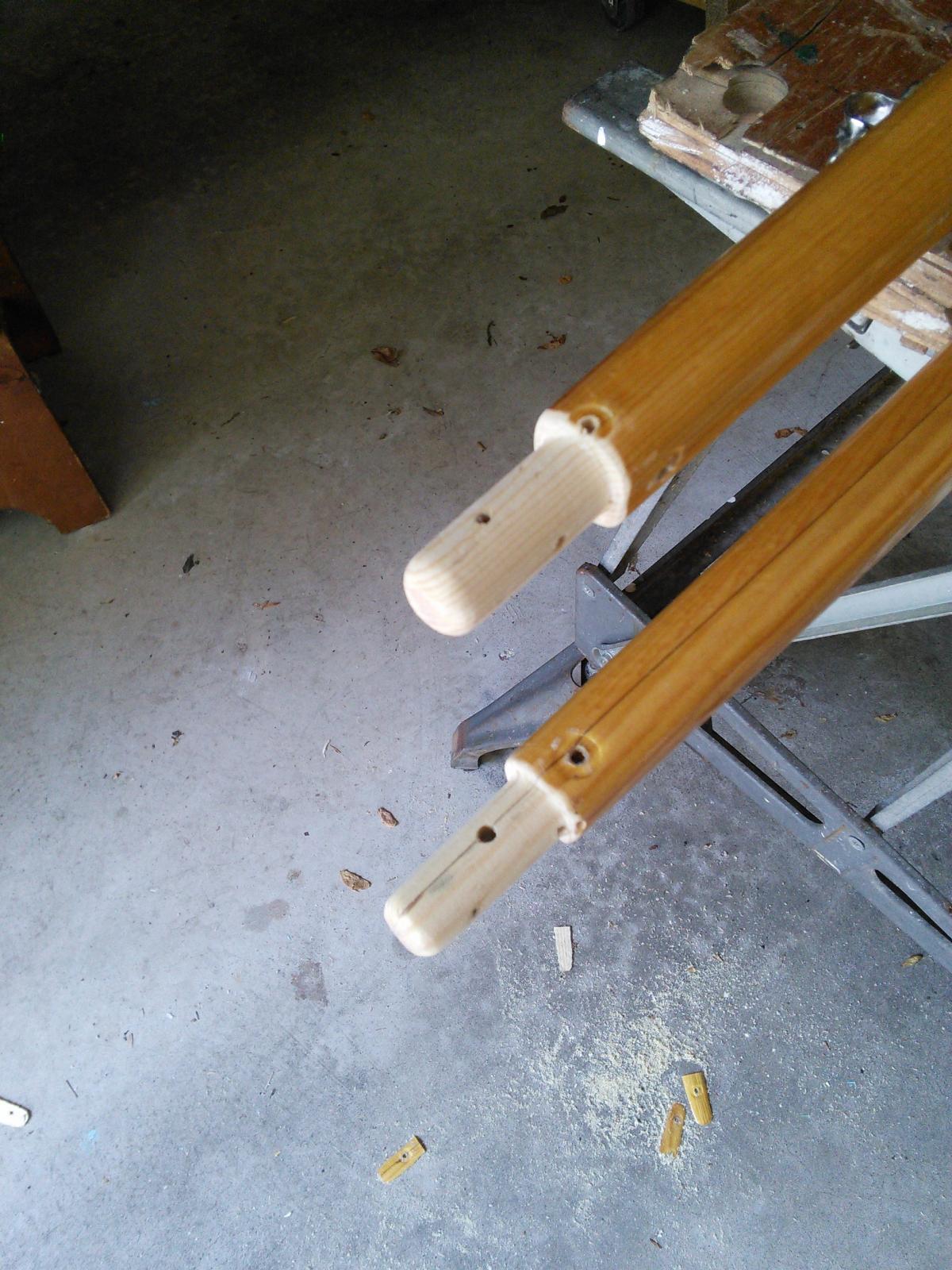

By the way, I decided to make my oars out of tulip poplar.  http://sail.fsanmiguel.com/2014/01/tulip-poplar-for-oars.html

I'm interested in the idea of a roller for resting the centerboard on.  I can't say whether there was a severe bump that broke the cap of the centerboard or just a lot of small bumps because it happened on an 11 hour trip and I don't remember any particular bumps.  The reason I think it broke as a result of bouncing is the location of the crack (picture looking forward):
If I give the centerboard lanyard a good yank I can make it bounce up and hit the cap of the centerboard trunk right where the crack is.  My concern about leaving the centerboard on a roller on the trailer was that when I hit a road bump it will swing up and still bang the centerboard trunk cap.  I was thinking that keeping the centerboard close to the cap would reduce the banging force (lanyard elasticity, dynamic foces, etc).  I think that this is probably wrong or at least insignificant and the conventional wisdom is better.  Thanks!

My blog has comparisons of various woods for oars including weight, elasticity and bending strength.  Picture below shows tulip poplar oars in the process of shaping (that is my grandfather's crafstman jointer).  I'm using Graham's oar design for spoon blade oars.  I felt like Norm (from This Old House) using a jointer for shaping the looms when I could have done it with much simpler tools, but hey - use em if you got em.
