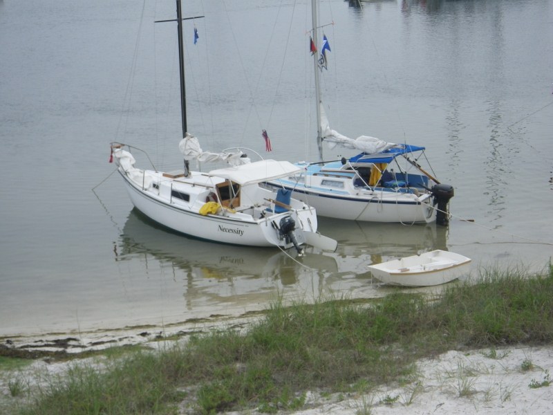

Charlie Jones Posted March 20, 2014 Report Share Posted March 20, 2014 OOPS I for sure missed the "26" part. Yes, I was thinking of the 22. Here where I live the tides are maybe a foot, once each day.. On the Florida west coast still one high, one low each day, and again maybe a foot. EAST coast of Florida- 2 tides a day, and in North Fla, southern Ga, 4-5 feet. Move up into north Ga, South Carolina, and the tides run 7-9 feet and on springs, as much as 11. So for sure consider where you are. Still, anchoring and swinging the stern around is a better idea than doing it bow first, just for ease of boarding Sorry if I mis informed. Here's a pic of my previous boat over in Pensacola Florida last year anchored like that. Mine is the one in the foreground and draws 2 feet Quote Link to comment Share on other sites More sharing options...
