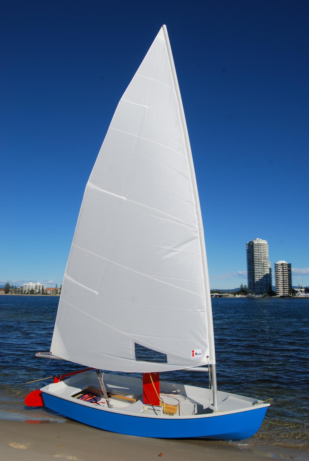

Designer Posted April 6, 2014 Report Share Posted April 6, 2014 The Spindrift uses a Laser style rig. We have made it so that it can reef. It takes less than 30 seconds and can be done from the helm. Quote Link to comment Share on other sites More sharing options...
Hirilonde Posted April 6, 2014 Report Share Posted April 6, 2014 I use Graham's sail, just like in the picture. It does take longer if you tie off the reef ties, but you can be safely reduced in sail that fast! Quote Link to comment Share on other sites More sharing options...
