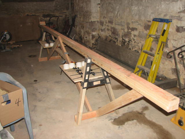

msaxton Posted March 10, 2014 Report Share Posted March 10, 2014 Once I got to the shop, I built the jig and just played with it a bit till I got the length and angle just right, 6 inch length in 3/4" stock ended up being about an 8 degree angle on the 12" mitre saw. glued up a sample scarf and looks good, will torture test it tomorrow. Got all my 1x2 cedar ripped today, just needs a little planing. Strongback built with shelves underneath, clamps all laid out and ready to go as soon as I get my ply and cut out the stations. oops, meant to post most of this on the nimrod build thread Quote Link to comment Share on other sites More sharing options...

msaxton Posted March 10, 2014 Report Share Posted March 10, 2014 You might notice on my jig that the inside corner is actually placed into the cutting path, and the corner is cut a little bit making the start of the scarf cut actually about 1" out from the fence. My reason for doing this was that the gap between the jig and the right side fence was wide enough that the stock would not be up against the fence at all. So I did it this way to keep the blade from pulling the board into it even though the board is clamped, just an extra safety measure. Quote Link to comment Share on other sites More sharing options...
