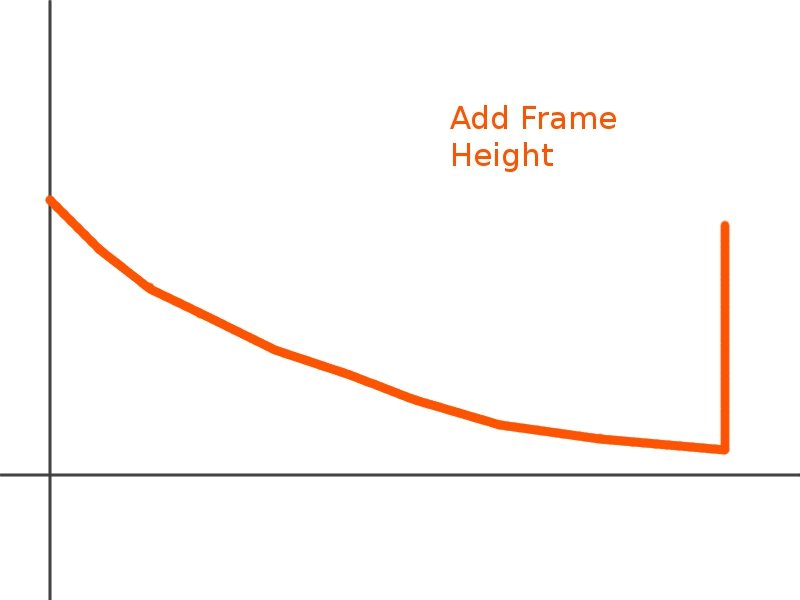

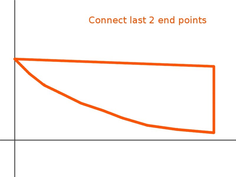

Sugarbaker Posted June 1, 2015 Report Share Posted June 1, 2015 Ok, So I have taken the time to loft up these coordinates in Sketchup (enough to refresh my memory of how I laid this out before). First photo is the bow, using the bottom of the fore-most frame section as the origin. What I would do, as Action Tiger has suggested would be to cut out the Bow and Stern (same alignment issue with the stern as seen in the second picture) and then adjust them to fit the frame during the build process. The shape will be correct. My feeling is when looking at the peak of the boat... the bow could easily be dropped the ~1/4" that the coordinates indicate and the profile of the boat would still maintain a flowing curve. The other thing to remember, is that you will be cutting a relief in the bow and stern where the keel extends into it. between this relief and the profile you can add to the keel when complete, you may not need to alter the position of the bow and stern at all. I agree though, that without some adaption during the build process, the coordinates may cause confusion. I will continue to work on this model in my spare time to see if I can illustrate my intention more clearly. Bow Stern Quote Link to comment Share on other sites More sharing options...

dorme Posted June 5, 2015 Report Share Posted June 5, 2015 Wow you guys! Thanks so much for the help. Your sketchup model looks great Sugabaker. I'll see if I can get somewhere similar and if I can't I'll just start cutting and make adjustments like action tiger suggested. I think that the mistake I made was to plot the bow/stem pieces on their own and squared off the last coordinate with the Y axis at a right angle. It looks to me like you made a curve down from the point to meet the deckline of the station, which if I'm interpreting that correctly, makes total sense. Thanks again for all of your input, I'll keep you all posted on the build and thank you Jeff for the plans! Quote Link to comment Share on other sites More sharing options...
