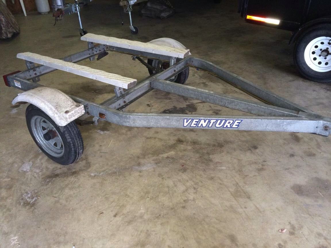

mattp Posted March 3, 2014 Author Report Share Posted March 3, 2014 Thanks for all of the helpful replies. I spent most of the day today driving to fetch my new to me trailer. It's pretty much what I have been looking for all along, I just had to broaden my craigslist horizons a little. Quote Link to comment Share on other sites More sharing options...

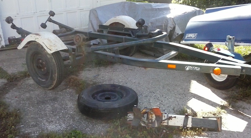

MattandTru Posted September 3, 2014 Report Share Posted September 3, 2014 So we somewhat impulsively bought this trailer. 200$ It is a "Calkins" with adjustable axle position, bunk roller positions and it is pretty heavy duty I think. Probably heavier than it needs to be. My question is, is there an optimum position for the axle relative to the boat position on the trailer? And will these roller rigs work well or should I alter them somehow? Plus the tongue is quite long and could be cut shorter to make the package more maneuverable. Good idea? Now all we need to do is build the boat!! More on that later. Quote Link to comment Share on other sites More sharing options...

David Hughes Posted September 4, 2014 Report Share Posted September 4, 2014 I to am looking for a replacement trailer. I bought a used CS20 and the trailer that came with it is way overkill for the boat. A badly set up trailer is no fun. Axle position with respect to the boat is critical to tongue weight. My trailer with boat on it had more than 500 lbs of tongue weight. I have since slide the boat back 2-1/2 feet which has helped tremendously. I also took the spare tire off the tongue. I "spoke" Graham on this and he was good with the aft end hanging off the bunks by as much as 3 feet. His recommendation was to focus on matching the weight rating of the trailer with the boat. He said that a trailer that is over rated for more then the boat is very hard on the boat. You want a soft ride. Some trailers you can move the axel position, some you can't; mine is welded. I suspect starting with the axel about 2/3rds of the way back from the bow would be a good starting point. You should have at least 100-200 lbs tongue weight. Most trailers are set up for a motor boat and they assume there will be a huge outboard on the back of the boat, consequently they set the axels far back to compensate for the weight of the motor. You might need to get a shorter trailer to get the axel position right depending on your boat. 8 versus 12-inch wheels. Well personally I think the 12-inch wheel thing is over rated. I had both. I had one trailer for over 15 years with 8 inch tires and put on many, many miles including many highway miles on it with absolutely no bearing or tire issues. When I replaced that trailer, the dealer talked me into 12-inch wheels and I wish he didn't. First thing I noticed was how much further I had to back into the water to launch the boat. Think about it, you have to get four inches deeper to launch. If you are on a shallow ramp, that could be a long way. All your weight should be on the keel, set the bucks out to hold the boat upright with very little weight on them. The bucks need to be positioned under the tanks such that there structural support. My thoughts, take them for what there worth. Good luck and let us know what you end up with. David Hughes Quote Link to comment Share on other sites More sharing options...
PAR Posted September 4, 2014 Report Share Posted September 4, 2014 The wheel diameter thing is important, but not for the reasons most think. Larger wheels tow better, but bearing life isn't really affected by smaller diameters, mostly because the hubs are all the same. Basically, the trailers we use for these boats will have 1" or 1.25" bearings. 8" and 12" tires use 1" bearings and they're rated for way over what these little boats will impose on them. Keep them clean and greased and they'll easily outlive you. Smaller wheels have the advantage of getting the bottom wet faster, though the way the boat is set on the trailer can help a lot. Larger wheels back up a lot better than smaller wheels, but there's a very limited amount of time in reverse, so not as big a concern as say on an 18 wheeler. Lastly always use trailer, not passenger car tires. They're built differently and can take more weight. The side walls don't flex as much and it'll tow better with trailer tires as a result. Quote Link to comment Share on other sites More sharing options...
MattandTru Posted September 4, 2014 Report Share Posted September 4, 2014 Thanks David, That is a good map for me. So with a CS17, I could have the axle at about 11 ft from the bow and about 3 feet of support aft of the axle, with about 3 feet of aft end sticking out behind. Plus about 2 feet of tongue forward of the bow to the ball. Does that sound about right? -Matt Quote Link to comment Share on other sites More sharing options...
David Hughes Posted September 5, 2014 Report Share Posted September 5, 2014 Glad I could help. I just reread Par's Feb 2014 comment on this topic and it is inline with mine. His first comment is matching the springs to the weight of the boat. His post is worth a reread if you get a chance. He also suggest the axle location just aft of midship. So on a 17 foot boat that puts your axle somewhere between 9 (per Par) and 11 feet (per me) from the bow. I think it would be ideal to be able to fine tune the axle location within those parameters. Remember that not only can you move the axle, but you can also move the bow stanchion where the winch is mounted which would also change the position of the axle with regard to the boat. Ideally, I would want a trailer to fully fit the boat, bow chock to end of trailer being 17 feet in your case. This helps protect the boat from life's little mishaps in the parking lot and driveways versus having its ass end fully exposed. But sometimes with life we have to make compromises and will have to hang our arses out a couple of feet. Best of luck and again keep us informed. By the way, I think it is great that you are doing this with your son. I have found memories of working with my Dad as a kid that I will always cherish. I also learned a lot. Dave Quote Link to comment Share on other sites More sharing options...
