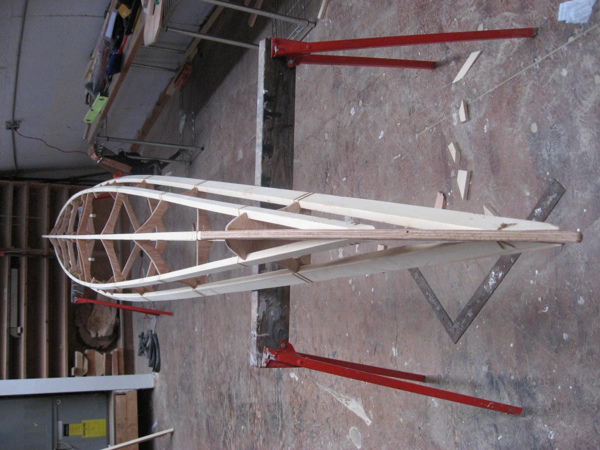

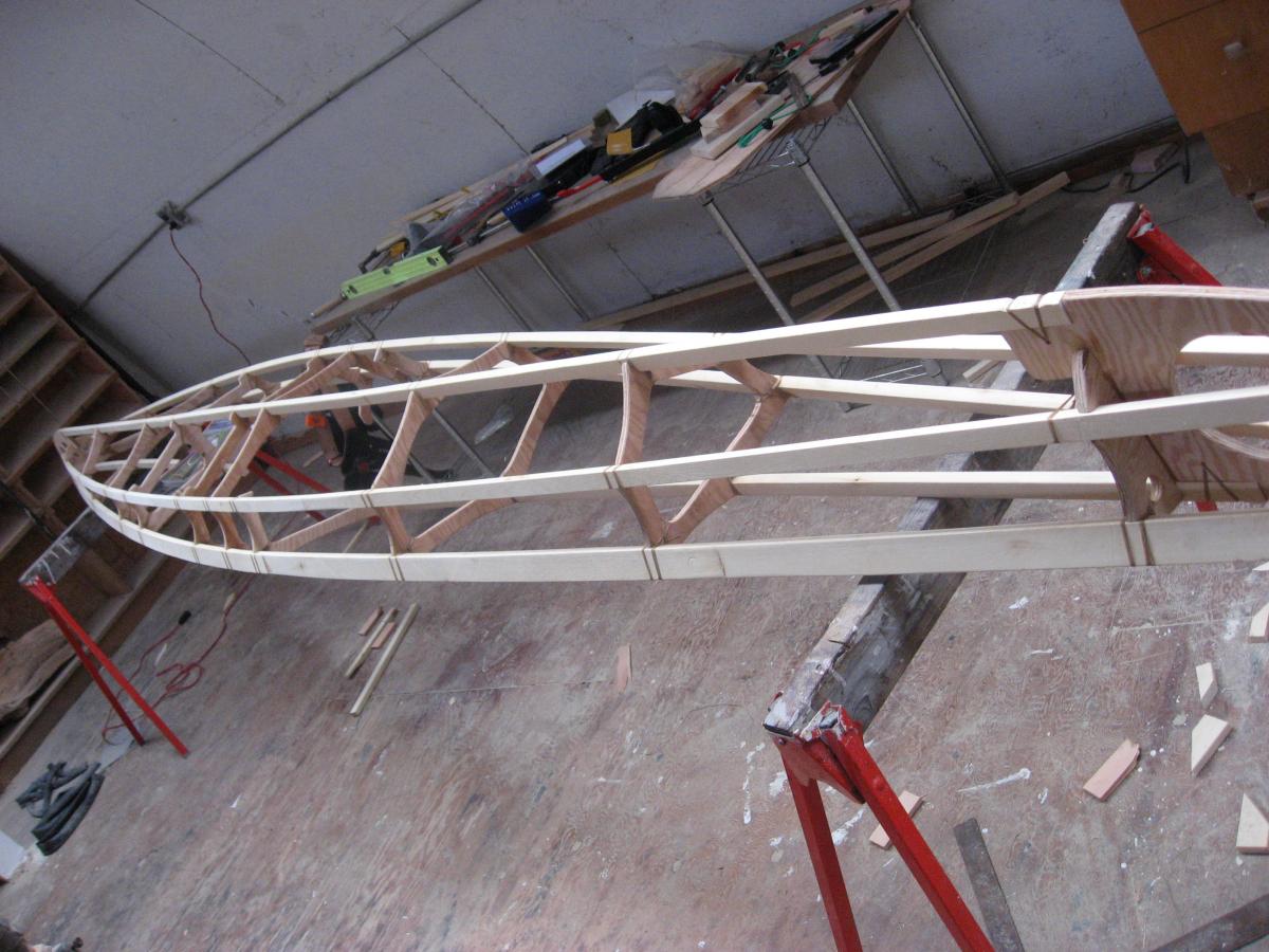

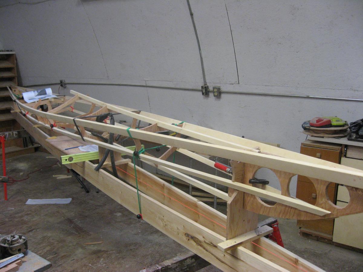

Mr Gingerbread Posted March 25, 2014 Author Report Share Posted March 25, 2014 Laying up the frame, hope to get started on the lashing tonight. Skin ordered 11.6 oz poly. I'll play with skin on my next SoF Kayak. Tested some of the scarf joints and they don't want to break. gota keep working. Quote Link to comment Share on other sites More sharing options...
Mr Gingerbread Posted March 26, 2014 Author Report Share Posted March 26, 2014 "The lashings will continue until integrity improves" Burned some midnight oil but have the frame lashed together. Next up is getting the seat, hatch and foot rests installed into the frame. Need to find some DuraTuff as well. Might be away from it for a bit as I'm house sitting up island again. -Peace Quote Link to comment Share on other sites More sharing options...

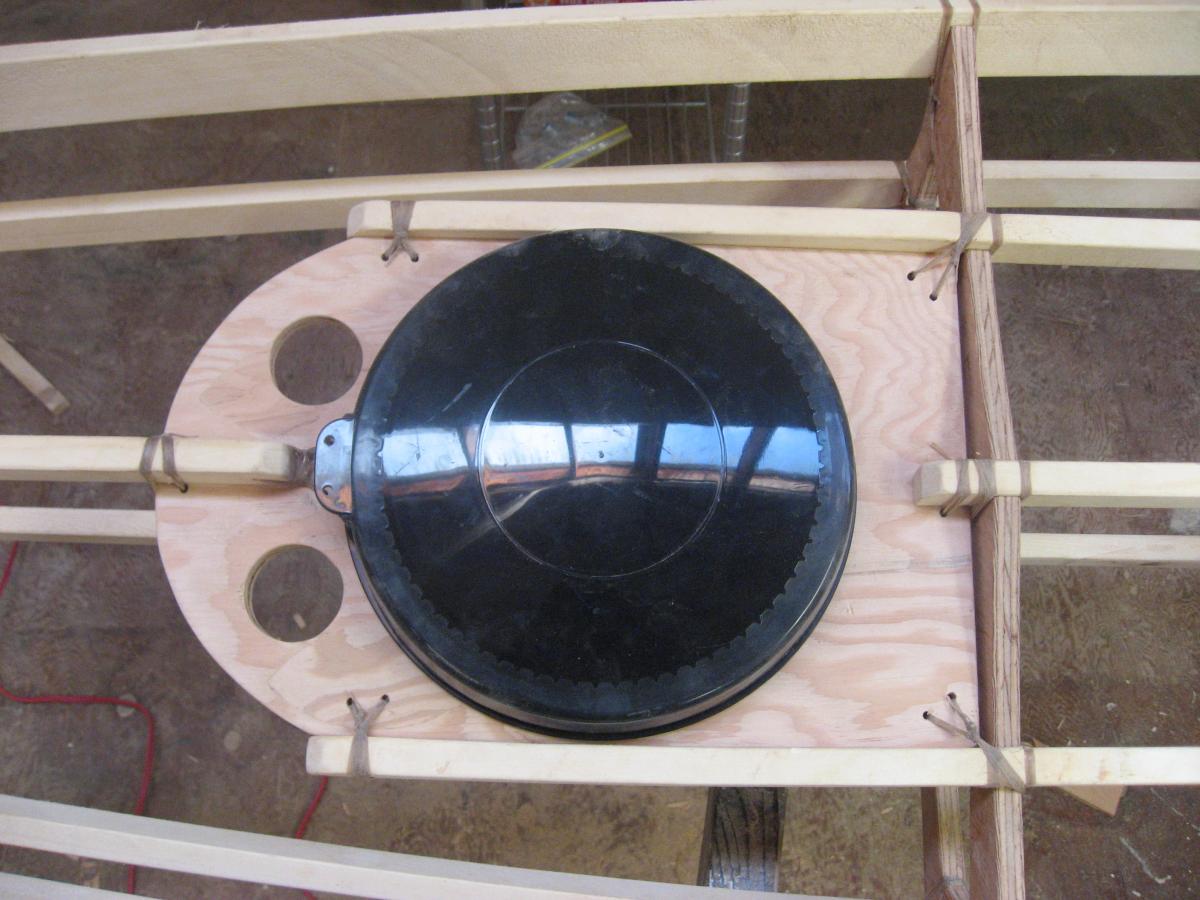

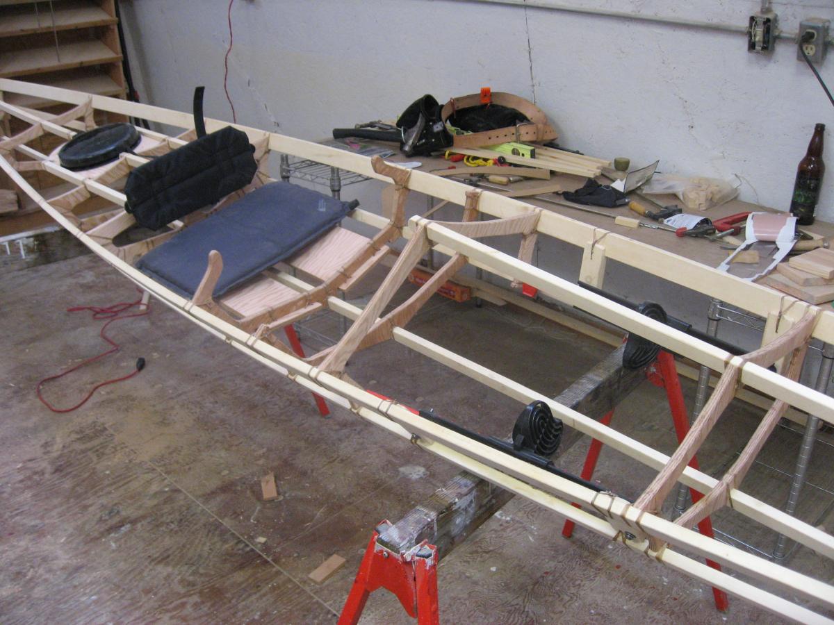

Mr Gingerbread Posted April 2, 2014 Author Report Share Posted April 2, 2014 Spent the last few days fitting the hardware (seat, hatch, pegs) to kayak (or would this be considered a kayak-yak?). Next to do after double checking all the work so far is to oil, then re-attach hardware test float with plastic wrap and then skin. Looking for a second opinion on my hatch set up. The back hatch plate feels solid but play devils advocate for me. Quote Link to comment Share on other sites More sharing options...
msaxton Posted April 2, 2014 Report Share Posted April 2, 2014 I kinda like that hatch set up! Build is looking great! Quote Link to comment Share on other sites More sharing options...
Hirilonde Posted April 2, 2014 Report Share Posted April 2, 2014 I don't see any issues with the hatch base in the frame. It is secured in place and provides material to sandwich the skin to and hold fasteners. ................. test float with plastic wrap ............... What are you testing for? Quote Link to comment Share on other sites More sharing options...
Mr Gingerbread Posted April 2, 2014 Author Report Share Posted April 2, 2014 Testing for a bit of everything. Make sure the foot pegs are mounted high/low enough. I did sit in it on land but with a temporary skin I'll know for sure. See if the hatch placement effects the stability of the structure of the back deck any. make sure the frame stays straight under load and in the water. Heck for fun if nothing else. Nice to make sure everything is good to go before I put on the skin which is the most expensive part of the boat (will be about ~$250 for the skin (including polyurethane)(shipping is a killer). Quote Link to comment Share on other sites More sharing options...

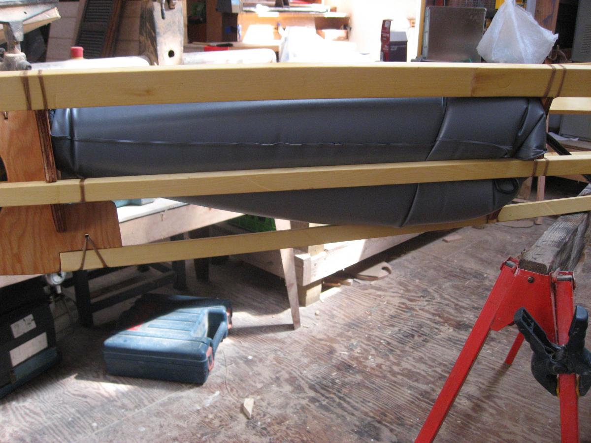

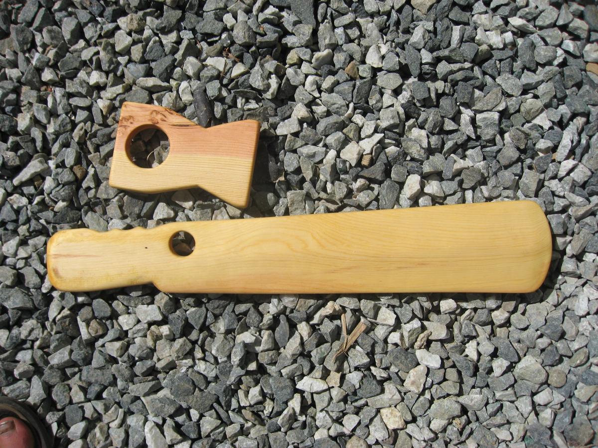

Mr Gingerbread Posted April 9, 2014 Author Report Share Posted April 9, 2014 Watching boiled linseed oil dry... Oiled the frame a few days ago and just letting it sit. Given up on finding duratuff and will just go with a basic exterior pain when skinning begins. Been fitting/modding in some float bags (stern fits great, bow fits ok). Made a Norsaq out of some wood Iaying in the corner (Followed http://seakayaking-stuart.blogspot.ca/2011/11/building-norsaq.html as a guide). Another block got turned into a hand line rig. Also been cutting out some deck line toggles from some salvaged hardwood flooring. All in all, small jobs here and there and nothing "epic". Oh I did order a sea sock from black dog kayaks so hope to get it soon. Quote Link to comment Share on other sites More sharing options...
