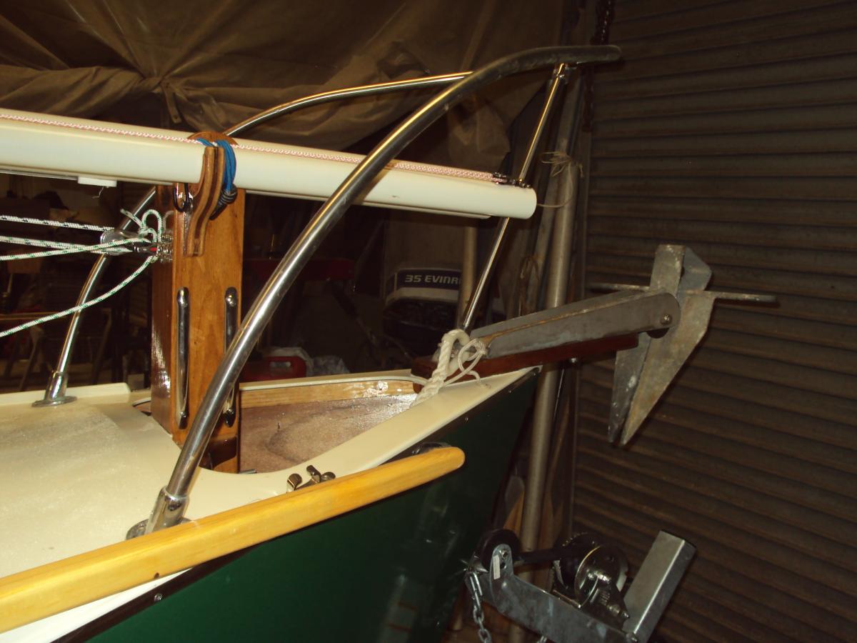

ecgossett Posted June 18, 2015 Report Share Posted June 18, 2015 Doug, Can you please post photos of how you are anchoring the boat, and closeups of the anchor line, and talk about how easy it is to rig, and how the boat feels at anchor? Also, do you have any photos of some of the stuff like kitchenette (sink, etc), or how you mounted the stove? Quote Link to comment Share on other sites More sharing options...
Doug Cameron Posted June 25, 2015 Report Share Posted June 25, 2015 I'm working at camp in North Carolina, so can't send pics. The line goes through a fairlead on the bow, then past the tabernacle (with a stainless rub strake to keep from chafe) to a reinforced cleat aft of the forward bulkhead. I did not feel that the forward edge of the bow was strong enough. The boat moved around a bit at anchor the one night I spent on anchor. I need to play around with having the rudder and centerboard up and down and maybe a reefed mizzen out. The stove is mounted on the aft cabin bulkhead so as to swing free and allow steam to escape. The stove can be seen partway down on this page http://www.duckworksmagazine.com/12/howto/stoves/index2.html. It's the one on the left with the Coleman gas tank hanging below. 1 Quote Link to comment Share on other sites More sharing options...
Chick Ludwig Posted June 25, 2015 Report Share Posted June 25, 2015 Edward. Here's my anchor on my CS-20 Mk-2. I'll be doing the same thing on my CS-17 Mk-3. It works well and is easy to use. The anchor rode drops into the mast tabernacle "well". The boat does sail back and forth at anchor. Most small, light boats do. The cleat is behind the tabernacle on the fore deck. I also had SS strips on the tabernacle. 1 Quote Link to comment Share on other sites More sharing options...
