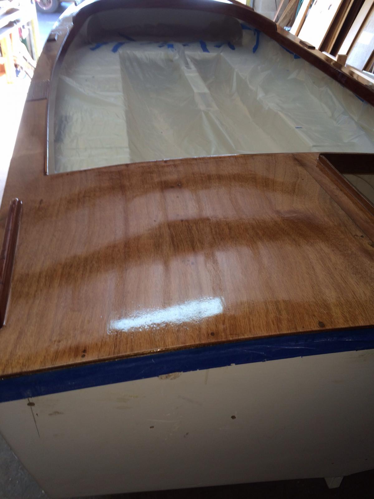

LennieG Posted March 2, 2015 Author Report Share Posted March 2, 2015 I put three coats of epoxy per Graham's recommendation, and I had to sand between each coat because I had out gassing. Even tho the outside temp was decreasing, my tin box storage hadn't gotten the word. Grahams intent was the same as Paul said.......for waterproofing. Graham put it this way: picture an ant crawling around the boat. He likes to make sure that the ant will not touch bare wood anywhere. I seem to be getting a fine smooth finish except for the things landing on the boat at tacKy time . I plan to almost Fully close the door today for coats 4&5 and see if that helps. Quote Link to comment Share on other sites More sharing options...

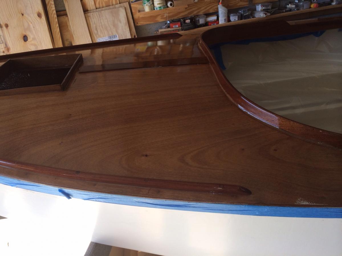

LennieG Posted March 5, 2015 Author Report Share Posted March 5, 2015 Thanks Dale. I needed to buy another quart of varnish today and went with the captains for the sake of the quicker recoat time, and the compatibility is apparently fine. Like how it goes on versus the epifanes. 5 down 5 coats o go. I know the purists and experts suggest 12 coats but I want to make the Cayo Costa trip. Quote Link to comment Share on other sites More sharing options...
LennieG Posted March 6, 2015 Author Report Share Posted March 6, 2015 Paul and others- I am within a few days of needing to clean up the hull. I have no visions of removing brush marks but would like to clean up various drips including epoxy, varnish etc that have collected over the Interlux enamel. Do you recommend I compound it or buff it with a polish? Sanding seems a bit aggressive but I am open to ideas. Also, is polishing of some sort called for on varnish if there are imperfections I want to clean up? Thanks Those brush strokes look moderately deep, so you might have some success, knocking them down with a buffer and cutting compound first, then move on to a polish. You might want to look into the 3M Perfect-It paint finishing system. It replaces the compounds with abrasive pads and a final polish goo. Basically using a buffer, you knock down the surface with progressivly finer grits, then use the finishing polish (I think it's actually a glaze). These pads tend to not follow the surface as much as a buffer wool, so only the highs come off at first, which is ideal fro brush marks. Of course, you have to be careful what you wish for, as the finely finished surface will show every fairing imperfection, as well as having removed the brush strokes. This is especially true of darker colors, like yours. Quote Link to comment Share on other sites More sharing options...
Hirilonde Posted March 6, 2015 Report Share Posted March 6, 2015 I don't know that the use of several products saved any time or came out better than just Captain's. I will be using just Captains over spars, tiller, rub rail and such and Captain's over epoxy where plywood is concerned. Either way, that deck/coaming picture looks great. Quote Link to comment Share on other sites More sharing options...

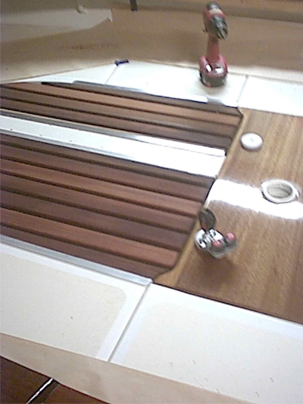

PAR Posted March 6, 2015 Report Share Posted March 6, 2015 Agreed a scraper is a good way to remove a wayward drip, but be careful, it's easy to gouge surrounding areas if you get aggressive or try going too fast. I generally try to cover finished areas, when working around the finished area. I have a boat right now I'm doing that has heavy craft paper taped around the rub rail area, cover the hull to the shop floor. This prevents drips from getting on stuff and keeps the hull clean from splatter. The same would be true if working in the deck, combings, etc., I'll tape off and mask areas to keep them clean. A multi tool sander tip, can get a drip down to a manageable size, before moving onto a scraper. Â Â A classic example, the nice two tone cockpit seating paint job, has a protective paper on it to prevent drips and debris from the combing install above, from making more work for me. Quote Link to comment Share on other sites More sharing options...
LennieG Posted March 7, 2015 Author Report Share Posted March 7, 2015 Got it guys. Thanks for input and couldn't agree more....next time I will cover up all up.i would have thought I would have known better. Thanks Quote Link to comment Share on other sites More sharing options...
PAR Posted March 7, 2015 Report Share Posted March 7, 2015 If you look closely at the lousy image I posted, you can see debris on the paper I put down, where I shaved off some drips or something. I get rolls of this stuff which is cheap and fairly heavy, plus doesn't let paint or goo wick/bleed through, assuming you bother to check it occasionally. On things I want absolute insurance, I buy cheap painter drop cloth plastic sheeting. This stuff drapes better than paper and will dead stop a drop of goo or paint, though generally isn't as tough as paper. Quote Link to comment Share on other sites More sharing options...
