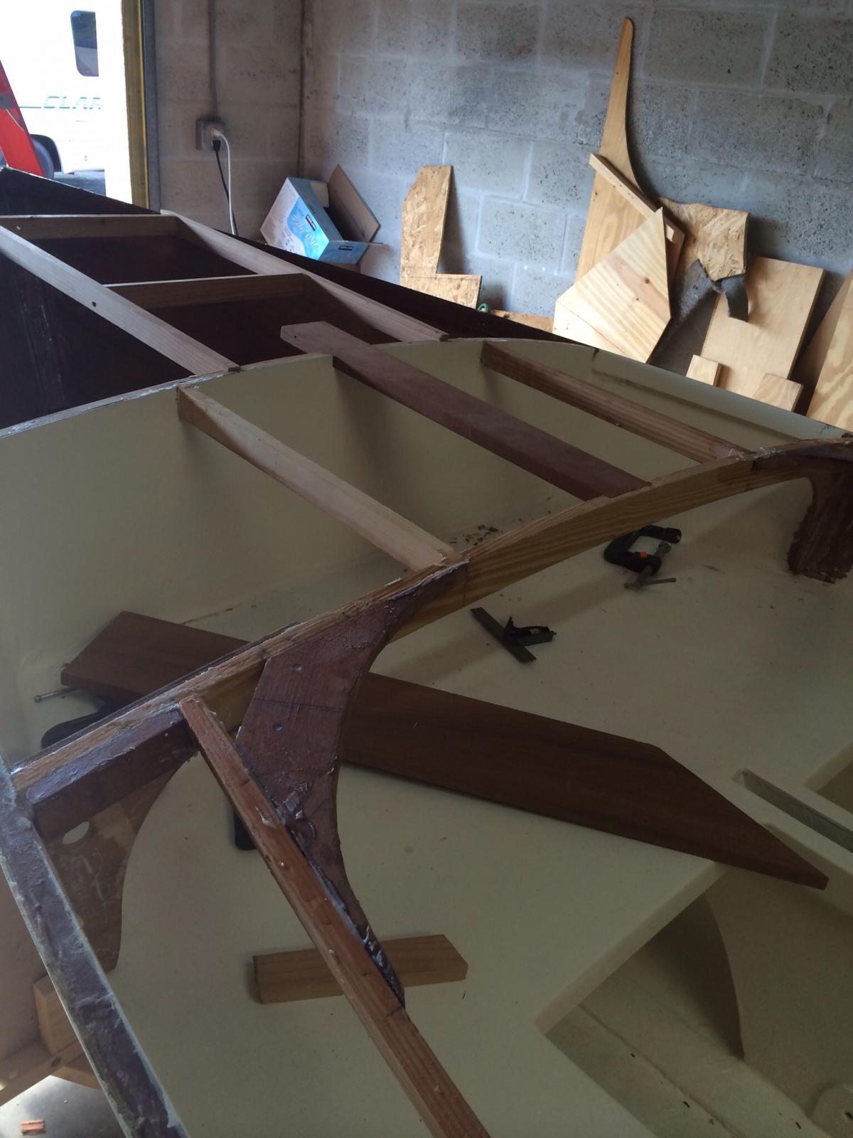

I asked myself the same question, but figured that it would be easier to see the dirt and grime on the white paint.  I used Interlux Bilgecoat for these areas.  Wow, does this stuff smell to high heavens.  The whole house stinks as well even with the garage not really being attached!  The Bilgecoat is supposedly good to use on areas that may get oil/gasoline on them.  Anyways, it was way cheaper than the Waterbased LPU is used on the exterior.  But, not a low VOC paint.
Prior to painting, I did sand out the sharp edges of epoxy so that no hands will get hurt or gear damaged moving around in the lockers.

Thanks guys. Did you/are you adding a plywood shelf in the foreward compartment aft of the mast? I had never considered it but I went to a class with Graham last Thursday night and one of his students was doing that and it looked nice. It would be to lay the anchor on and built so that with the correct angle you could just barely remove it from the hatch to access bottom.
Nice idea but I prefer to sail in this lifetime, and my leftover ply supply is low.

I am going to paint every thing inside the boat  after a couple three coats of epoxy  In fact I have coated all the deck pieces on the under side a long time ago I just set them out mixed some stuff and rolled them  I have taken all the braces  knees and done them all the pieces that fit on the bow that support the deck or forward mast.  When I had long strips of glass to wet in the hull I took a plastic box lid and wet them in it put in boat and pulled it out as I put it on inside hull
