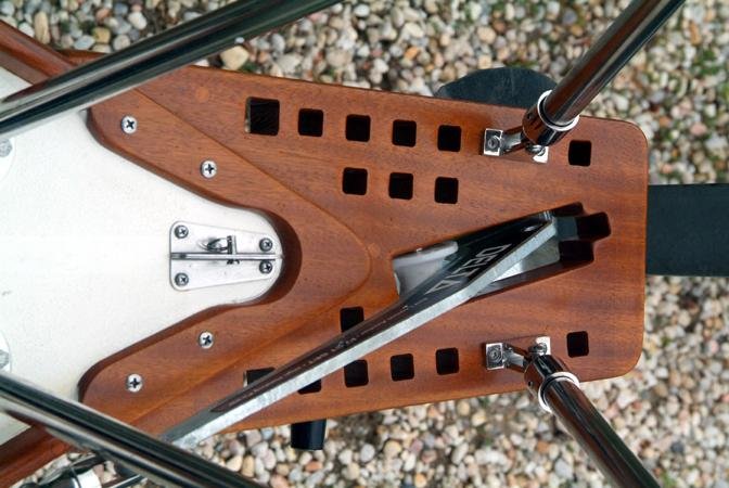

At some point you do cross the threshold where having an anchor an anchor at the ready on the bow makes sense (vs. having it stowed below). It may be a matter of how its used vs. size of boat. The attached picture is of a really nice anchor setup a guy built for a Montgomery 15. That might be a 9# Delta, which is what I have for my Montgomery 17. That whole setup would seem to be overkill for a boat of that size. Nice though.......very nice. I have experienced the same thing bringing my anchor up on the M17.........trying to hold the chain and anchor far enough away from the topsides to keep the mud off and the metal from dinging up the topsides. Getting it out is not the issue. Getting it in is.
What is also lost in the discussion is what Paul and Tom were alluding to and that is the wisdom of hanging that much weight that high up on a small boat and in the ends. On sailing boats of this size, the weight is much better off in the bottom of the boat and as close to amidships as you can get it. It's not until you get a boat with some size on it and one that is being cruised and anchored a lot that having an anchor sprit mounted up there pays off. Of course a 4# Danforth is not as big an issue as a 30# CQR would be.
I've also heard that 22# is about as much anchor as the average man can horse aboard without the benefit of a windlass. It's not just the weight of the anchor, but it may also include the chain rode and maybe 50# of mud. So if the anchor is properly sized to the boat, somewhere around 30' is the length limit for boats that do not have a windlass.
