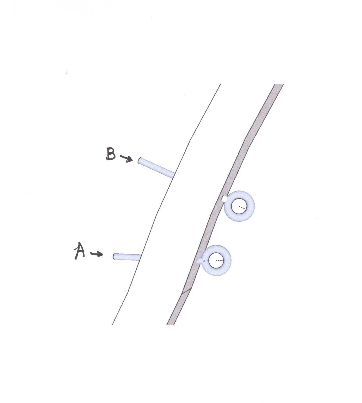

This is a crude representation of two ways to install a bow eye bolt.
"B" has the hole drilled perpendicular to the grain of the stem.  While (in my situation) it would be the easiest way to do this, I am concerned that the winch force, not being parallel to the axis of the bolt would put more stress on the borehole wall as well as the bolt itself and more likely to eventually lead to leaks and/or breaking the bolt.
While "A" has the hole drilled more nearly parallel to the keel and may be a little more difficult to do, the winch force should be mostly against the backing washer resulting in less stress on the seal between the bolt  and the borehole wall.
Does this matter?
Any comments on this or any other aspect regarding installing the eye bolt such as type of sealant and how to apply it are welcome.

Chick, I agree that the U bolt would seem to be a better option.  However the question I posed above remains.  (The eye bolt was easier to draw. :))
It seems to me that parallel to the keel is better for the reason I mentioned above and even more difficult to drill two holes parallel to the keel.
I also understood that 316 SS was usually used in marine applications.  I'm sure that West Marine knows what they're doing and the 6 inches of  threads on the longest of the three u bolts that the link Chick provides brings up would be long enough to penetrate the 3" deep stem at up to a 45 deg angle to the axis, that is the direction of the wood grain.
I hope this makes some sense...................

Hi Fishman38
As I see it the bow eye needs to accept force in more than one plane. For example it needs to accept the winch force when first being pulled onto the trailer...this is usually with the bow being lifted up high until the trailer can tilt (if a tilting trailer) or until enough of the boat is pulled onto the trailer to line up the boat with the winch line. Also it might be used for towing at some stage with commensurate side forces. I follow the view that it needs a big enough U bolt set into enough timber and backing plate that any foreseeable pull will not result in failure.  Also drilling bigger holes and filling them with high strength epoxy/filler and redrilling to the right size is a good idea as the timber is not subjected to the forces directly and is extremely well sealed from moisture. I usually finally seal with Sikaflex as it remains flexible and is very durable.

I think you may be over-thinking the structural issue, the strength is more dependent on the depth and thickness of the wood.
Drill the holes perpendicular at 90 degrees or you will not have a good seat for the backing plate and have a much harder time sealing the joint. The suggestion to over drill and fill with epoxy is right on the money.
I would suggest using a u-bolt with a backing plate on each side.

Belt and suspenders technique: use  a fitted backing plate which is shaped to the interior of the stem. This adds some "meat" to your backer and as suggested above means you will have strength in almost any direction. This is just a piece of Purple heart saturated in epoxy.

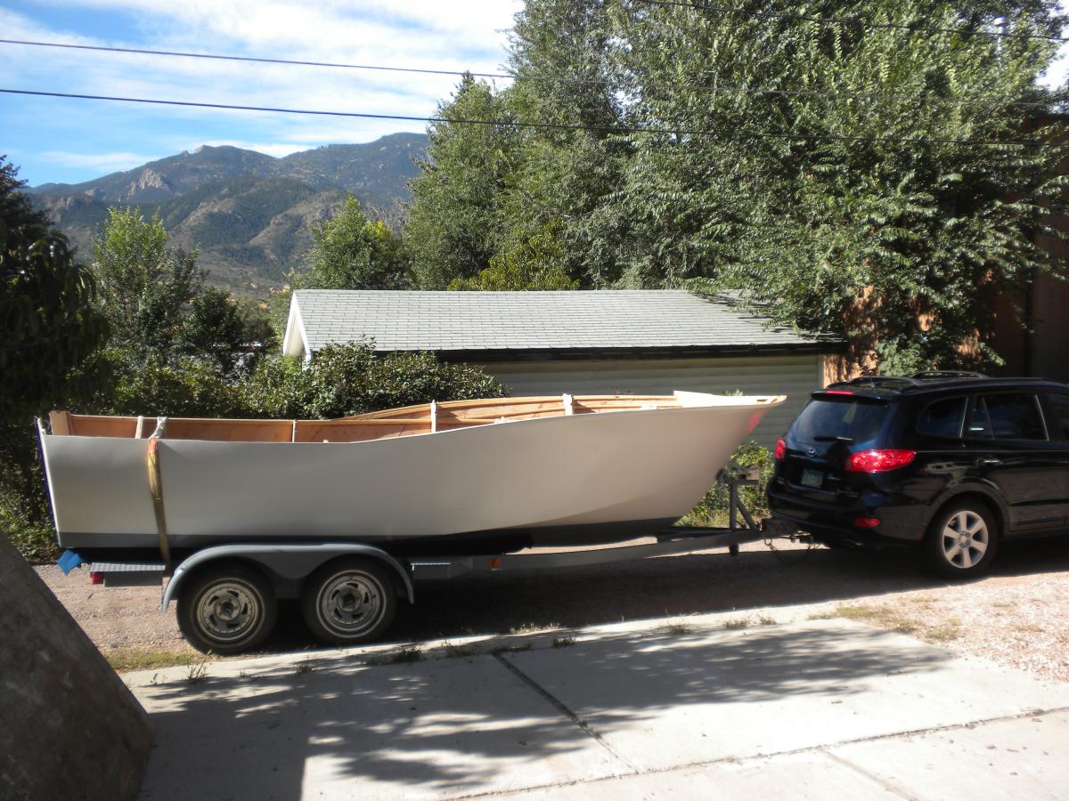

Most (read all) of the work on the project lately has been on necessary mods to the used trailer I bought for $500 and to date have spent upwards of another $1G on sandblasting, painting, welding etc and probably a new set of wheels and tires before I'm done.  I think the end result is going to be better than anything I could have bought new under $3G.
Below is latest pic of the combo just back from the welding shop.  My wife's AWD Hyundai works better maneuvering this rig in and out of close quarters.............

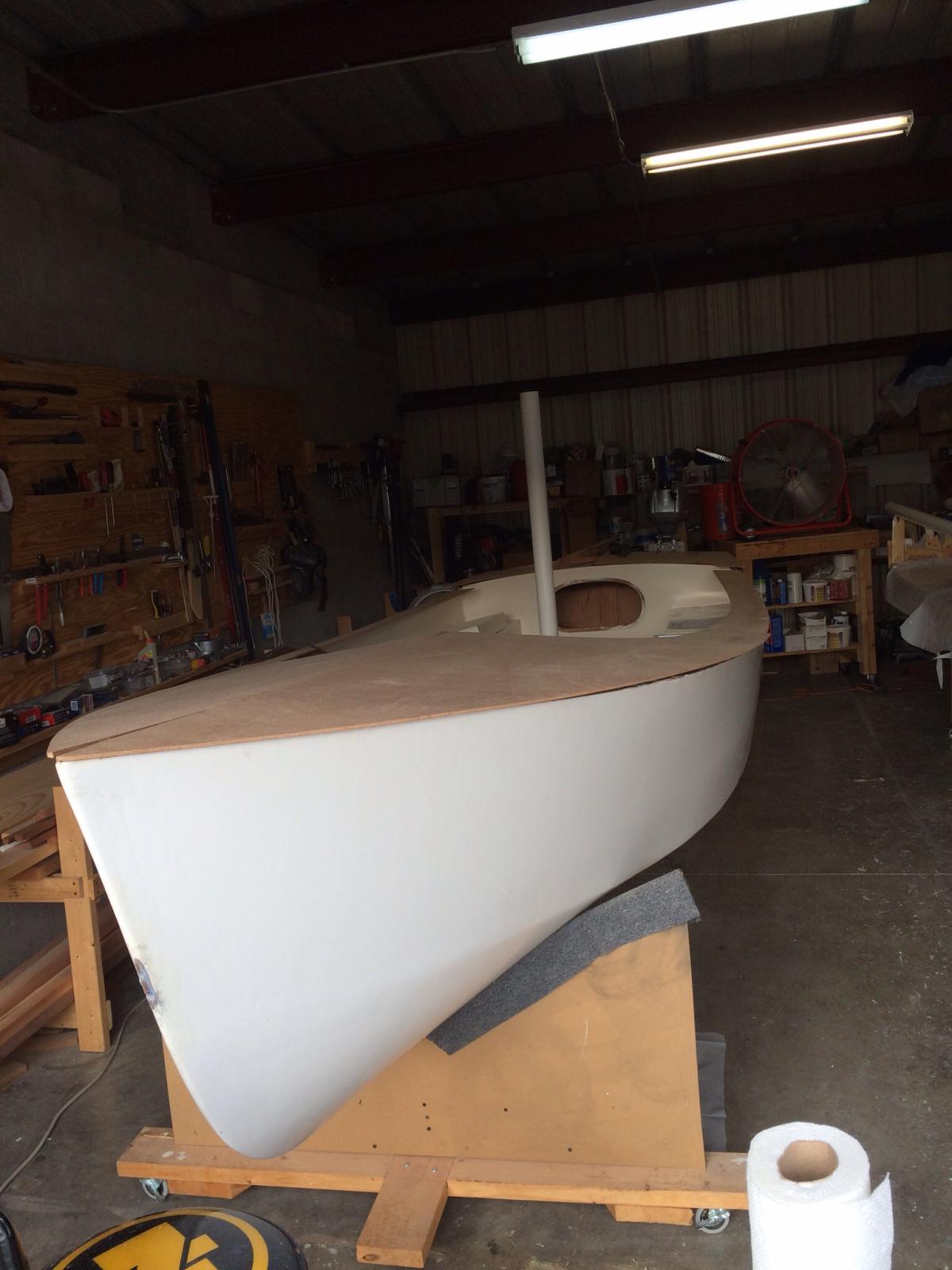

Back to working on jus' 'cause after spending a couple of months catching up on long neglected domestic chores.
Left to right to bottom:
1. Got her right side up and on the trailer mid August.
2. Some mods required to fit the used trailer to the boat.

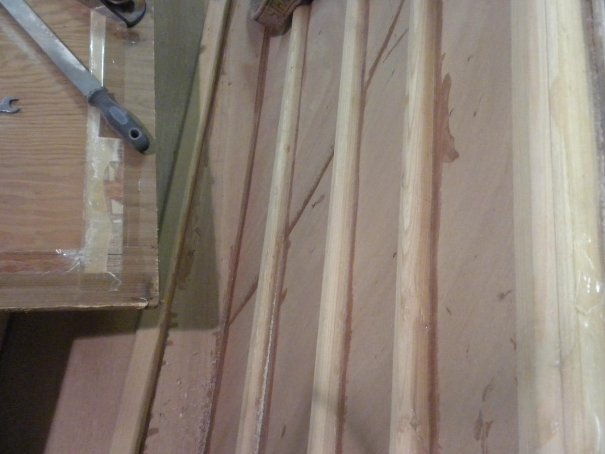

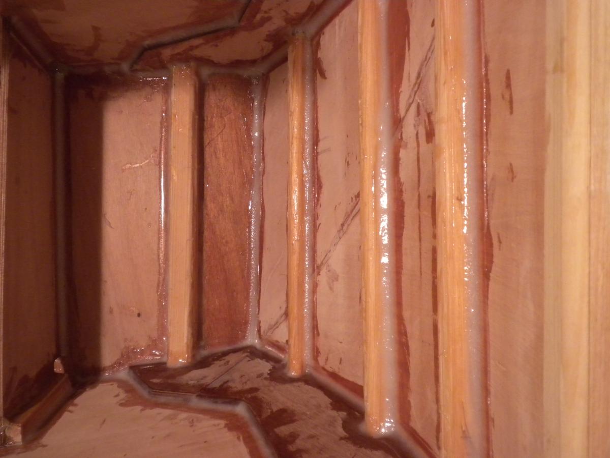

3. Getting ready to lay in the 1/2" radius fillets.  Assumed I needed to rough up(sand, wire brush, whatever method I could come up with to reach the surfaces that needed reaching) the cured epoxy that the fillets would be adhering to. No easy chore doing this inside the engine well.
4. Used B&B epoxy thickened with West Marine #406 colloidal silica for the fillets.  This pic is looking down into the engine well.  Very close quarters.  I tried several methods of laying in the fillets including West's fillable tubes with a regular caulking gun.  What worked best?  Cake icing bags, from Wal-mart or Hobby Lobby not sure which, $5 or $6 I think.

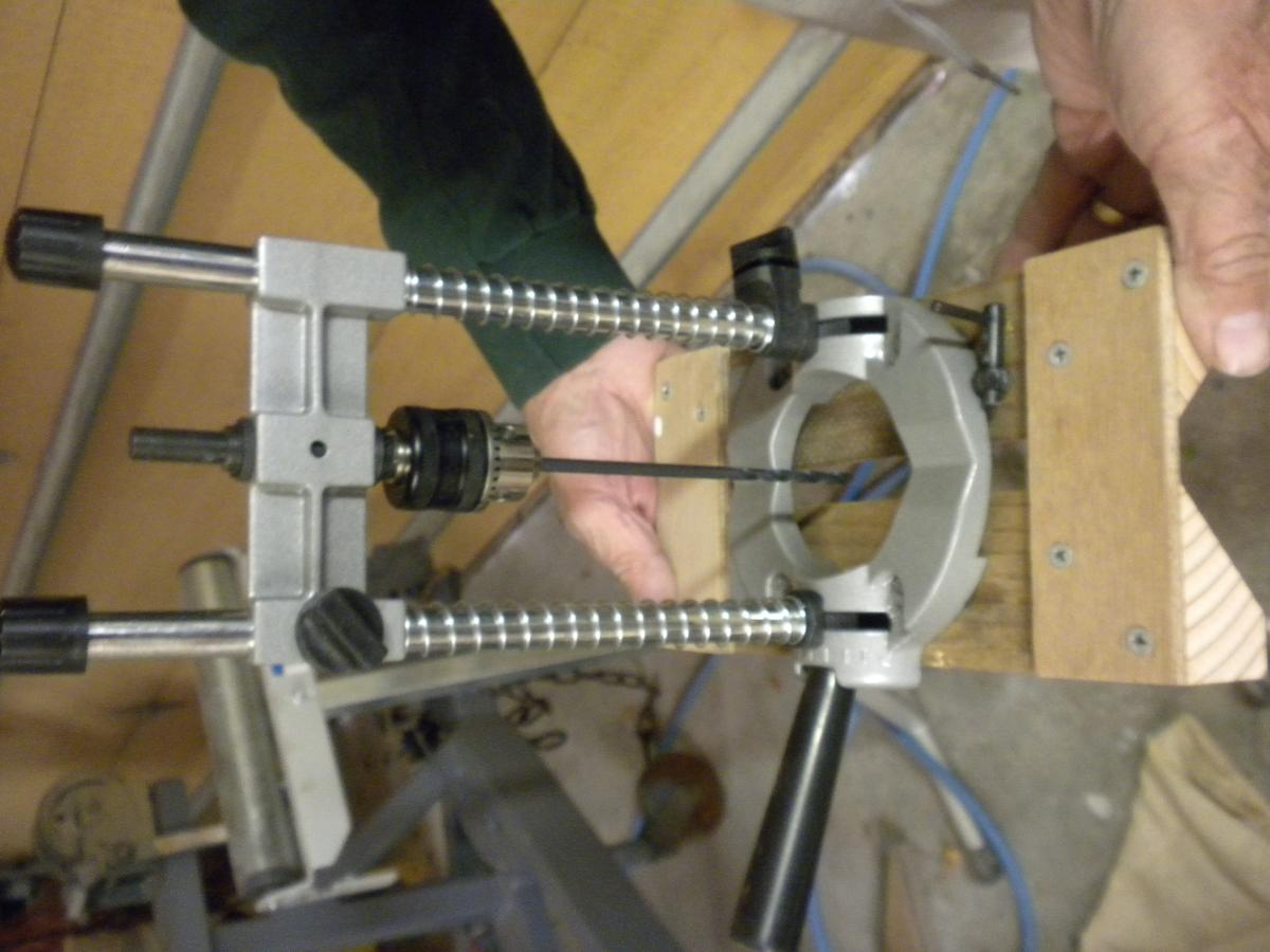

5.&6. This is a drill guide, $30 from Sears, fitted with a jig to match the shape of the stem for drilling holes for the U-bolt to be mounted in the bow.  I have zero confidence in my ability to drill freehand two parallel end to end  3 1/4 inch holes through the curved stem.  Maybe with this device and the help of  my son. I can get close enough.  Still trying to figure out how  to, once the epoxy has cured in the oversized holes, re-drill it to the size of the bolt and keep the bit in the epoxy.  I'm hoping the epoxy will drill easier than the pine wood making the bit tend to follow it.

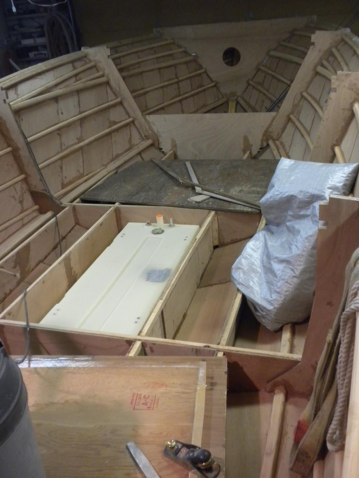

7. Another shot into the engine well.  This is where two bilge pumps will be installed.
8. And another.  I found a small sand blaster at Harbor Freight that I think will work to abrade these glazed fillet surfaces to facilitate adhesion of the layer(s) of fiberglass which go on next.
9. Lots of prepping and filleting yet to be done.

Fishman-
All looking good! I found the drilling For the bow eyes straight forward and there was no need for jigs etc. I started with a much smaller drill size just to confirm position accurateness , and then went progressively bigger, checking for distance between the two screws, alignment, angle etc. I then filled in with thickened epoxy, covered both sides with shipping tape, after shrinkage added more epoxy next day. I went up to 1/2" drill bit as I recall, which was a bit bigger than my stem width butt with some flattening and shaping all worked out well it appears. Next I drilled the correct size hole thru the epoxy, using marks from the SS backing plate.
