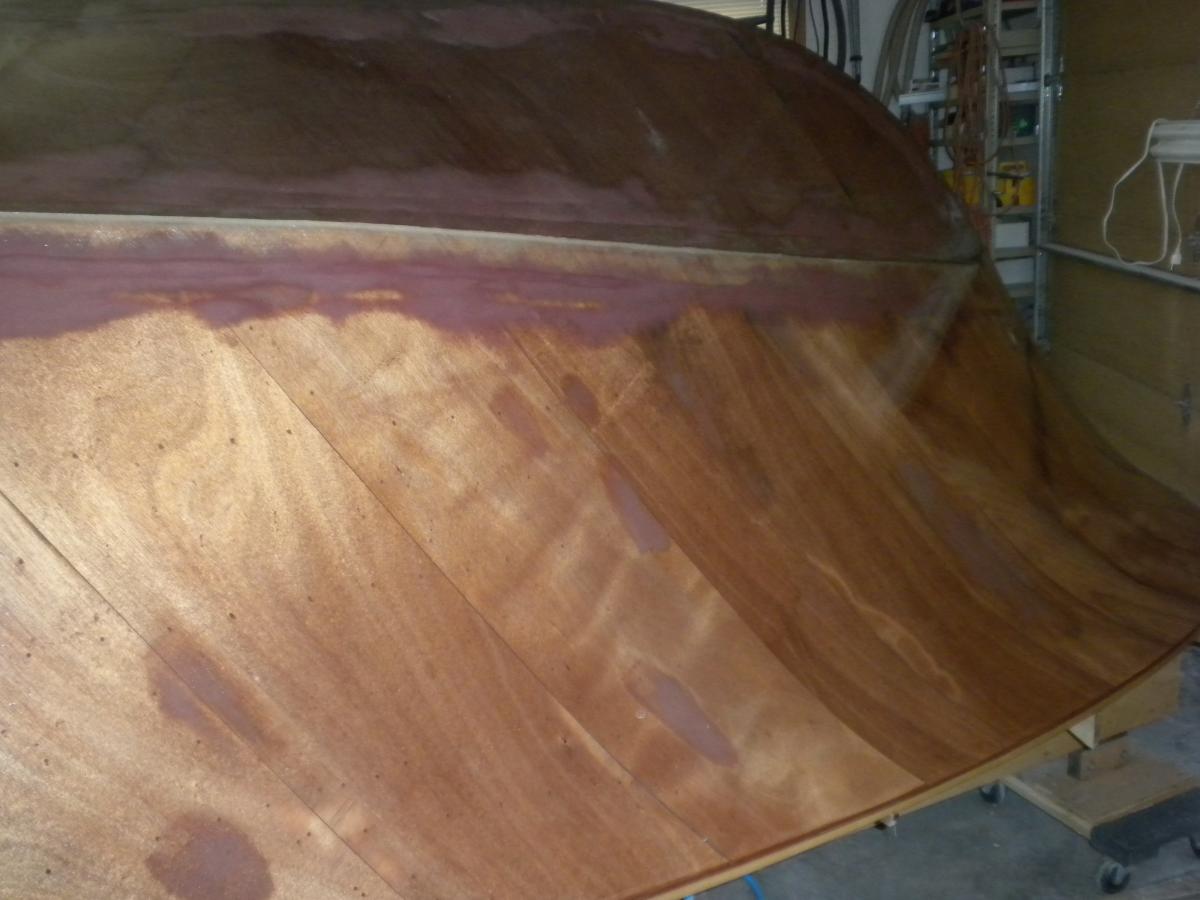

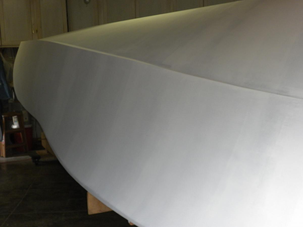

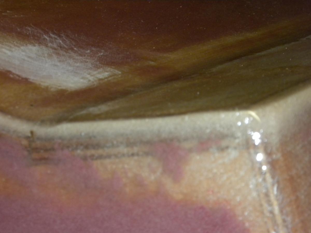

Fishman38 Posted May 14, 2014 Author Report Share Posted May 14, 2014 After a little filling and sanding, this is how the chine turned out. Except for a couple more hours of sanding I think she's finally ready for some paint. Quote Link to comment Share on other sites More sharing options...

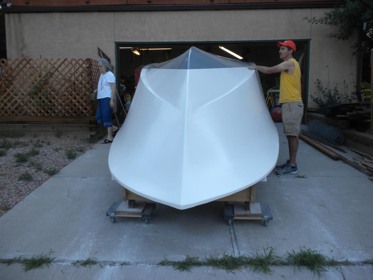

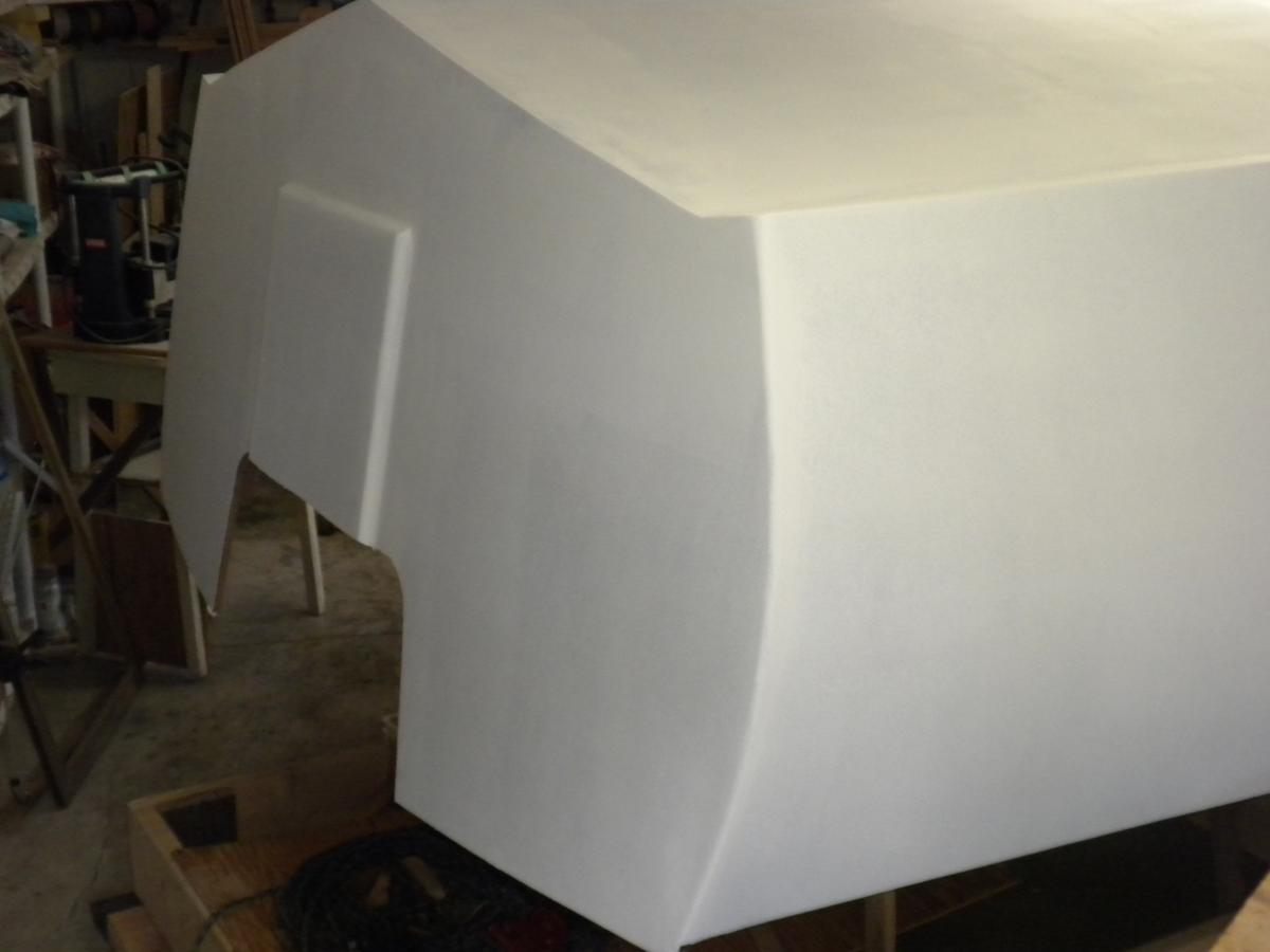

Fishman38 Posted May 28, 2014 Author Report Share Posted May 28, 2014 First coat of primer, rolled on. Believe I'll switch to airless sprayer for next coat. Quote Link to comment Share on other sites More sharing options...
Fishman38 Posted May 30, 2014 Author Report Share Posted May 30, 2014 Some sanding and another coat of primer later: Quote Link to comment Share on other sites More sharing options...

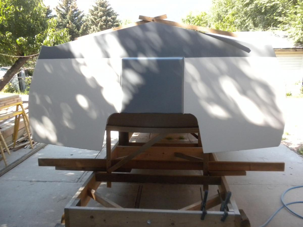

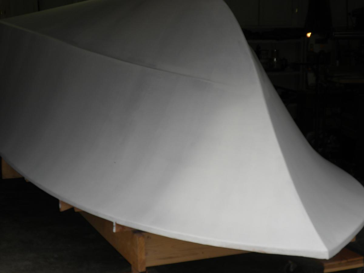

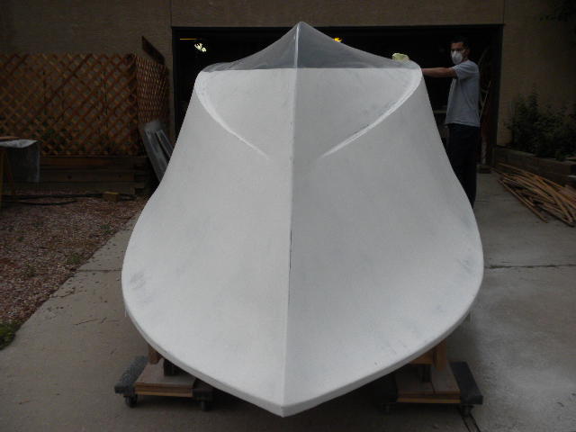

Fishman38 Posted June 24, 2014 Author Report Share Posted June 24, 2014 Been struggling to learn how to (spray) paint, using a new Central Pneumatic, HVLP gun. Couldn't get the gloss finish I expected 'til coat number four. Problem seemed to be pressure too low, resulting in not enough paint. Jacked psi to 60, 10 psi over gun rating problem solved I think. Added coat no.5 for good measure. I'm talking about the bottom gray. The white is still one coat of white primer. Hope the couple of pics upload. Reduced the size to smallest possible. We'll see. .........................seems to have worked. I'll try to find an optimum size that works........later. .................Still later: Resized the pics to 49.7 kb (640x480) which seems to be a nice size for the purpose. Guess one should occasionally reread the rules: "Max. single file size:2MB" Had not noticed this before and in the normal mode my camera makes (about) 2.5 MB pics. ..............Ooops. Looks like I posted the same picture twice. Maybe this is better. Quote Link to comment Share on other sites More sharing options...

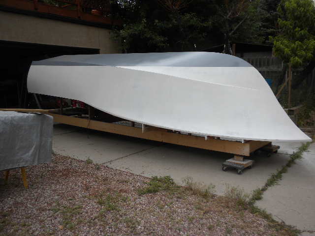

Fishman38 Posted July 25, 2014 Author Report Share Posted July 25, 2014 Sorry guys, I've been sort of stalled out in the painting process plus a 10 day sabbatical for a fishing trip. Since returning have been prepping for one more -final I hope-coat which will go on today. LennieG I've sprayed on three coats so far and have had terrible problems with runs, aka sags, drips & errors!. I'm going to try some things today with the spraying and if I'm not satisfied with the results will roll and tip this next coat. She's still bottom up SteveVa, hoping to remedy that in the next couple of weeks. Quote Link to comment Share on other sites More sharing options...

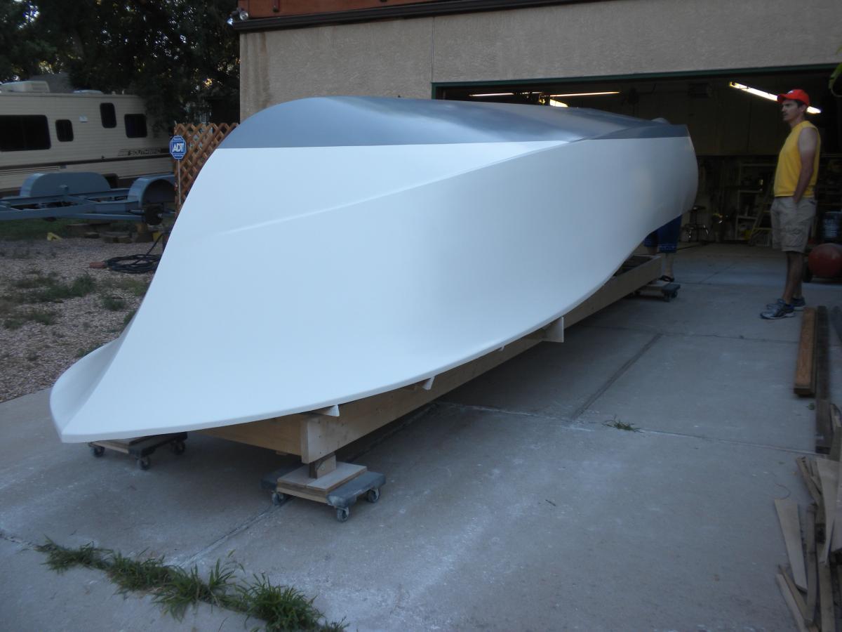

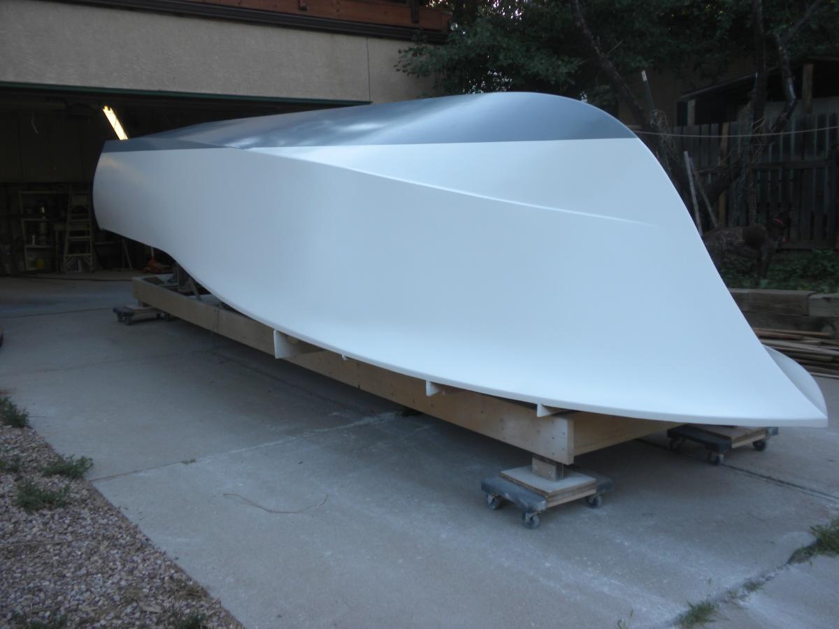

Fishman38 Posted July 27, 2014 Author Report Share Posted July 27, 2014 Finally done with painting the hull, provided I can get her flipped without damage.....The motor home beyond the trailer belongs to a neighbor. Also finished painting the trailer this morning. Hoping to not have to open another can of paint for a few weeks!! Starting to build the frame and cradle to protect her as she's flipped, which I hope to take place in a little more than a week. Quote Link to comment Share on other sites More sharing options...
