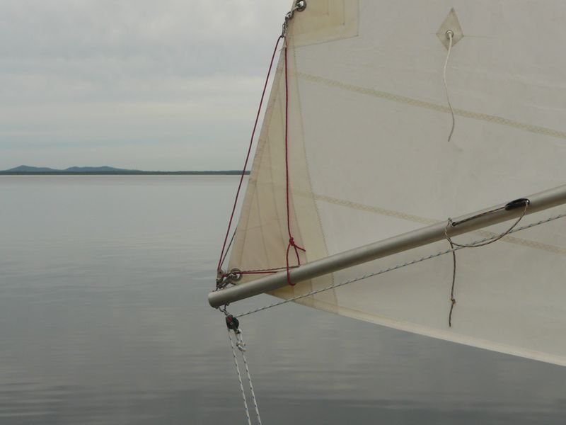

Peter HK, do you use stand up blocks in combo with your rotating bullseye/cam cleats?  I bought the cam cleats with bullseyes and was hoping that was all I needed for the mainsheet, except the block on the end of the sprit.  I see Tom uses stand up blocks with his.

Posted 13 March 2013 - 07:38 AM
If you didn't use the block at the cleat, how would you keep the angle of the sheet to the cleat consistent for engaging the cleat?   Think of it as a fair lead that rotates to accomodate the incoming angle of the sheet under all points of sail.
There is a bullseye fairlead on the cleat.
I don't use stand up blocks. The main works fine just using the fairleads.
