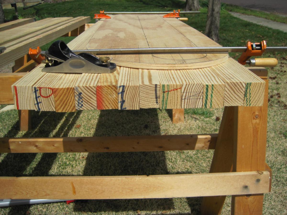

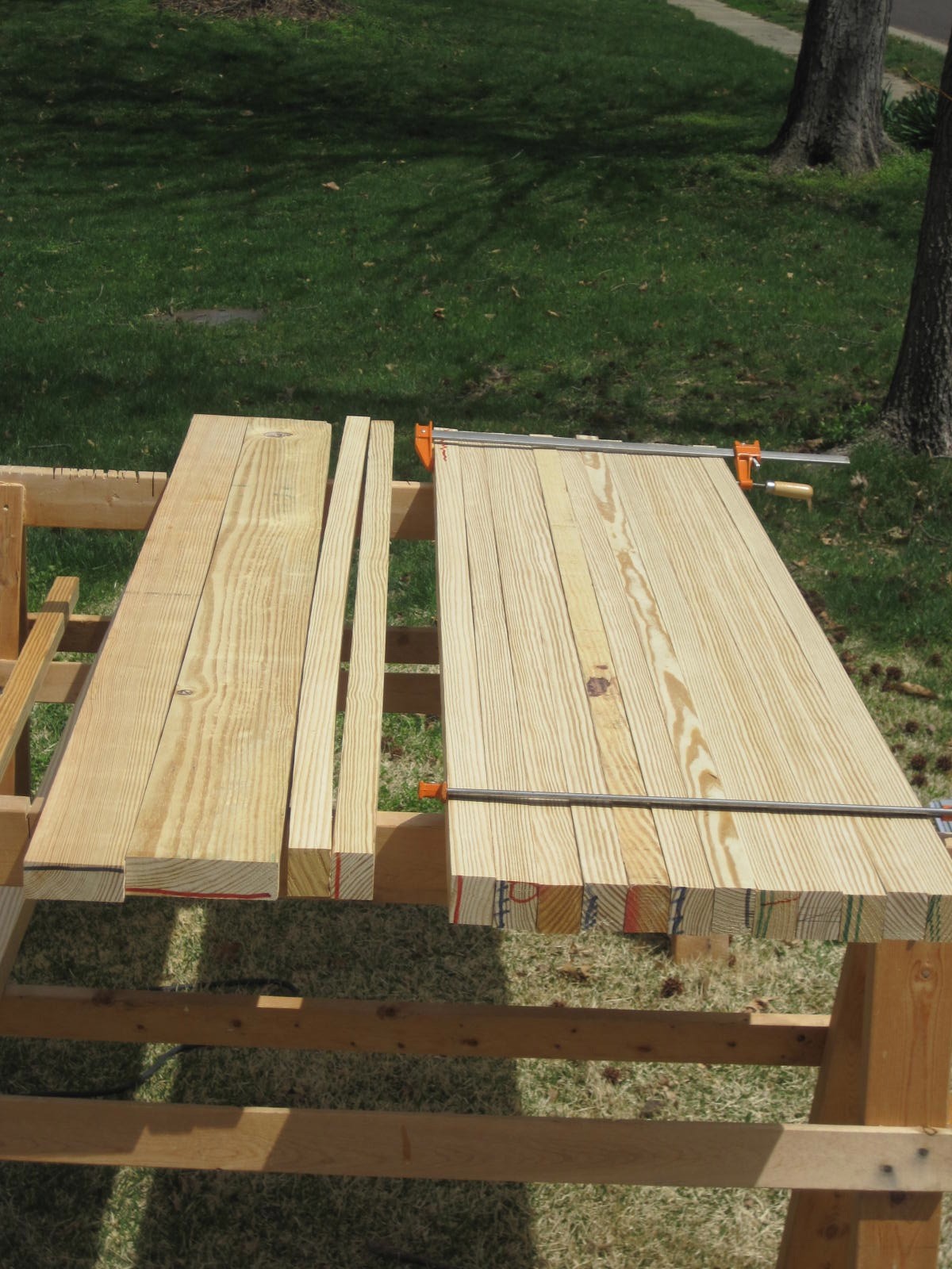

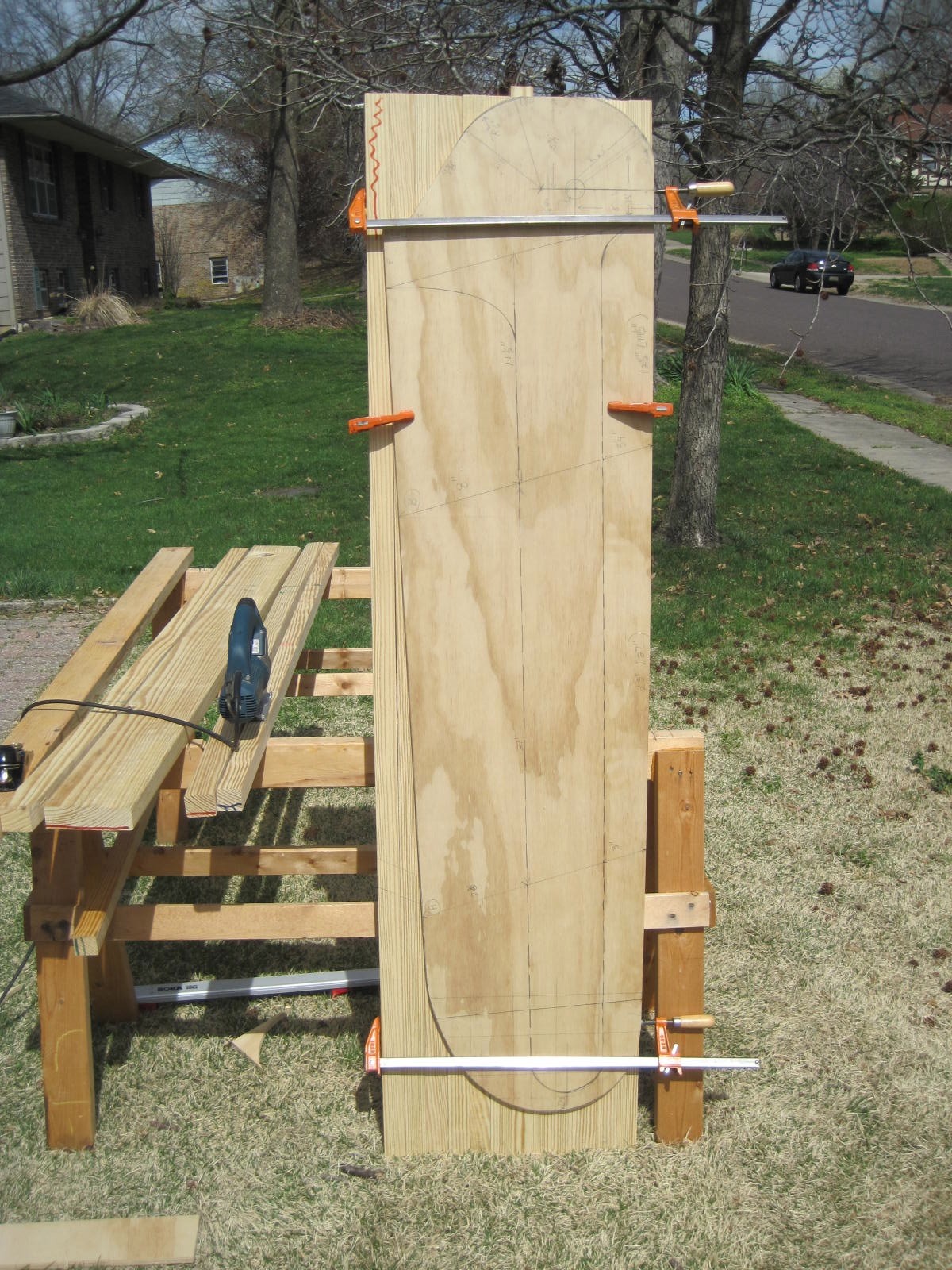

Thanks Wayne. That is timely news on the CB. Had already concluded it would be a good idea to "test sink" it before installing in the boat. Not only does that board have to sink, but has to have enough weight to pull all the line back through the resistance of that 4:1 lifting tackle. I am beginning to suspect that board, with lead ballast tip, may end up in the range of 100 pounds or so actual weight.
Speaking of CB's, mine is currently in progress. On most boats, that is something that can be done at the end, but on this boat, since the width of the CB trunk is related to the finished thickness of the CB, you need to have the finished and glassed over CB on hand before the CB trunk is built. Installing the trunk comes early on in the build process......shortly after the hull is turned. So that means a CB built and shaped at the least, with some idea of the thickness of the glass that will go on it.
Scaled out the CB on plywood and cut that out as a template. Once the template is trued up and fair, will use the template to trace the pattern on the board blank on both sides to help with shaping and fairing. Template will be retained in case as spare is needed someday.
