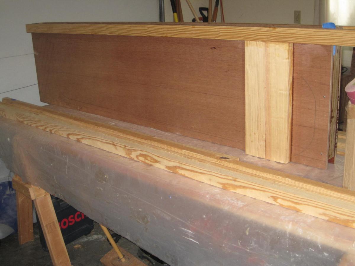

ON CB case, rails and doublers are glued on. Was going to go ahead and glass it, but decided to hold off until it is fitted and ready to go. Plans say not to drill the pivot pin holes until then, so have held off on that too.
Also seem to recall there being a slight difference in where the LWL on the CB trunk mated up to the LWL on on BH#5, so figured it best to stop here until time to actually fit it. Good to get it ready, however.
BTW, even as shown, CB trunk is heavy. Have not weighed it, but could easily top 40 to 50 pounds. Glued and glassed in, it will be hell for stout!

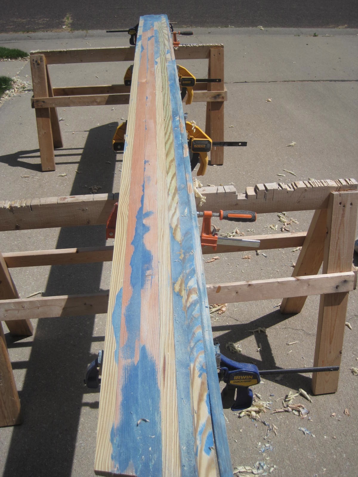

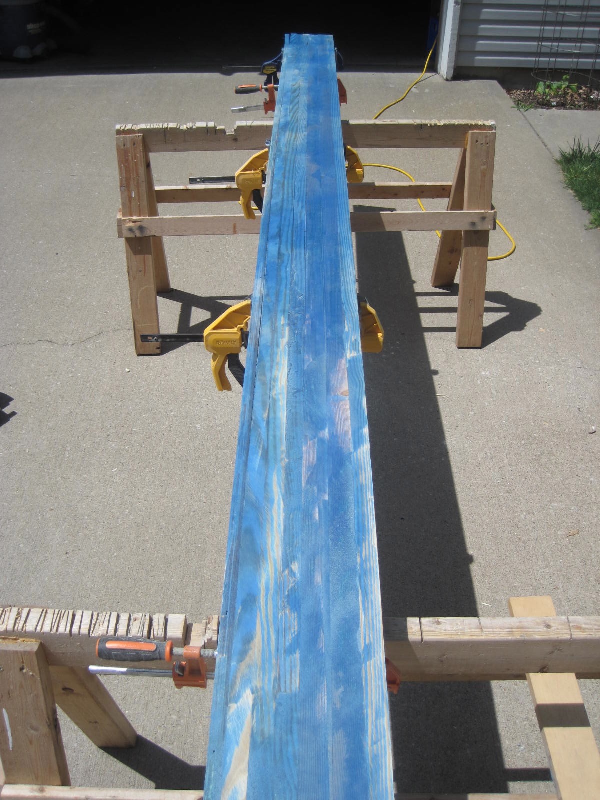

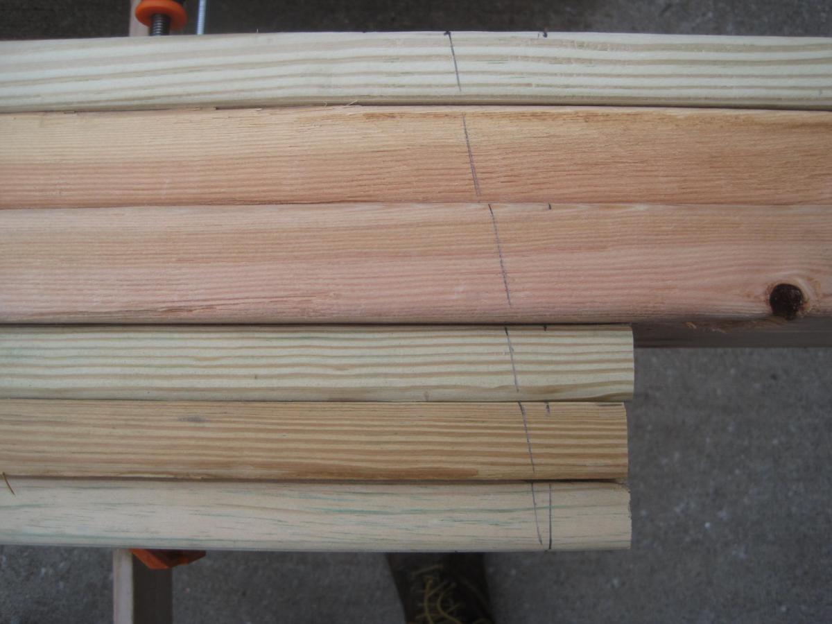

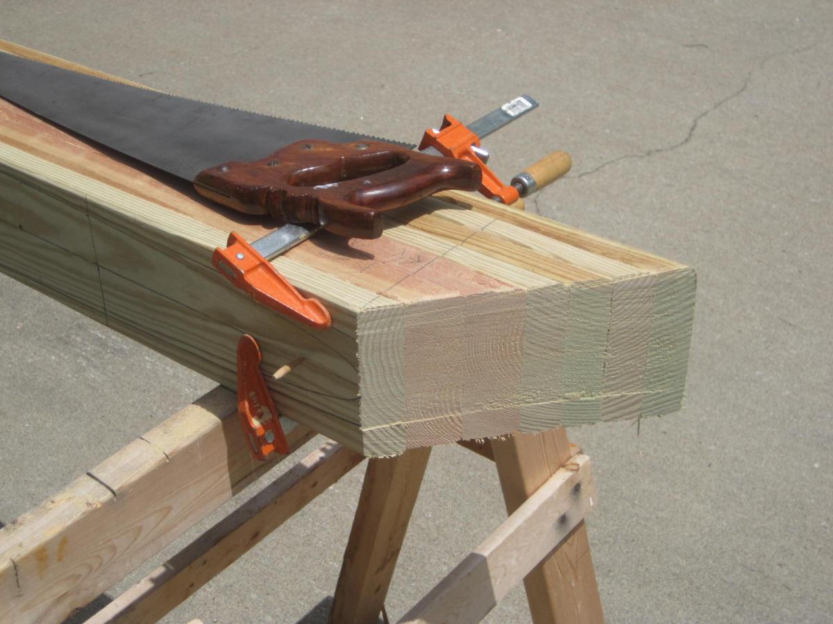

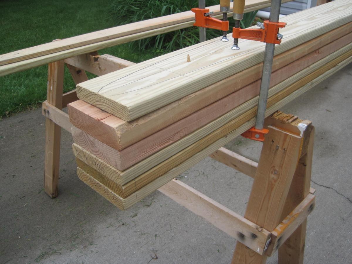

Made some progress on the keel. Reminder, keel is formed from two parts. Permanent keel stub, plus 750# lead keel that goes on the bottom. Permanent keel deadwood is 3", lead keel part is 3 3/4". These are formed and shaped together, but need to be two separate parts. The wood part that becomes the lead keel is nothing more than a plug, so was able to use "iffy" lumber for that. Since I had it, I used a combination of 2 - 1 1/2 " planks, plus one 1". That would have made 4 inches of lead, which by my calculations would run the lead weight up to 800 pounds. So did some thickness planing and brought them back down.
For those wondering how more draft and ballast could be added, not sure what Graham has in mind, but having done it, a builder might be able to insert an additional deadwood plank in the mix to lower the same amount of ballast (would increase the righting moment), leave the lead part as 4" and hike ballast to 800 pounds, or any combination of those. Seems to me a lot of ways to skin that cat, but I'll leave that for others to worry about. I'm trying to stay as close to the actual plans as possible to see how it goes.

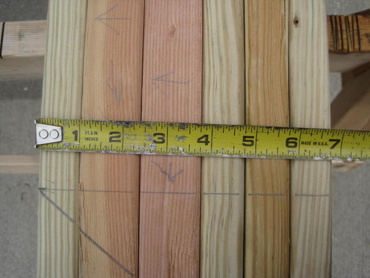

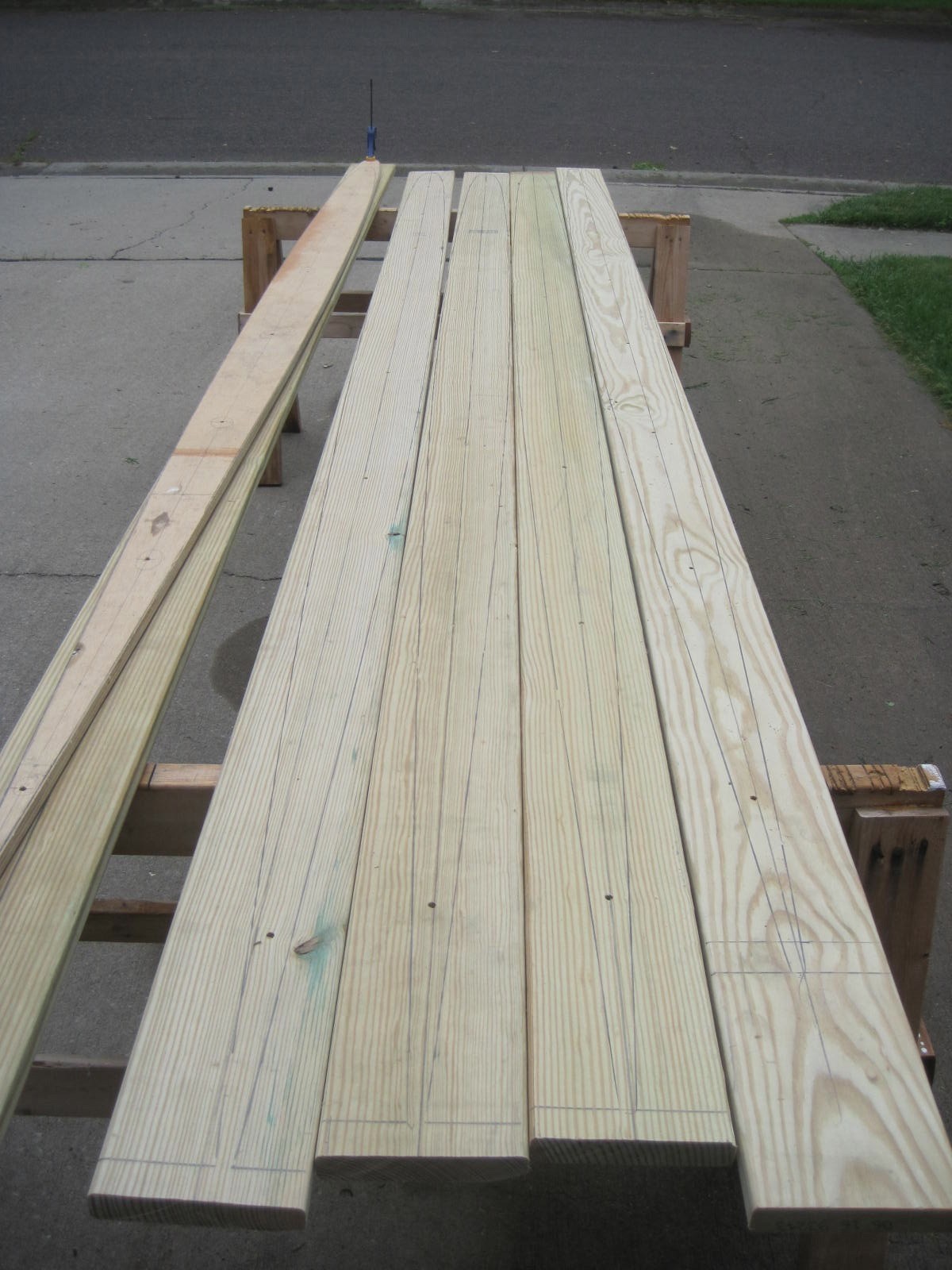

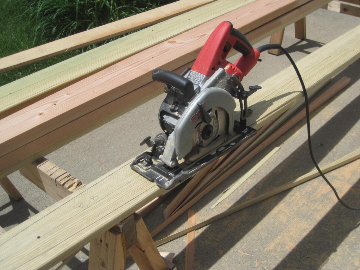

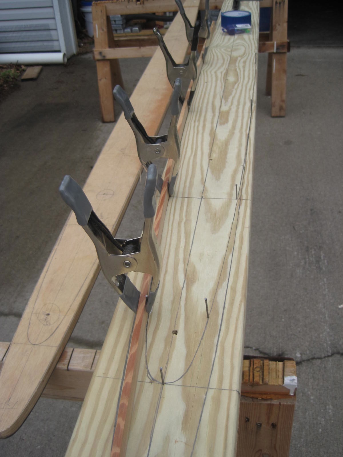

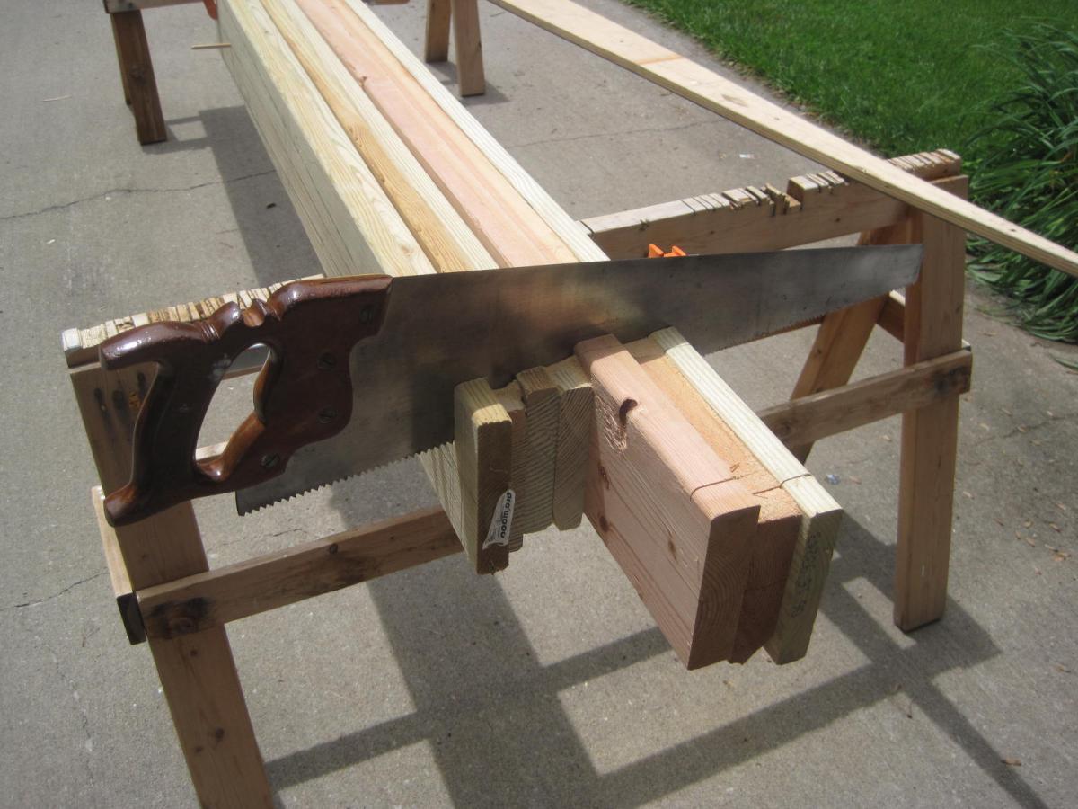

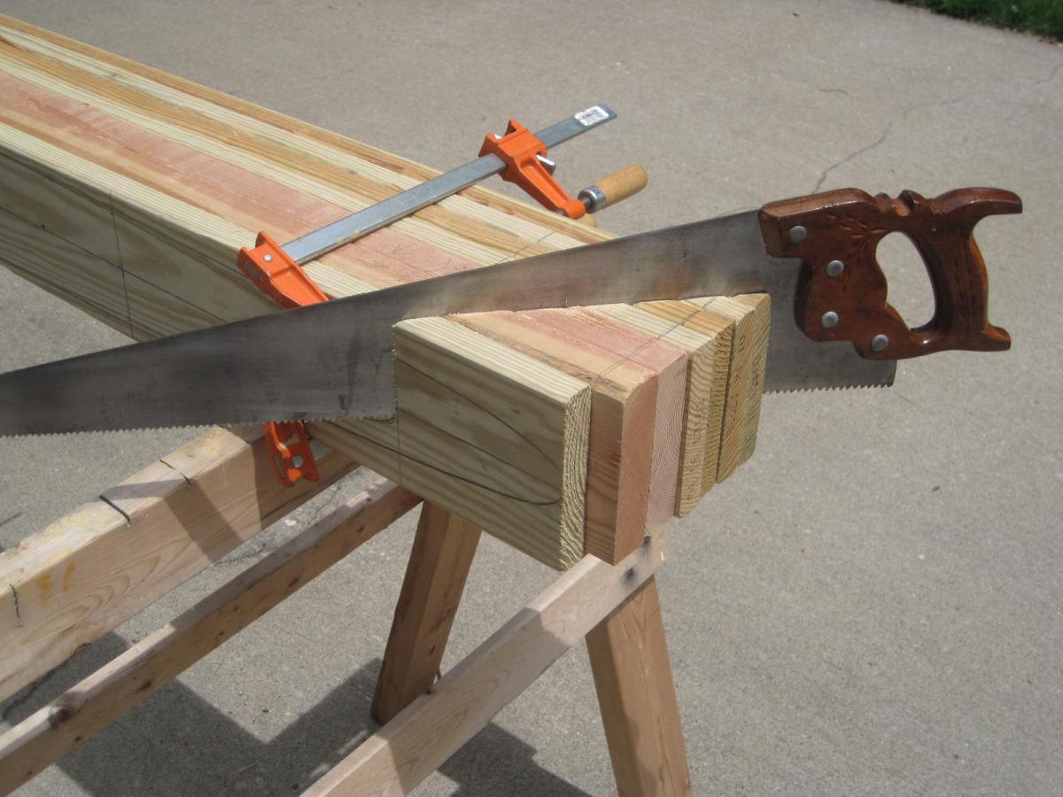

So for shaping, early on, I developed a shaped pattern that I could use to trace the required shape onto each plank. Two dimensions are given. Full shape, and shape at the bottom edge, resulting in a swept back nose that is narrower at the bottom than at the top. Keel also pinches in or rakes forward aft. Decided the best way to set these shapes was to trace the large outline on all planks, the smaller outline on what would only be the bottom edge of the bottom plank, then cut the nose and tail sections in one piece to set the angle on all of them. To do that, you need some type of saw to be able to cut that. A chain saw came to mind, but then remembered I had a hand saw that would do it. This one is an Atkins 65, rip saw with 5 1/2 teeth per inch, but is filed crosscut, so is able to (slowly) handle a cut of this size. Extra tooth size is needed to carry the dust out of the cut. Was a pretty good workout, but it did work.
After that, did a rough cut out of each plank with a circular saw. Tried both circular saw and jigsaw and circular saw won hands down. About 4x as fast and 2x as accurate. When all were pinned together, rough outline takes shape. Next step will be to glue top and bottom halves together, then reassemble for final shaping.
One additional step is included. Plans also make reference to small wedges that will be needed under the nose and tail sections. These are needed to conform to the curvature of the hull. I went ahead and included these in the nose and tail sections, but final shaping will come later. Outline shape given in the plans does not take these into consideration, but the builder will need to.
Lastly, the most helpful part of this entire project has been the plywood pattern. I would do one for the top and bottom to increase the speed and accuracy of the shaping.
On the tail section, note how far apart and staggered each piece becomes. Ideally, each plank would be dead straight, and these were when they were purchased, but didn't stay that way. Most of them managed to stay mostly flat with no twisting or cupping, but nearly all of them developed a slight bow. I was able to get all these planks from 5 1/2" (1 x 6 and 2 x 6) boards, but it was tight, and required some fitting. However, once they were all cutout, they all had the same shape. They are now pinned together with dowel rods and getting them glued before they distort anymore will be important.

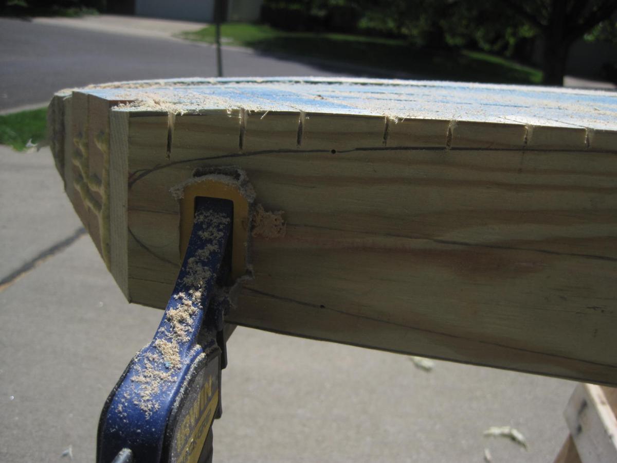

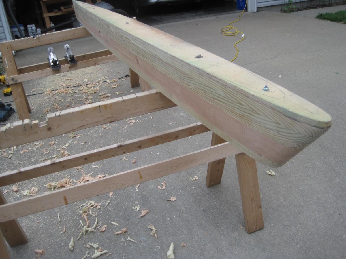

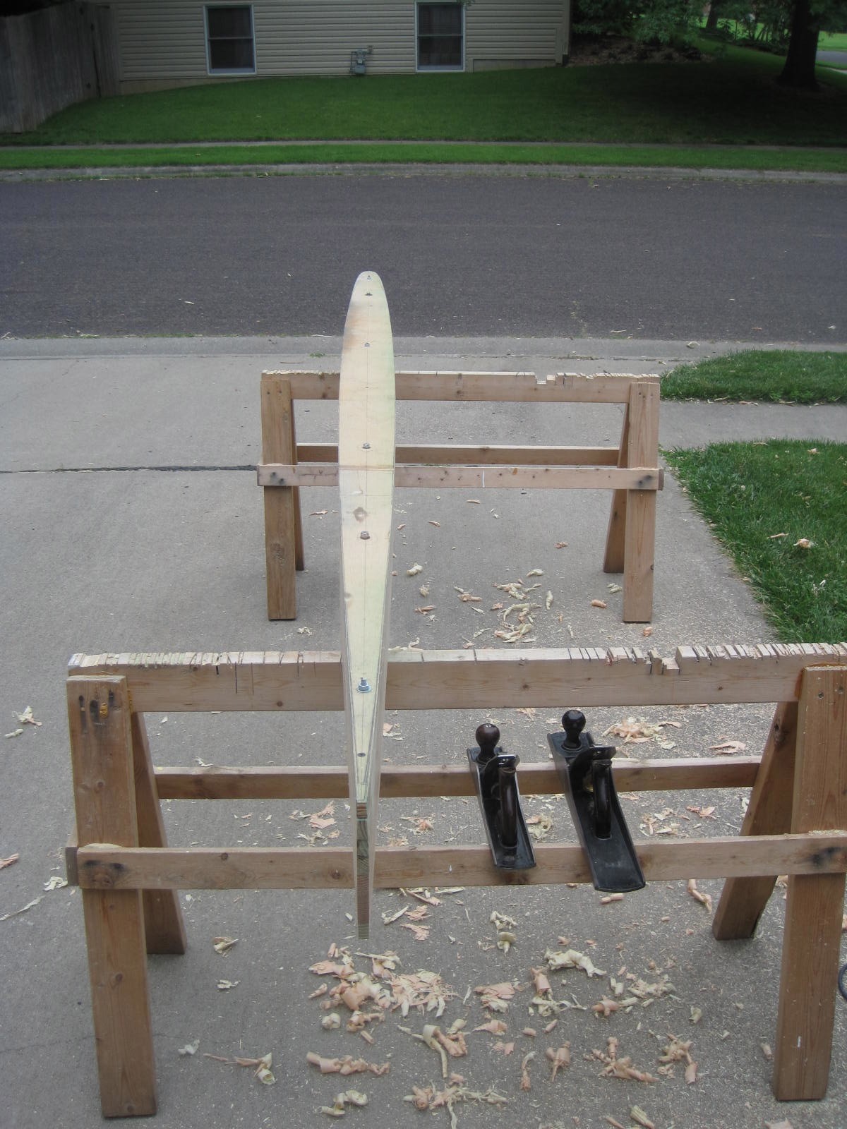

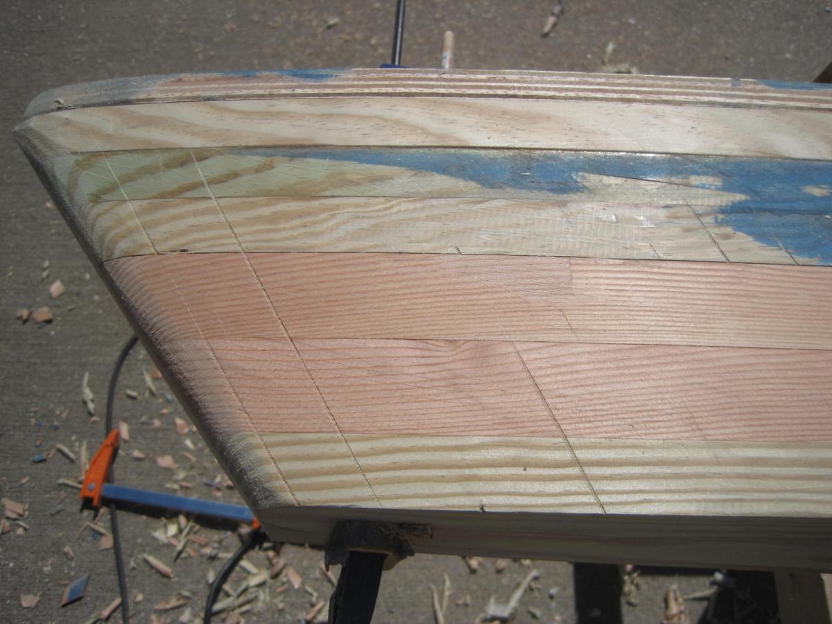

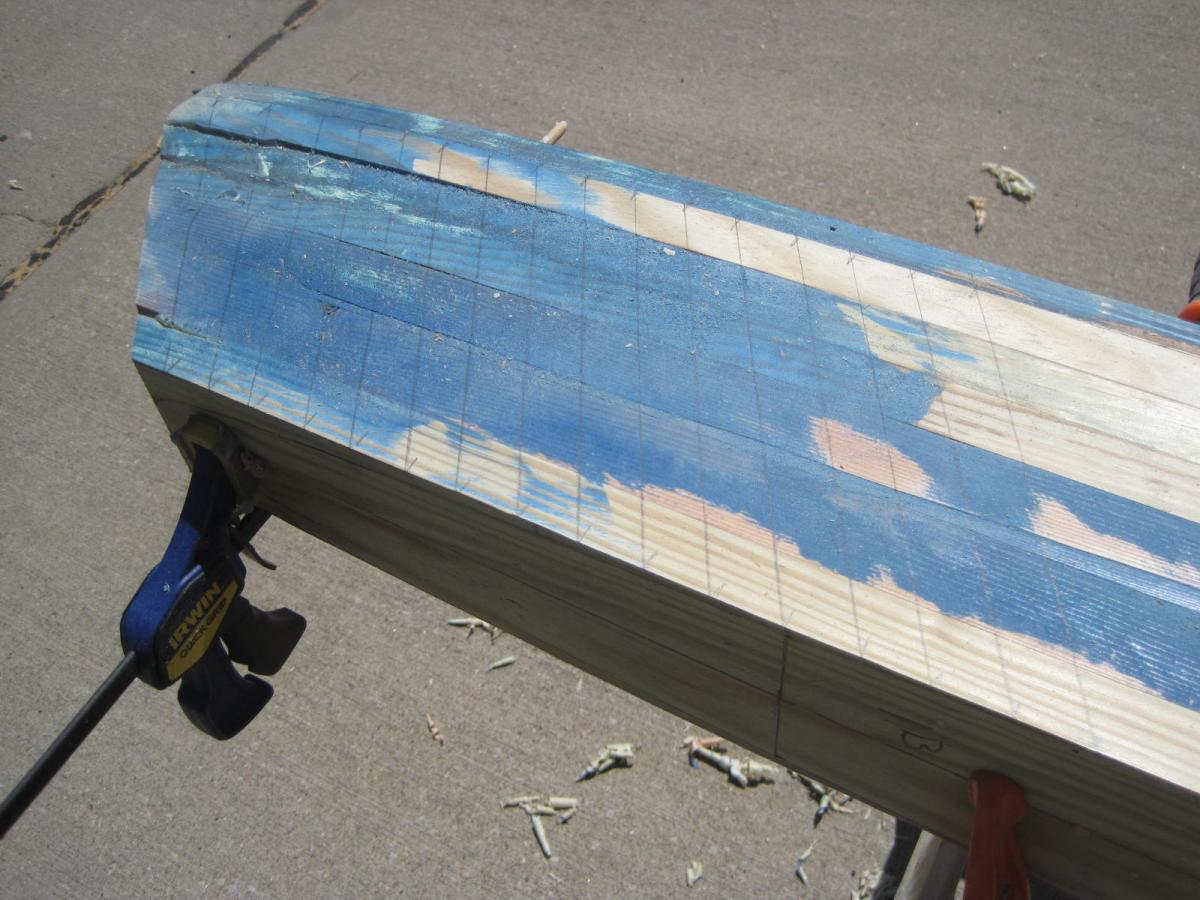

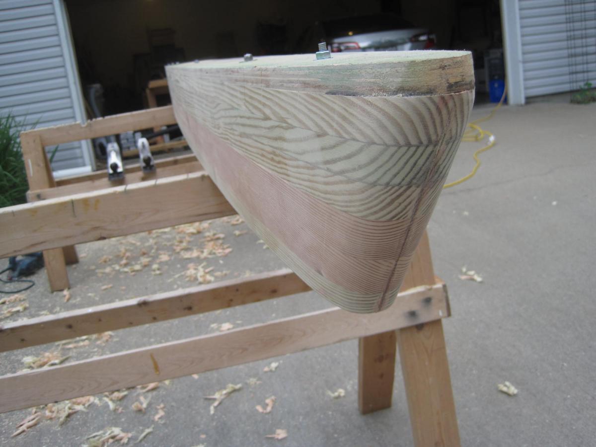

Keel has been shaped to it's final form. Not much else to add, except how I shaped the nose. In addition to being swept back or raked, it also pinches in at the bottom in a variable curved shape The top and bottom come together and become one uniform shape about 2 feet aft of the nose section. To form this shape into the nose, I again used a hand saw to cut score marks at 1 inch intervals. Cut down to where the saw teeth barely score the top board of the deadwood and down to the line marked on the bottom board. Remove the excess until you get to the bottom of the score marks and the shape should take place.
To bring the sides down flush, I hit the sides with acrylic spray paint, then hit is lightly with sandpaper to find the high spots and then started working them down to flush. Although the sides are shown as 90 degrees on the plans, I actually took a bit more off the bottom......about 1/16" per side, such that there is a slight bit of taper. This should help when it comes time to pull the plug from the sand casting.
I eventually wised up and went from dowel rods to align things and clamps to hold them together to threaded rods with nuts top and bottom. Made it a whole lot easier to roll this thing over and over and over and to keep it all aligned.
Doing this again, I might consider using plywood scraps to make the bottom plug part. Just glue them up with tightbond or gorilla glue (not epoxy). They would be easier to shape and will remain stable. Glue up the entire plug to rough overall shape, then run that through a bandsaw.

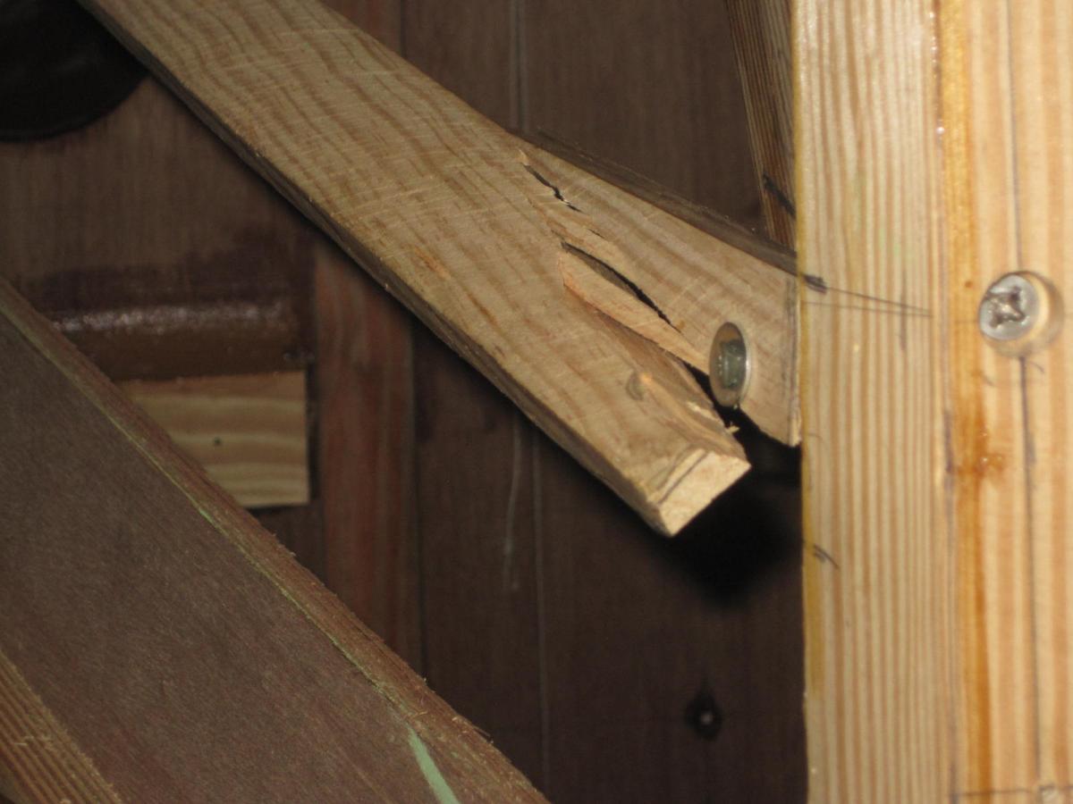

I did find a problem with the one plank of deadwood I cut with my jigsaw. Somehow that blade managed to cut inside the final shape line. It will have to be cleaned up, then backfilled with thickened epoxy to bring it out flush. The painting trick really works to help find the high and low spots. My eye alone could never do that well.

I had not considered using the foam. The tail section gets pretty thin.........mine is now 3/8" and plans suggest is should be 1/4". Not sure if foam is rigid enough to avoid side to side distortion of the tail when packing the sand for the casting. But if it is, and a builder was careful to check it, to make sure it remained straight, foam might be a good option. Come to think of it, you can put a single layer of glass cloth on it and that would stiffen it enough to keep it from distorting side to side. Or simply check it often with a straight edge as you are packing the casting sand around it.
If blue (or pink) foam can be used, that would be a piece of cake to shape. Make your templates, top and bottom, but for the bottom template, hold off on final shaping the pinched in section on the bottom. Shape just the dead wood section that goes on the boat first......identical templates on both sides. When that looks good, you can add the foam, then cut the foam with a hot wire foam cutter. It will come out perfect. At that point, all you would have left is the nose section. You could then cut out the shape of the nose section similar to what I did.
A big advantage of foam or plywood is once shaped, it will remain stable and the shape of the plug won't distort over time. If you are not able to make the sand casting right away, it shouldn't matter.

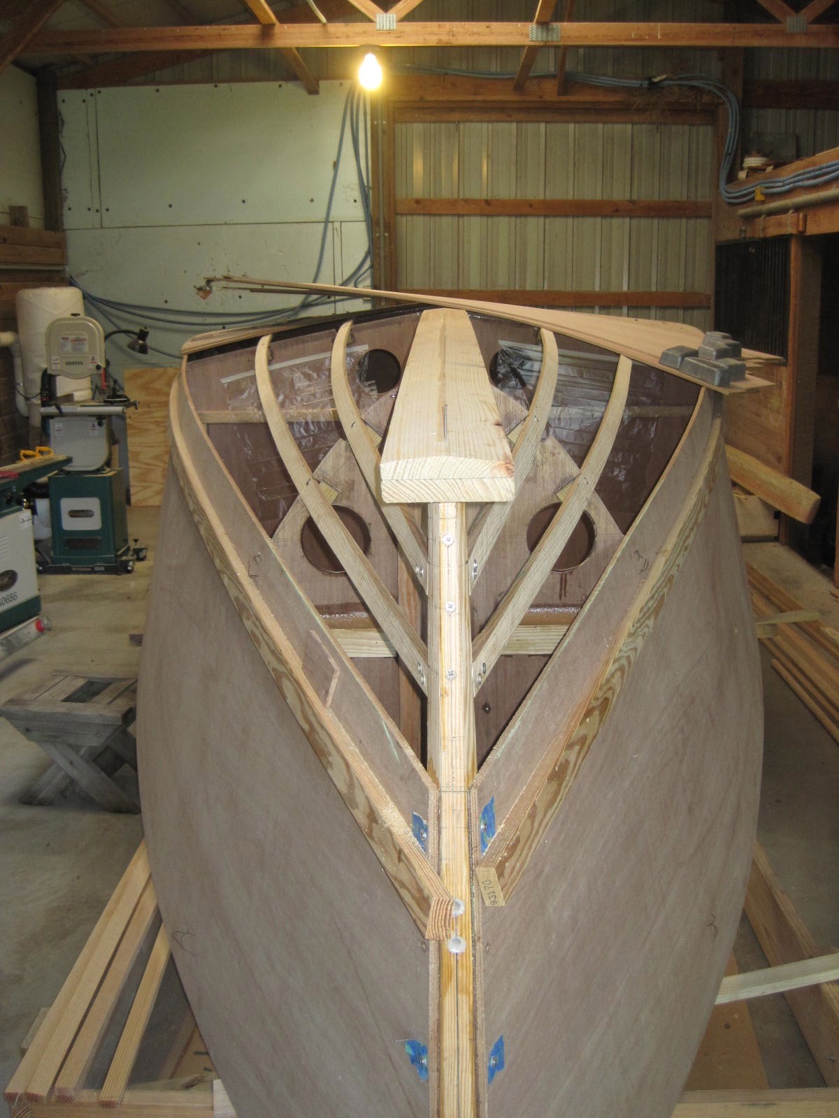

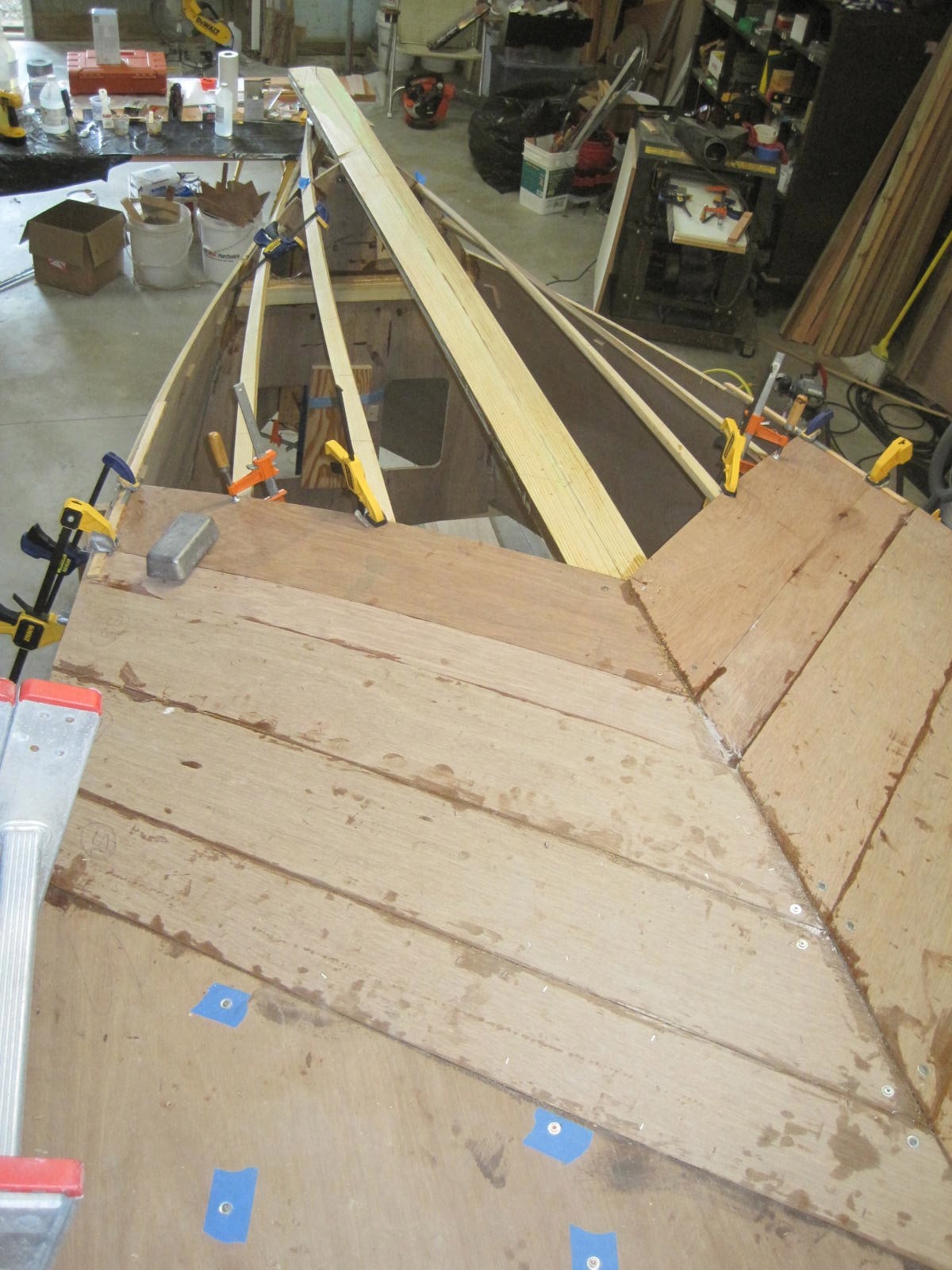

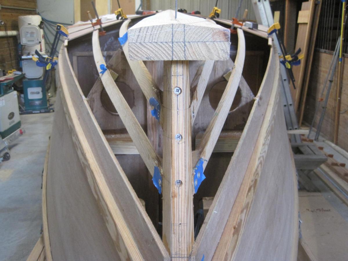

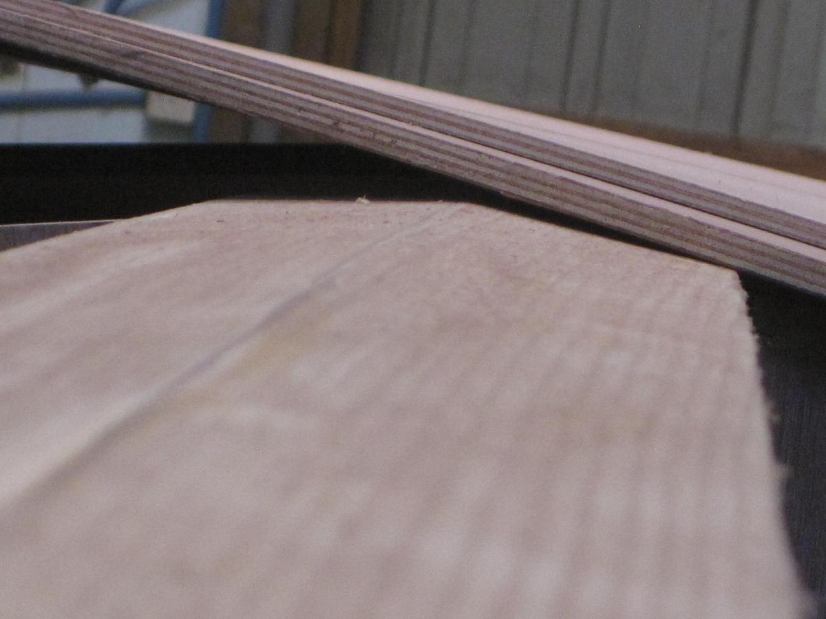

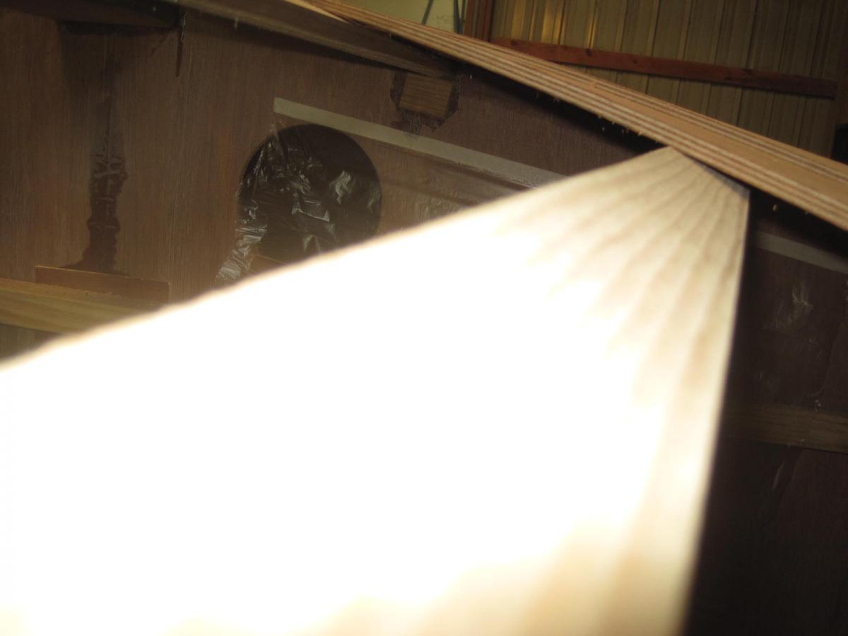

With the keel and CB case ready to go when the time comes, have resumed work on the hull. Next step was the stringers, which I have been fretting about since the first time I saw the plans. It turns out, those are not that big of a deal.
About the only fitting involved, once you have the notches cut into the bulkheads, is at the stem knee. Wasn't sure how that was going to turn out, but after scribing and fitting, they came out flush to the bevel off the stem.
There is some twist to those......about 80 degrees or so.......that takes place inside the span of about 10 feet. A person can twist those easy enough but how to you get them to stay put? I finally decided to add some glue blocks to the bulkhead notches and after twisting the stringer staves into place with a big wrench, screwed them down so they would stay put. As near as I can tell, they look like the plans, so will be glued in place. (Had to deal with the obligatory busted one. Had extra length, so cut that off and started again.....with double screws to spread the load.......which is substantial). It also helps to use long screws.......so they won't pull out.
Next step will be to glue the stringers in place, but before doing that decided to mock up some of the bottom panels. Those appear to hit the high spots, but do not conform directly to the stringers. Plans say some twist may have to be planed into those, and I suspect that may be what the reference is. Plane the high spot down so those lay somewhat flat, then start trimming the edge of the keel planks as well. Somewhere about the top of BH #2, those stop laying flat and no amount of pressure will make them bend into place. So.......time to start trimming and fairing these into the keel.
For those who have actually done this, does that sound right?

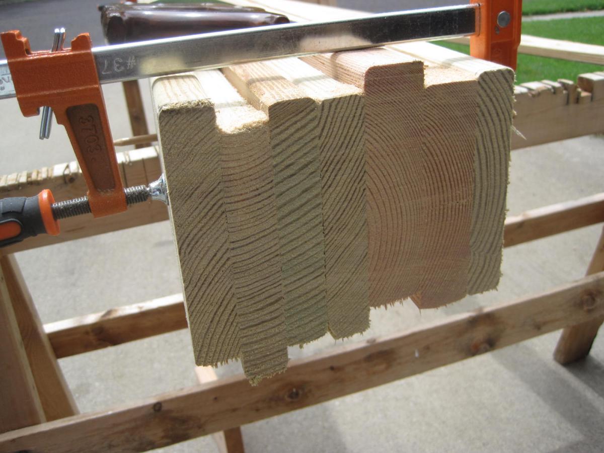

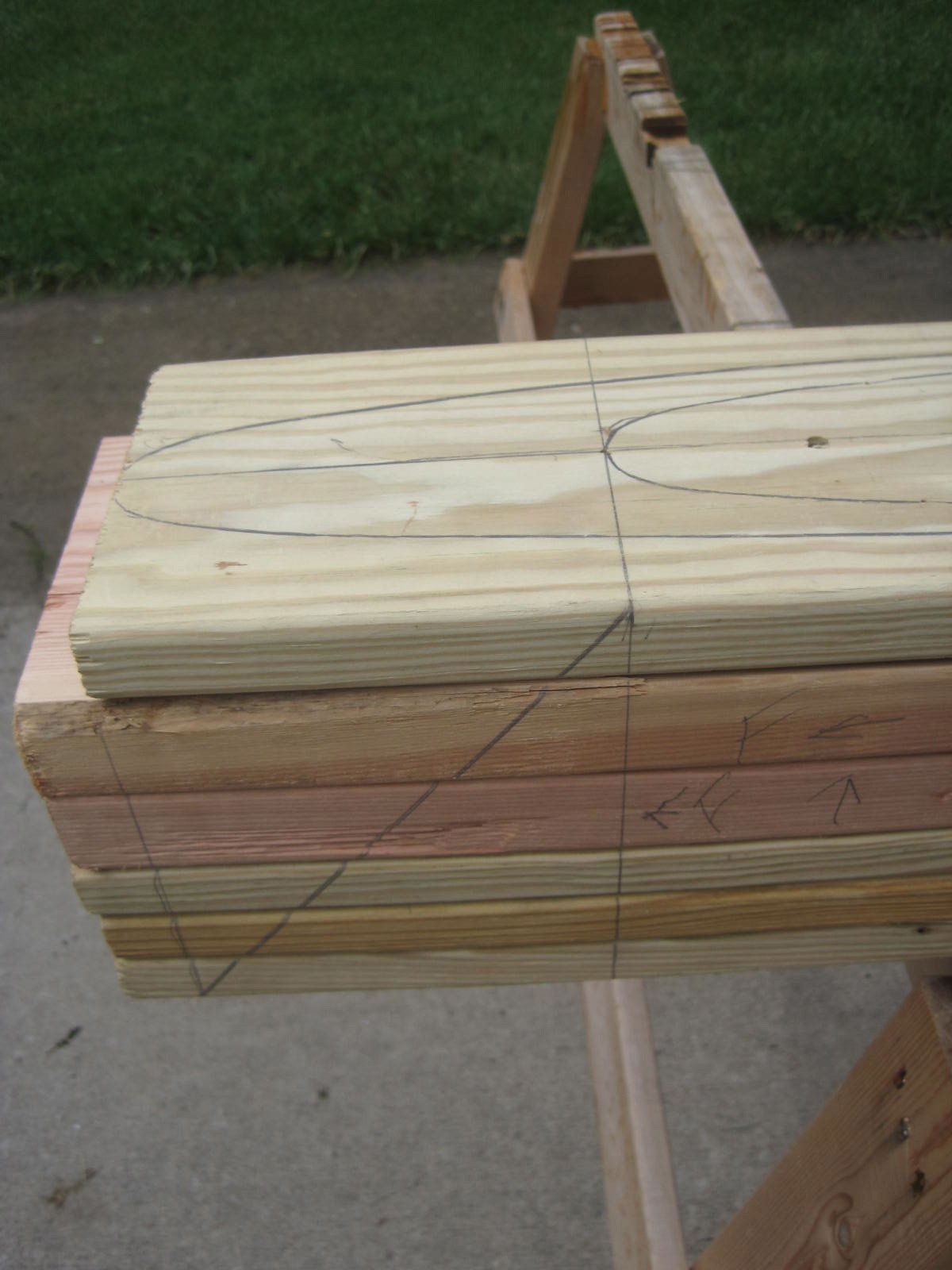

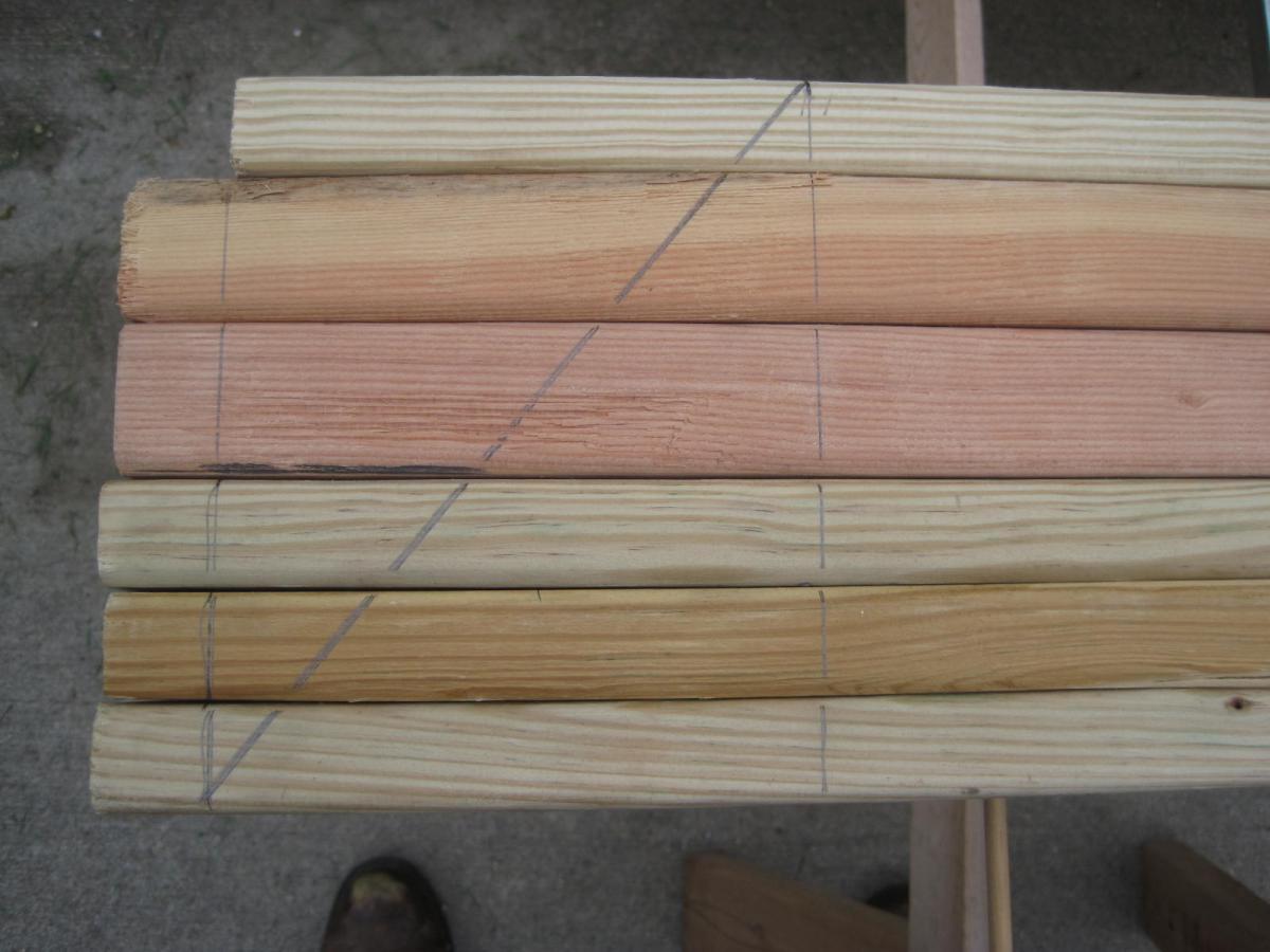

Each section was glued together prior to shaping. The three planks what will become the boat's keel deadwood were glued together. The three planks that will become the plug for the lead keel were glued together as a group. Then the two of them were joined with clamps and later threaded rod for shaping. But now that they are shaped, the plug can simply drop off and head for the beach (sand mold).
Missing in all that are two additional plank sections.........wedges for the keel deadwood at the nose and tail. The bottom has a bit of rocker, so curves......the deadwood is straight, so wedges will need to be fitted at the nose and tail and need to continue the same shape profile beyond the shape profile given in the plans. These will have to be scribed and fitted as the keel is being installed.

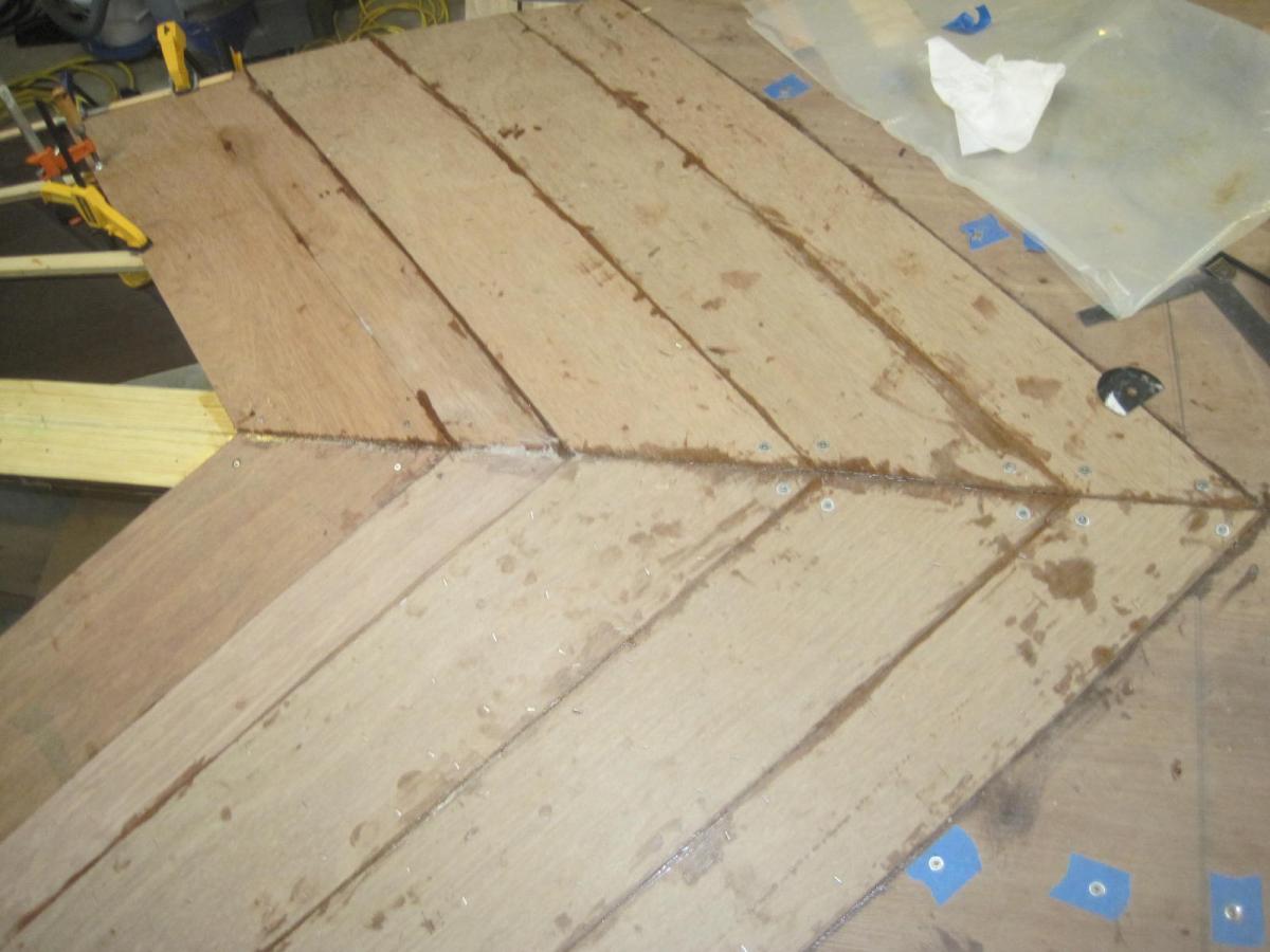

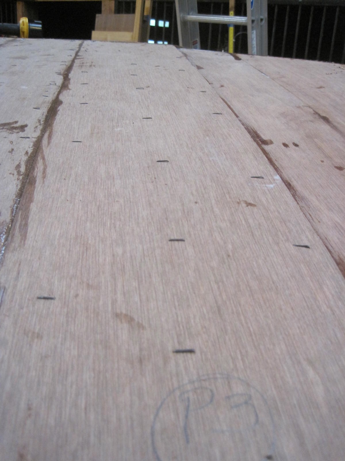

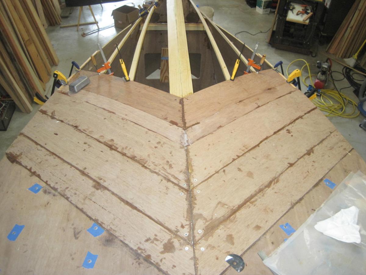

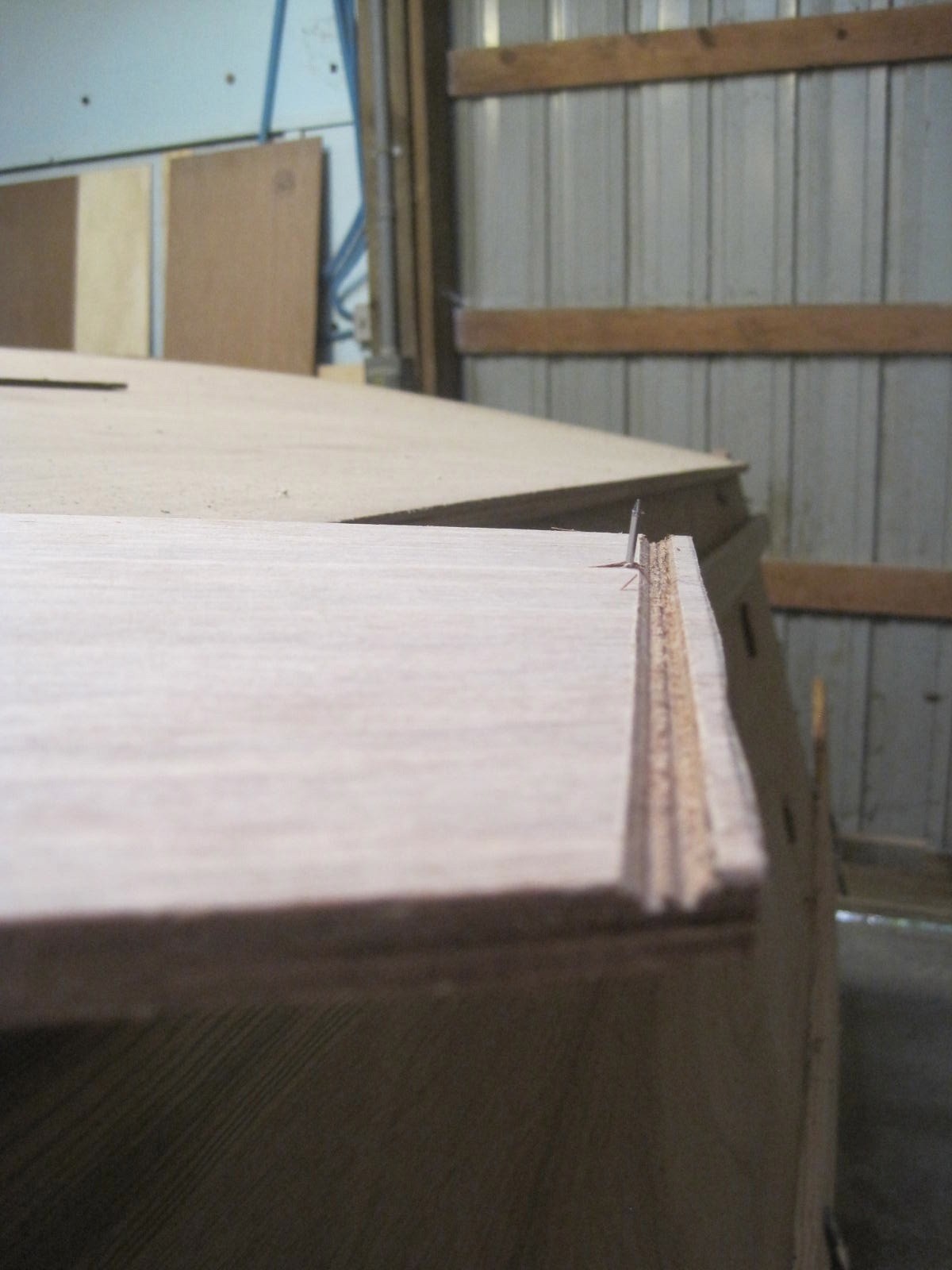

A bit more progress. BTW, not sure if it was something I did or if the plans need more fine tuning, but with the sides installed and bulkhead  #1 in it's designated position, I was getting some "concave" in the side panels at bulkhead #1. Ultimately, if left that way, if would mean a dished in / reversed curve section through that area of about 1/16th to 1/8 inch that would either be left as an eyesore or something requiring major fairing, neither of which appealed to me, so decided to bite the bullet and find a way to fix it. Ultimately, that simply meant moving bulkhead #1 forward about half an inch which allowed the sides to adopt a fair curve through the bulkhead #1 area. Anyway, once I was satisfied with that, I was free to permanently fix the stringers in place and get going on the remaining forward bottom panels.
I initially started dry fitting each of the bottom layers of bottom panels but once I got about 6 of those in, they started distorting the stringers out of shape. Talked to Graham and abandoned the plan to dry fit them all first and go back and start gluing them permanent, inside and outside. So far, I have 4 of the bottom panels in and 3 of the tops. As the curve starts to take place, pretty incredible how solid that area is becoming. Tapping on the 3 bottom panel that bends over the top of bulkhead #2 is about like tapping on the concrete floor beneath it.
Plans suggest "notching" the interior panels at the chine to get them to get them to transition from lying on top of the chine to blending into it.  For the notching process, I'm using a 45 degree router bit chucked in a small Bosch router. When that is fitted over the outside edge of the side panel at the chine, it allows the inside edge to drop down almost flush with the sides. As I move forward, I deepen the notch. By the time I get forward far enough for to ditch the the notch and go to a vertical butt joint at the chine, the step down will be nominal and should blend in seamlessly.
For the first few panels, I used an Arrow pneumatic stapler with 1/2" monel staples. They work well, but I'm not excited about digging all those out (don't have to but I don't want to leave metal in the hull to potentially damage tools), so now have the plastic Raptor staples to try. Jury is still out on that one. BTW, even though this is an outside bend, something you might think would clamp itself, it is also a compound outside bend, so without the staples, one edge or the other or both may "pucker up" a bit. To get them to conform and lay flat to the desired shape, you do need to staple them.
Bottom line this is not as big a deal as I have been worried about. Does take some time to fit these individual panels into place, but slow and steady will get there eventually.
