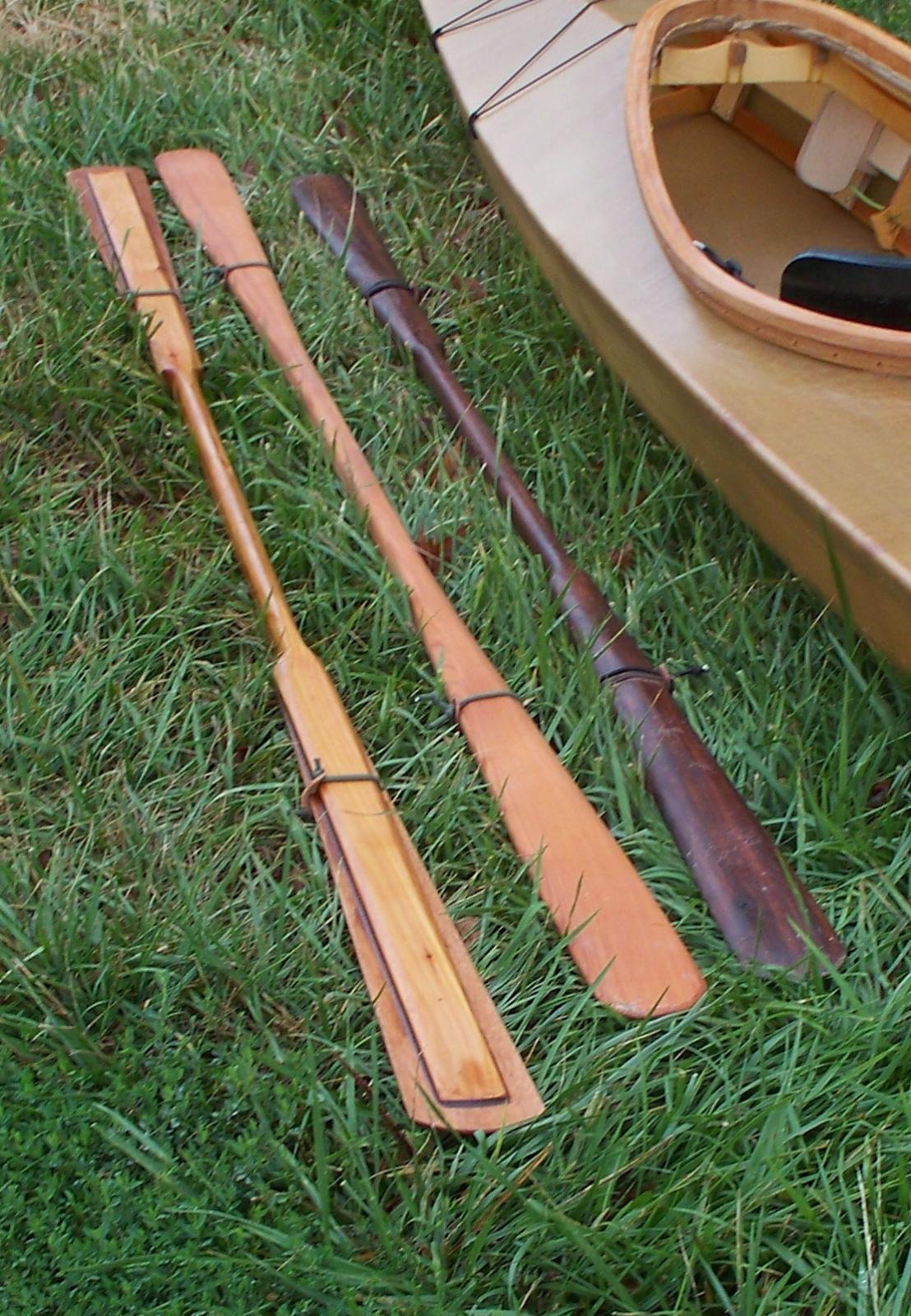

Here are a few pics of my lattest adventure in paddle making. I am now adding hardwood tips to my paddles. The Inuits used whale bone, but I don't have any, so I made do.
Attached File  DSCN2161.JPG   409.08K   22 downloads Attached File  DSCN2162.JPG   337.12K   18 downloads
left paddle is Alaskan Yellow Cedar with a Dark Red Meranti tip
right paddle is laminated Western Red Cedar and Alaskan Yellow Cedar with a Maple tip

Those are really nice!

True Art!
