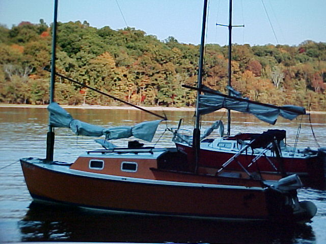

I was looking over my Belhaven plans tonight to answer a question for a friend. Suddenly I find I have been studying them for an hour like a kid in a candy store. Here I am over my head on a new 28 footer and wishing like all get-out I was building another Belhaven. With a few modifications of course. Its kind of like I should go to AA classes for hopeless builders. Or maybe the Belhaven was such a perfect fit for the solo cruising I loved to do so much.
If I was building another she would be without the quarter berth and a bigger galley with a great ice hold. She would have about 10 inches of length added to the stern with a motor well and to keep my ALWAYS over loaded boat from dragging water behind the transom. That's not a design flaw if built to spec's, but a captain issue of overloading the big cockpit lockers with too much stuff.
When I sold my boat to Rick I thought I would never get done unloading her.
It sure was fun digging through the plans tonight. Anyway she is a great boat and I will always miss mine.
Scott
These pictures are from a 300 mile 10 day cruise Jerry C. and I took, along with Don and Gail in their Catalina 22 a few years ago.

Hi Scott,
I'm curious as to why you'd extend the Belhaven instead of going with the PS22? I keep looking at both boats and am not sure which I would choose if I were to build a small cruising sailboat.
Fred

First let me say they are both great boats. I just prefer the more modern look of the Belhaven over the Princess. ( Just a personal opinion )
Even if I added 10" to the Belhaven she would still be under 20 feet which is important to me with a v6 pickup. Like I said earlier I tend to overload my boat and some more area in the stern would help with my :( problem. :( The Belhaven also has slightly more head room and I like most of the cabin layout better. Not saying its better, but for me I like it.
The pictures of her at anchor shows her sitting pretty close to the way she should. That was at the end of a long trip and she wasn't carrying near as much stuff then. She also didn't have my lard butt in her. I raised the water line on her 1 1/2 inch's so she should be setting a little higher yet.
I also live in the land of rivers, Ohio, Cumberland, if you have ever done much sailing on rivers you know the winds ether on your nose or at your back. So we would have to motor more than we ever wanted to. The motor well would help quite the beast a great deal.
I used my boat a lot and very often for a week or sometimes two at a time. So on a new one I would want even more carrying capacity for a water tank and get reid of all those portable water jugs. A very large ice hold would be added too. A portable tiller table that could be stored in the lockers would be nice also. "Getting the picture I was making a 30 foot cruiser out of a 19 foot boat."
If a person was using her for a overnight-er all the time, and was much more conservative about what they took along I wouldn't change a thing. BUT that's not me. :)
Darn it - that is a pretty boat.
Out of curiousity...
* do you keep the full 300# ballast aboard when loaded for cruising?
* if not, have you any feeling for how the boat would do without the ballast (esp when loaded)
* will the boat self-right without the 300# ballast - with NO CREW in the boat?
Inquiring minds - maybe this is the boat I've been looking for (without the ballast ;) ) the more I see of her the more she looks like a winner (yes, stretched a foot or so for me too).

I don't understand why you wouldn't want the ballast. Its fixed as a shoe on the front half of the boat. These are questions you need to ask Graham, but I don't think I would want her without it.
I have had her knocked on her side twice from my own laziness to reef or just seeing what I could get by with by myself. Both times was in high winds, one time that day a few tractor trailers got blew over on the interstate, so I didn't feel that bad. Both times she jumped right back on her feet so quickly I had a hard time sorting out what just happened.
She always felt safe when I would treat her right and reef when I should.
I had the same dilemma too but eventually went with the Belhaven because it looked easier to build and is lighter than the Princess 22. My principal reason for extending the hull at the transom is to keep the outboard within easy reach. I've had enough hairy times fiddling with a transom-mounted motor.
