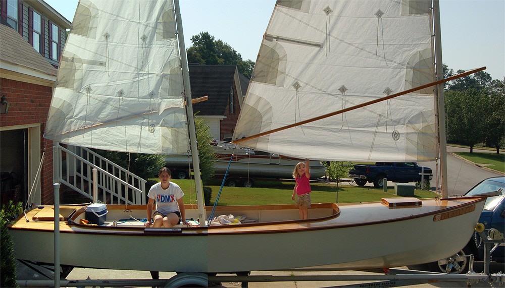

I took some scrap and (temporarily) extended the main 9-1/2" this morning. Then I put the main in the mizzen step, to see what a 13" taller mizzen would look like. This is what I came up with:
Main has about 17" clearance above deck at the sail tack (versus 7" previously), and about 36" above seat tops where little Bella is standing--plenty to clear passengers' heads.
Mizzen has at least 34" clearance above thwart at the sail tack (versus 16" previously), but can be hoisted high enough to get 40" of clearance if I want to install a short (36") bimini in the aft cockpit. That would be very nice during hot Georgia summers, but I had abandoned the idea until now because the sails were too low.
What do you think? I spliced this photo together, but it looks much more like the photos of other CS boats I've seen. Anyone have a bimini on their Core Sound? Positive or negative experiences? I've never seen a photo of a CS20 or 17 with a bimini in place.

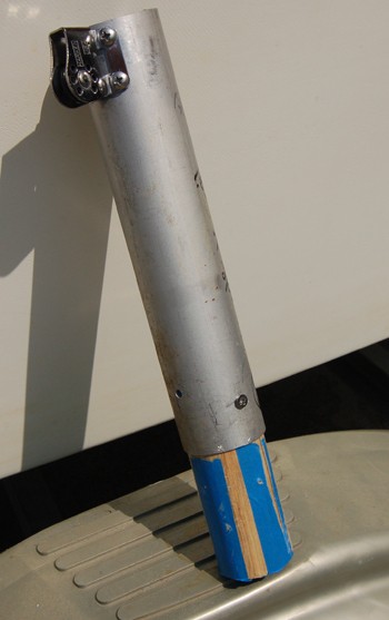

That's what Graham suggested too. Since my main mast extension needs to be removable, though, I was worried wood might swell if it gets wet and make the extension hard or impossible to pull out when I need to disassemble it to stow in the garage. Hence the aluminum collar idea. The scrap piece I worked up today, though was 2" o.d. tubing and a 6" spline of shaped Douglass Fir (plus a little blue painter's tape to snug up the fit exactly). Just judging by feel, it can't weigh more than a pound--probably less--so it didn't feel any harder to step the main mast. I was very pleased. With a hollow aluminum spline, I think it will be even lighter.

A quick update... after my experimental measurements, I settled on adding 12" to the main and 14" to the mizzen. I had my dad make a pair of 6" long aluminum collars (1/8" wall thickness) that just fit inside the I.D. of the top mast tubing to join on the extension pieces. They came out nice and light, albeit probably a few grams heavier than if I had used solid Fir. I have the masts all repainted now, too. Just waiting on a few pieces of hardware to upgrade some of my rigging controls.

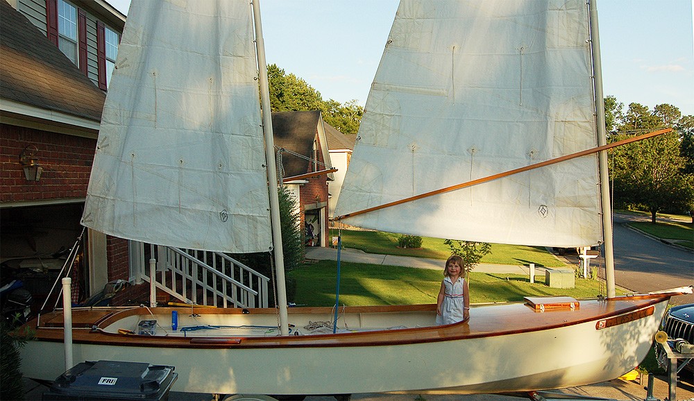

One last update on the mast extension project... I have installed the extensions and repainted the masts. The main came out to 22'3"L and the mizzen is 21'3"L. I have a lot more head clearance under each sail, and it looks much closer to the pics of other CS17's and CS20's I've seen. The added height changed the angle on my sprits, so I'm adding a second (higher) snotter attachment point to each mast as well. Now I won't have to warn passengers (especially kids) to duck every time we tack, and I should be able to fit a small bimini for some relief from the Georgia summer sun.
Thanks to all who offered comments and measurements!
