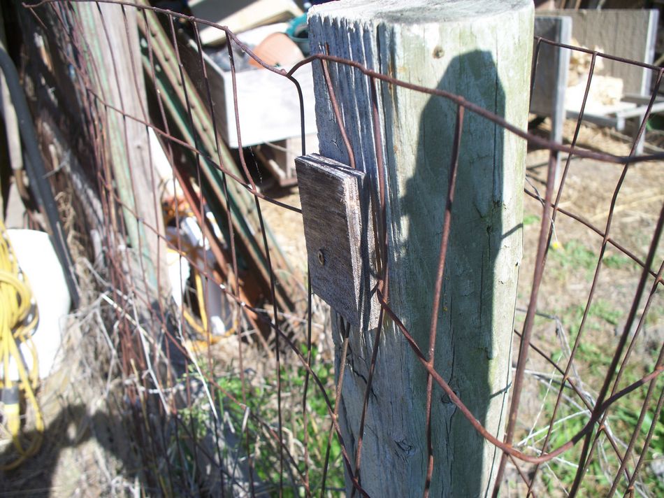

I don't think any plywood is made without a waterproof glue. So any plywood that is oiled or better can handle getting wet even though it is not designed for the purpose. Baltic Birch was never really intended for building kayaks. It is just that it is made so well that if treated it works out very well for a kayak that is dried out between uses.
