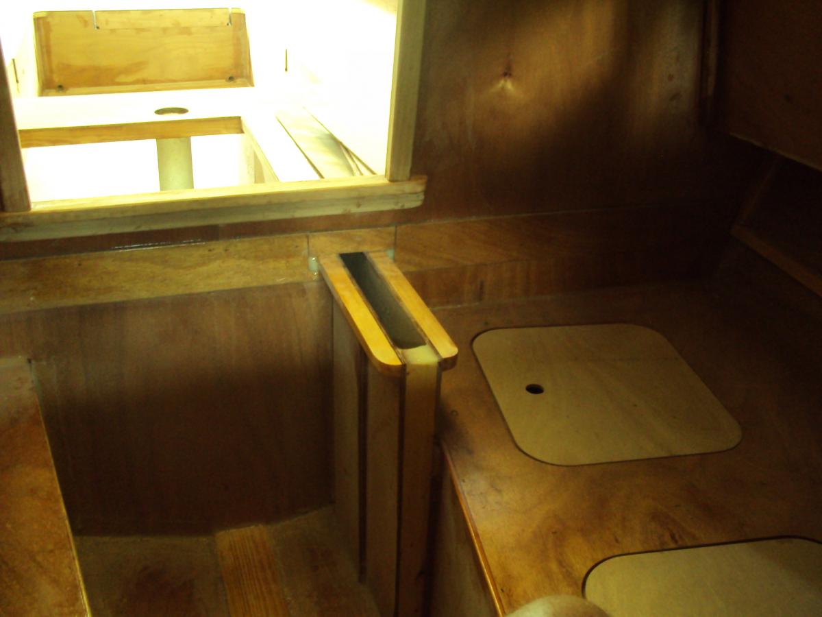

Chick Ludwig Posted August 29, 2012 Report Share Posted August 29, 2012 Oops, forgot one question about why cabin front isn't rounded. The flat cabin front is easier to build. This cabin is designed to be built in place on the boat where the EC-22 is pre-built upside down with laminated curves, then added on. I'll get some pictures of the c/b trunk offset and post them later. Quote Link to comment Share on other sites More sharing options...

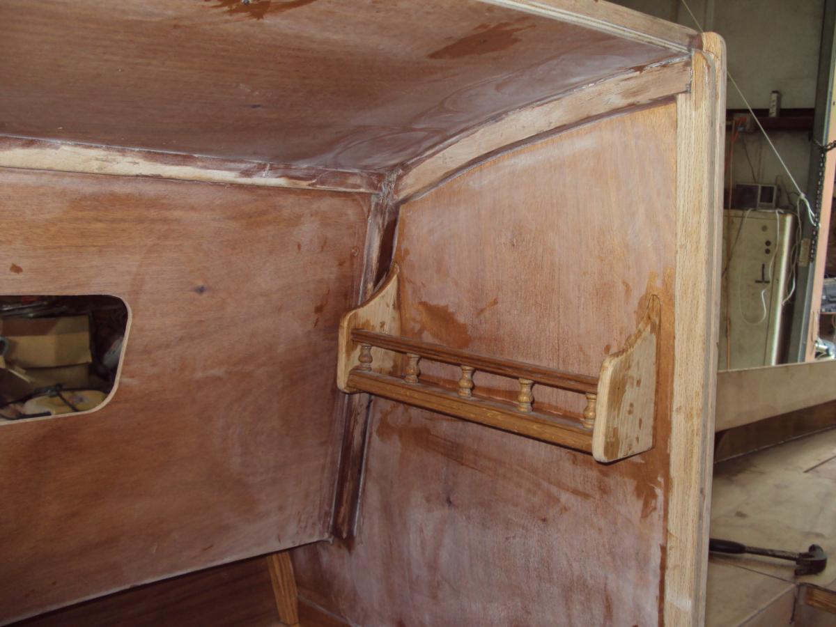

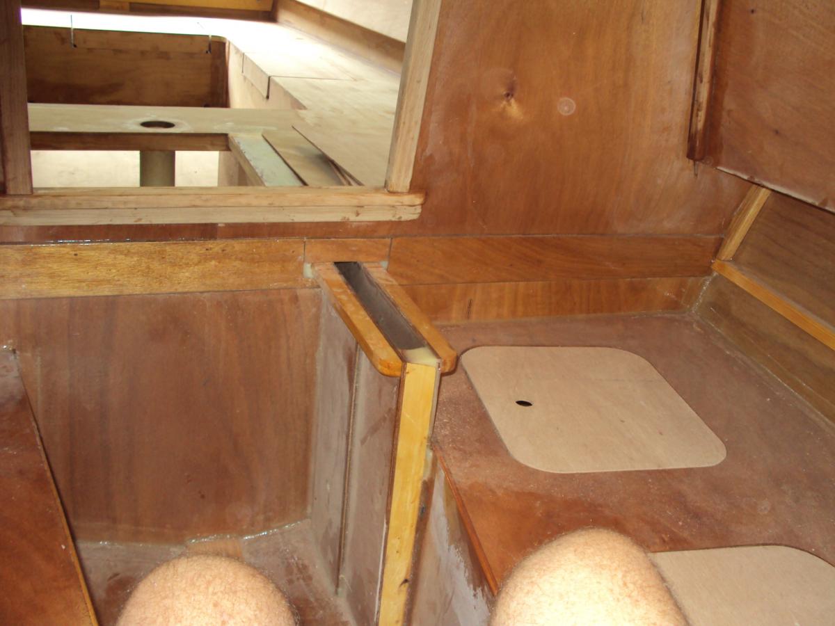

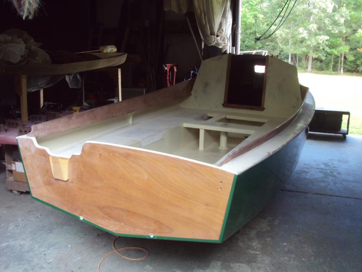

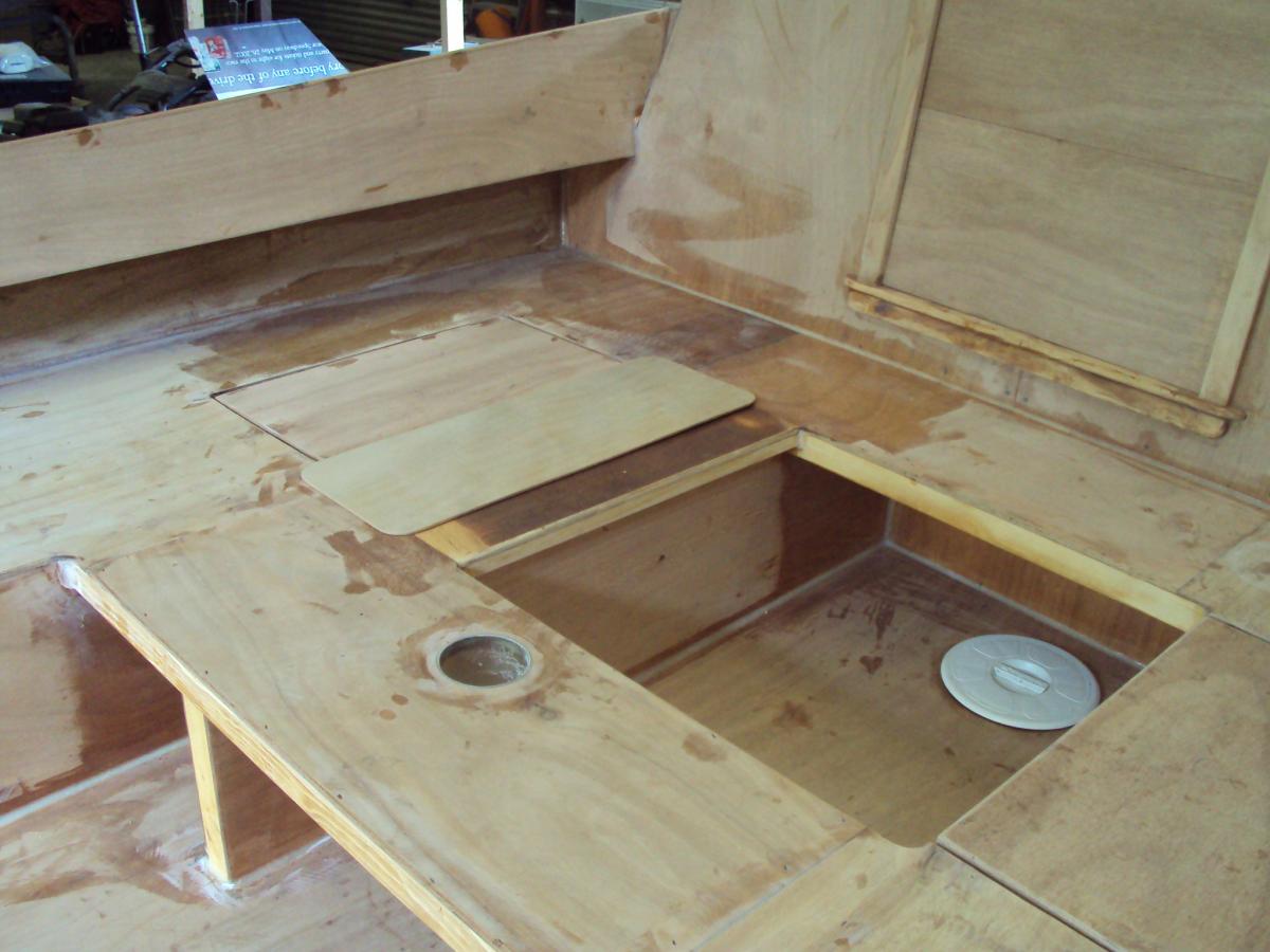

Chick Ludwig Posted August 29, 2012 Report Share Posted August 29, 2012 ]Here are some pictures of the c/b trunk. As you can see, it isn't very intrusive in the cabin. The cockpit views show it with and without a "cap---filler" next to the seat. This allows the use of the standard hatch in the seat. The last picture is of a shelf next to the companionway. Quote Link to comment Share on other sites More sharing options...
maligno Posted August 30, 2012 Report Share Posted August 30, 2012 How does one fill up and bail the water ballast? Is there a through-hull valve or drain? Thanks. Quote Link to comment Share on other sites More sharing options...
Chick Ludwig Posted August 30, 2012 Report Share Posted August 30, 2012 For the water ballast, there is a self-bailer to open to remove the water, and a thru-hull to take the water in. I'm using a standard boat transom drain plug for this. Access is through the round plastic port that you see in the picture of the forward end of the cockpit. The cockpit sole (floor) is above the water line, so you can't flood the boat. The water ballast is only needed when the conditions are rough---windy. It should make the boat self-righting from a full knock-down. We'll do inclining tests when the boat is finished, just to be sure. Quote Link to comment Share on other sites More sharing options...

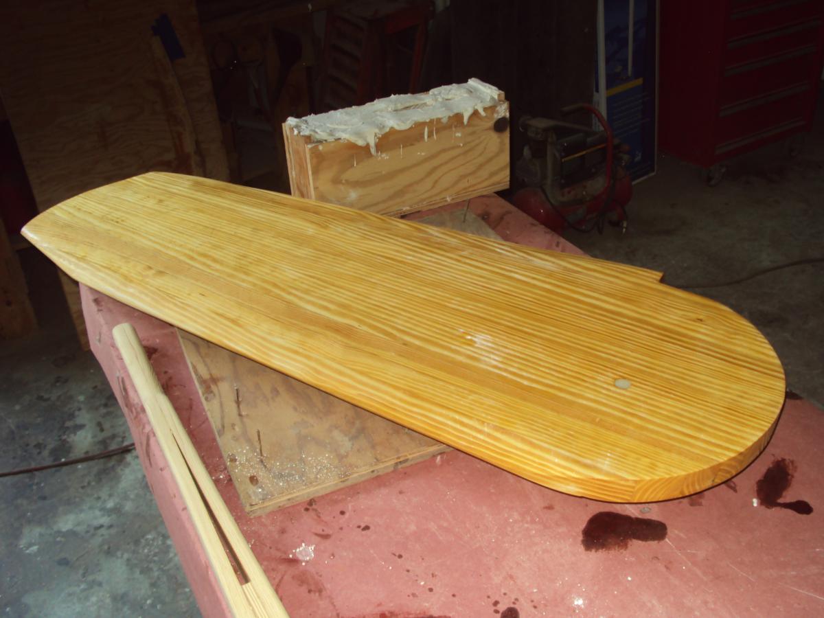

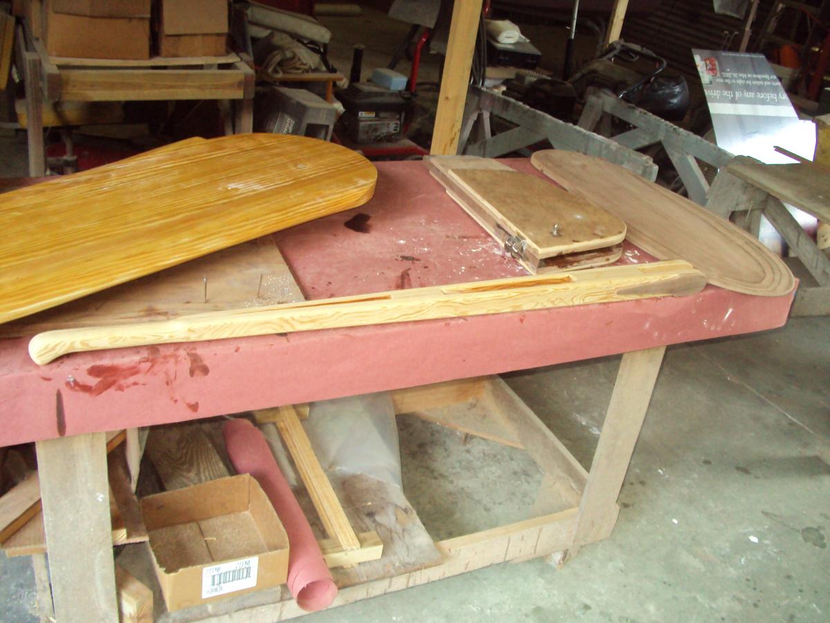

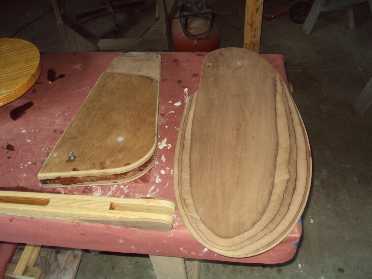

Chick Ludwig Posted September 1, 2012 Report Share Posted September 1, 2012 Here are some new pictures. The deck, cockpit, and cabin have been coated with epoxy. Lots of outgassing bubbles and "fuzz" to sand out. Then another coat of epoxy, then paint and varnish. Here is the centerboard with the tip cut off to use to make the plaster mold to pour the lead. Next to it is the mold. The other pictures are of the completed (except for paint or varnish) rudder parts and tiller. Quote Link to comment Share on other sites More sharing options...

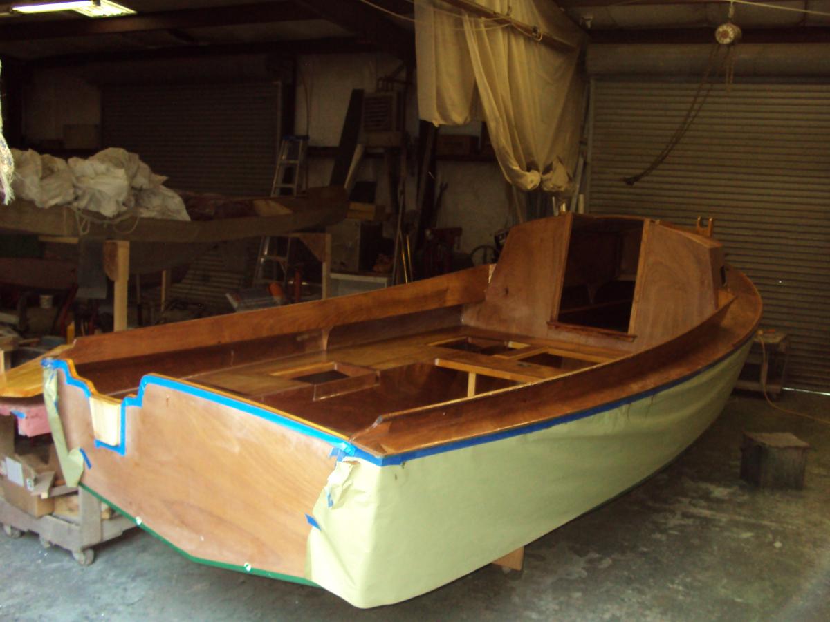

Chick Ludwig Posted September 14, 2012 Report Share Posted September 14, 2012 Well, all that sanding, masking, spray painting----looks awful, runs, thin spots, broken heart. Moped around for a day, then back to sanding, masking--- try again. This Devoe paint doesn't like me. That and I must have thinned it too much, and my glasses immediately fogged up with paint mist. Less thinner, no glasses (lousy vision, but at least I won't be looking through a paint film. Maybe I'll let y'all see a picture or two of the disaster before repainting. This time it's gonna be GOOD,,,I hope! 2 Quote Link to comment Share on other sites More sharing options...

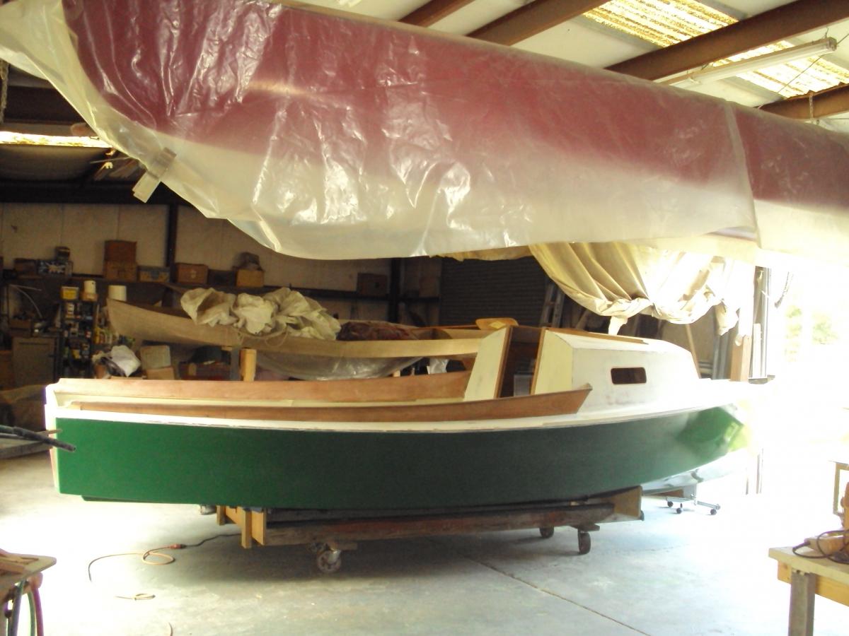

Chick Ludwig Posted September 14, 2012 Report Share Posted September 14, 2012 As promised---pictures of the disaster, also known as "the mess-up". But, masking is about finished---again. Paint Monday---again. Ya'll pray!!! Quote Link to comment Share on other sites More sharing options...
