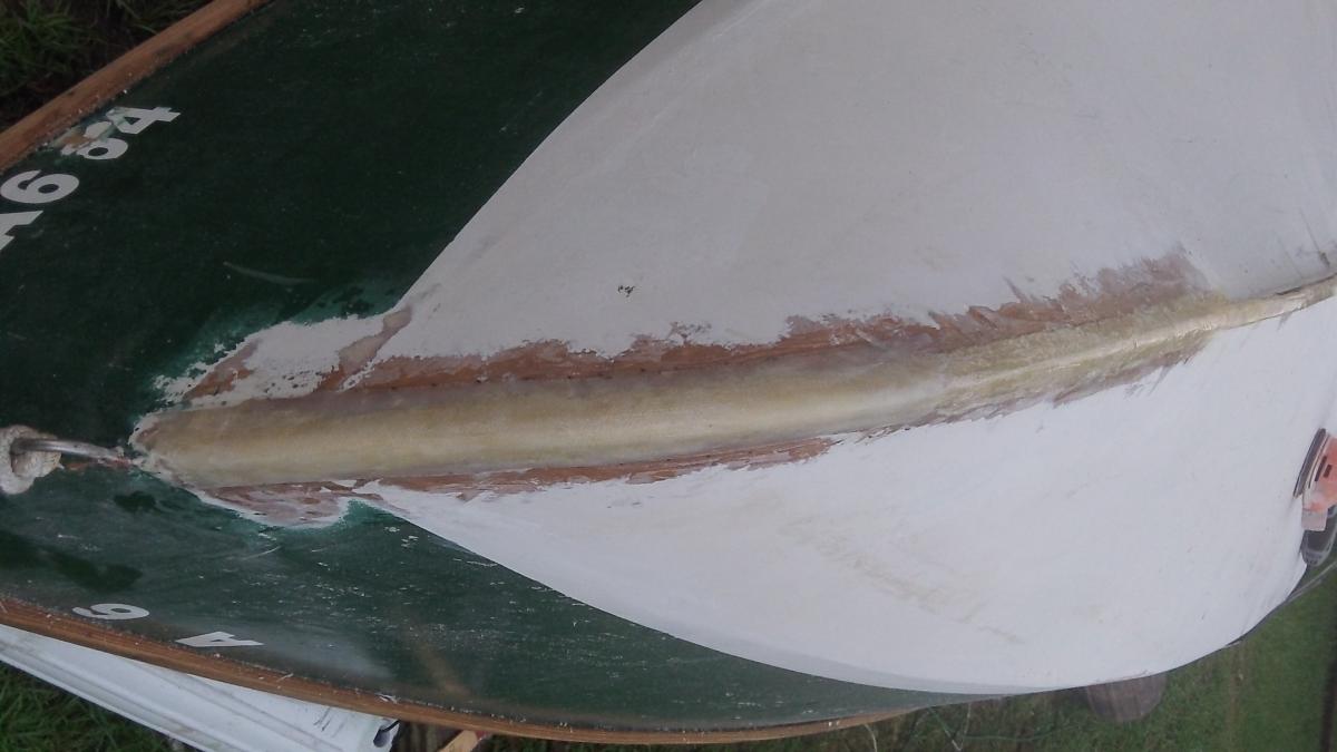

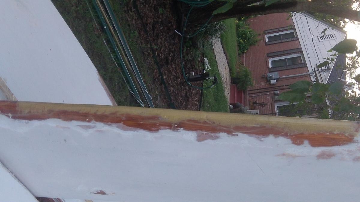

ecgossett Posted March 31, 2012 Author Report Share Posted March 31, 2012 What worked and what didn't for rudder/centerboard guards. The rope worked ok where it was applied, and in some cases the rope with epoxy applied has been eaten nicely but still protected wood. 1) Did not go high enough on forward ends of centerboard and rudder. 2) In some places the wood still got sandblasted clean above/sides of rope. Out of this I think I need to find a plastic or some other type of better guard. In those places where it went to wood it ate away several layers of fiberglass tape. It's not horrible or anything but needs a second look for future sailing. Quote Link to comment Share on other sites More sharing options...

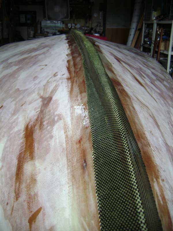

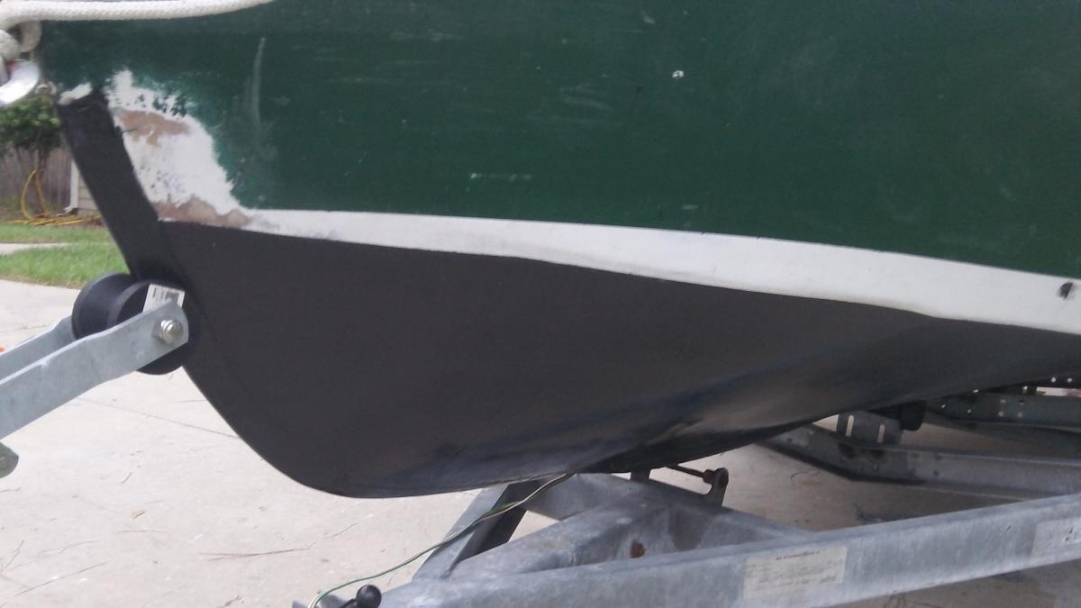

ecgossett Posted August 4, 2012 Author Report Share Posted August 4, 2012 Two layers of 6 ounce Kevlar on keel, and lower bow. Experimenting with the centerboard, I put two layers of kevlar on wet, then a layer of 3" 6ounce tape, it was easy to sand, no fuzzing up, and looked great. My bow I didn't put the fiberglass tape on, was fuzzy when sanding, had to cover with thickened epoxy and then massage glass tape into place over top of it to look decent. Quote Link to comment Share on other sites More sharing options...

ecgossett Posted August 4, 2012 Author Report Share Posted August 4, 2012 I tested the kevlar two layers, on a thin piece of plywood between piece of wood with a hammer.. I went to town "literally" and never broke or cracked wood and kevlar. Quote Link to comment Share on other sites More sharing options...
