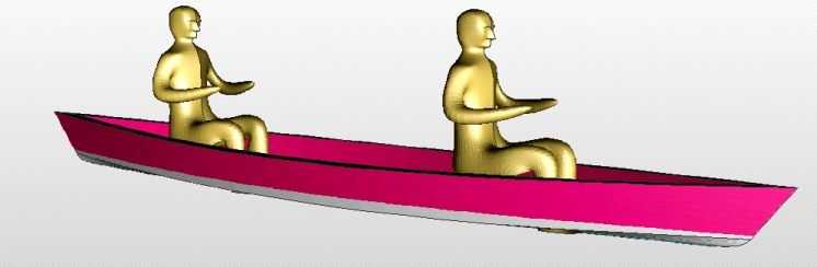

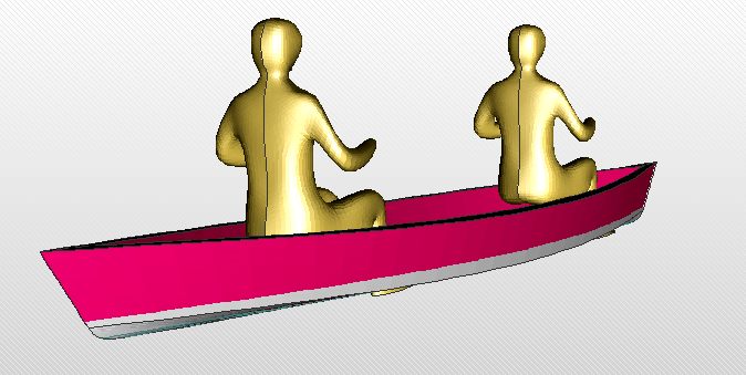

Loving the input I have been getting from you guys. Thinking a lot about the double canoe and I have been playing with the idea of a piroque. That is about as simple a boat as you can build and in fuselage frame construction it would be about as light as you could build one.
So I took that concept and drew this. I think it is still a piroque, but it would have fixed seats mounted in place that would/should eliminate the need for any thwarts, leaving the inside open. If you just put floors in at the seats, rather than full length, that would keep the weight down to a minimum
Tell me what you think. If you hate it, think it's ugly, tell me.
Just ignore that fact that Busters feet stick through the boat. :-)

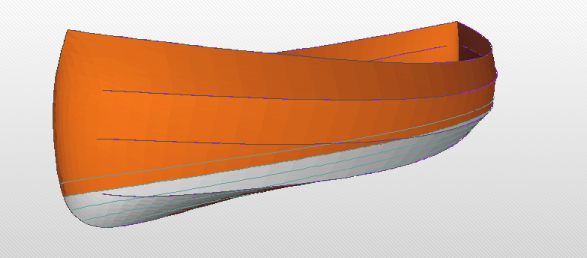

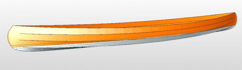

Just found another design I have had forgotten about. I really like the looks of this one. A two place canoe. Much prettier but not nearly as simple to build as the piroque would be. Nor as light.
This design has a some Tumble home which I have always admired. I built one boat this way and the frame warped out of shape and never attempted it again. I know understand where I went wrong and know how to do that.

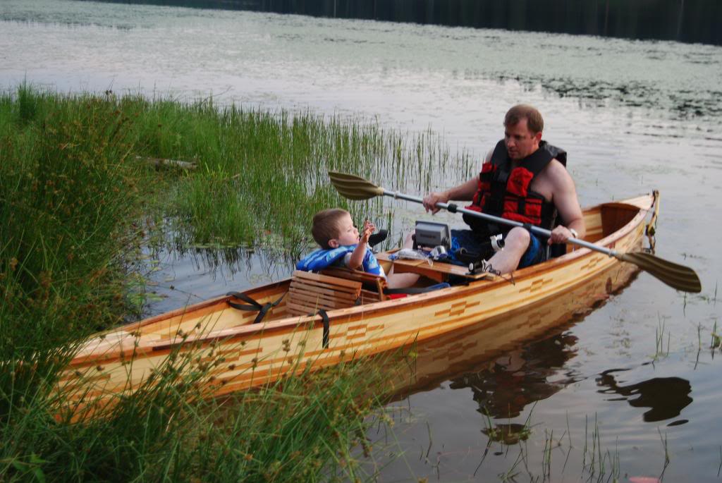

I like the piroque idea...of coarse I'm kinda partial being I have one and one on the way....My 15-32 SOF is about 31'' at the 3'' WL it ought to work as a tandem....
My first yak was 14' long with a 32'' beam and it was stable for 2 people...
http://i147.photobuc...tn_PIC_1346.jpg

The piroque looks awfully narrow for an open boat. You can call it what you want, but I would think it would be used in lieu of a canoe and I like canoes better. The canoe is pretty. If I were considering a 2 person open boat that is something I would look into.

Put a pair in the canoe and it looks smaller too. But the stability level is pretty good due to it's flatter bottom.
FWIW I agree the canoe is better looking, but the Piroque would be a super fast boat to build. Sort of a quick and dirty boat. There is a method to my madness. ;)

I like the canoe much more than the Flintstone Piroque ("Buster's feet sticking out the bottom"). I personally would rather take the time to build something that is much more pleasing to the eye. By the way, Jeff, do you have the Shad plans ready to release yet?

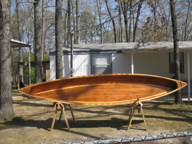

How is this for ugly...
Attached File  March2011FishingBoat038.jpg   102.69K   12 downloads
Attached File  040.jpg   130.69K   12 downloads

So what makes a pirogue different from a canoe?
I have to agree that #2 looks better. How about a top view of both of them? I'm not quite seeing how they differ in size or carrying capacity.
And IMHO you'd need at least one center thwart for portaging. (At least, I'm thinking about tripping with a canoe)
