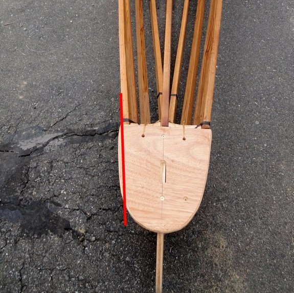

I have been looking at something and hesitated to say anything. I don't want to look like I am picking on Jerry! This morning I realized I am not doing Jerry or any future builders any favors by not pointing this out.
When I looked at the photo of the frame I instantly spotted a couple of thing I would suggest you change.
First thing I notice is that the fantail is wider than the stringers, or at least they look it in the photo. When I drew the plans I left it large so the builder could fit to to the frame. Assuming the photo is right if you don't trim this you are going to have a big bulge when you skin it. I strongly suggest to everyone, pull something like an t-shirt material over the frame and check all the intersections for bumps and bulges before you skin
Also, I drew a straight line along the stringer over the fantail. You can see how the fantails sort of bulges out past this imaginary line. I think the boat would look much better if you trimmed this so that it makes a smooth transition and if you stand in front of the boat and look back the boats lines 'flow' smoothly. You could take a batten and bend it around to get a 'fair' curve.
In Jerry's defense, I have realized that builders have problems in this area. Over time I have realized that I can actually draw these parts to the finished size with good results. As I can I am going to back and revising older plans like Long Shot.

Jeff: Don't worry about picking on me. I have a pretty thick skin. More importantly, I know I am just a beginner. Building this boat is my most complex woodworking project to date (certainly in terms of size) and all advice and critiques are welcome. It is the way I learn. I have been using an old t-shirt to stretch over the boat and did notice the bulge at the stern but assumed that was normal. Your suggestion is very good and I will reshape the tail to fit the stringers. Thanks for taking the time to comment, Jeff. I really mean it.

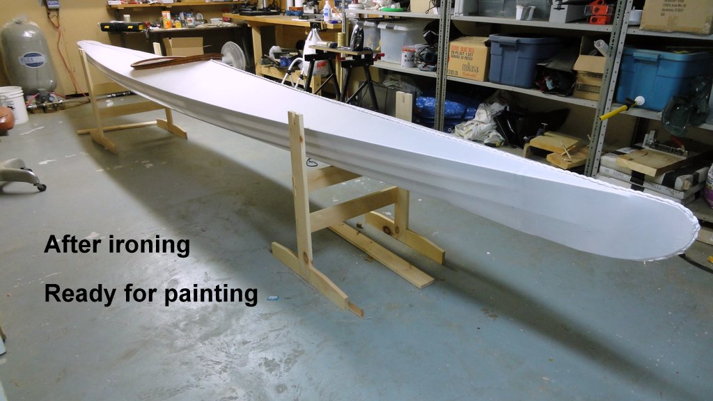

Hi everyone,
Well, I managed to get a great deal done this month, though not as much as I had hoped.
For those interested, I did a major update to my blog today with lots of pics.
http://yoyobuildsanakyak.blogspot.ca/
For those not interested, here is some eye candy.
Looks like all that's left is to paint it and see if it floats!
