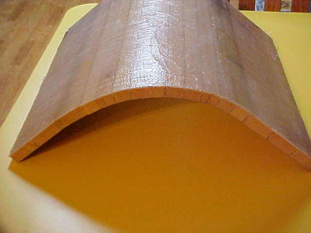

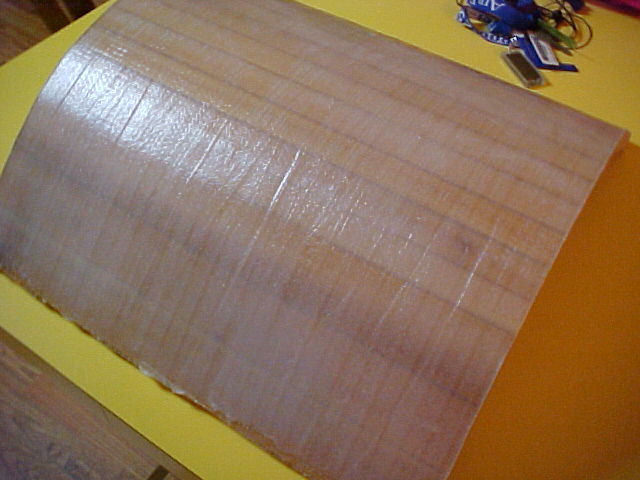

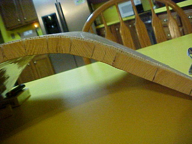

Scott Dunsworth Posted September 9, 2011 Report Share Posted September 9, 2011 I have done a little test of strip building, for my own education. I first cut two plywood temporary frames in a nice curve as a chine would be. Then I striped it with 1" strips around the curve, and 2" strips on the flatter areas. I used 11/16 cypress to mimic what my build is going to be like. I wanted to try the system that a professional builder in OZ. described. He strip builds all boats with a very thin gap in between the strips. After the boat is completely striped he coats the whole hull using a lightly thickened epoxy. He relies on capillary attraction to fill the voids. My test piece looks very promising. I have made two slices so far and found no voids. After I do a few more tests on my strip model I plan to slice it every 1/2 inch to further check the process. If I can build this way it would save days and days or weeks of labor, not counting the epoxy savings. I wanted to check the weight of what I will be building with, per square foot. My three sq. foot piece weighs exactly 6 lbs. So this means I can roughly calculate the bare hull weight minus the cabin and deck. It is covered with 20 oz plain weave and 12 oz on the inside. I don't know yet as to what Graham is going to specify, but this should get me in the ball park for the tests I wanted to do. Also I want to know how much buoyancy per sq foot the bare hull itself will contribute to the positive flotation, I would like to achieve. Even if the boat is swamped as long as its not sunk is got to be a good thing. I watched a u tube video of a fiberglass sloop sink in a matter of seconds, something like 15 once it was heavily swamped. About two minutes total. If my boats going down I want time to at least save the rum and grab the life raft. I calculated that a lead ballast of 2500 lbs would need 37 cubic feet of foam just to float it. Its not going to be easy to get enough foam into this boat with all of the comfort equipment that's going in. But the decks, cabin will all be foam cored. Maybe with everything working together she may be swamped, but NOT sunk in a major calamity. I'll post a picture in a few minutes of my strip model after my camera charges up. Scott Quote Link to comment Share on other sites More sharing options...

Scott Dunsworth Posted September 9, 2011 Author Report Share Posted September 9, 2011 The reason for this test for me was, to check multiple things. I used about 3 fluid oz. per square foot to fill the gaps. I do have to wonder how much epoxy will be wasted mixing individual batches for each strip. ( Roughly 104 strips) Filling the gaps and wet out the wood for 448 square feet of hull should use about 10 gallons. About 7 oz. per square foot to fill the weave inside and out. Which I'll have to do no matter how I plank the boat. Anyway you look at it a boat this size is going to use a lot of goo! Thanks for the comments. It's always a good thing to hear other peoples thoughts on things, it helps to think about things in a different way. Scott Quote Link to comment Share on other sites More sharing options...
PAR Posted September 9, 2011 Report Share Posted September 9, 2011 I agree Wes, I've used thick strips (1"x1.5") and the square edge strip is easy to knock a rolling bevel into, once you get a handle on it. The turn of the bilge the gaps open up a bit, but with a plane or even a rasp, surprisingly accurate joints can be quickly made. As you point out, it's fairly intuitive after a while. The last big strip hull I did was a 25'er with 3/4"x1.5" strips over most of the hull and 3/4"x1" in some areas where twist or bilge turn was substantial. Because the gaps were relatively tight, filling them didn't require much goo. Scott, let us know about the results of you 1/2" slice and dice of your samples. I'd be curious what you find and it's nice to see some testing, as this is a hallmark of the backyard builder. Quote Link to comment Share on other sites More sharing options...
