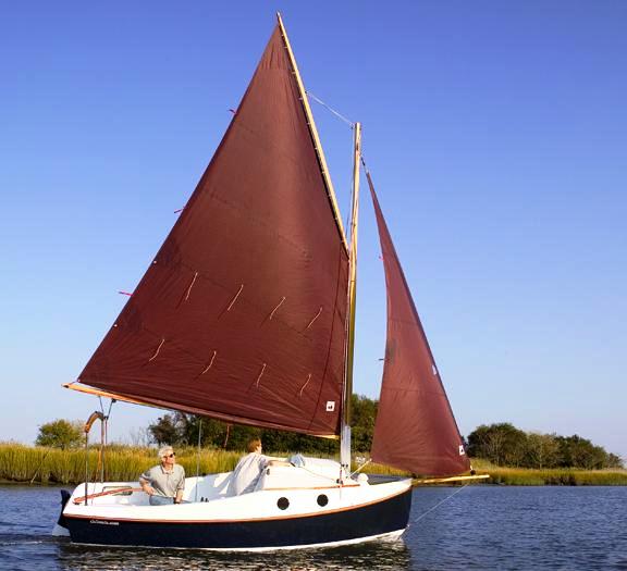

Before I found the weekender I was going to build CLC Pocketship. It is a beautiful little bleach bottle type boat.

I really like the look of the CLC Pocketship. Clean and elegant in its simplicity. With mostly stich and glue construction this would be a good first boat or a great second project after building a Weekender. I still think building a Weekender is a great way to get into sailboat building. You can learn a lot and not have to deal with monster steel plates on a pivot. As a carpenter's son I (of course) did most my lifes work with metal. I know how hard it can be to manhandle a big steel plate.
If I were smart (as a novice boat builder and sailor) I would build the CLC Pocketship. But, I've fallen in love with the gaff rig and a skipjack hull. And there are darn few skipjack plans for the home builder. And all of them are of traditional designs and construction and probably over my skill level. Except for the Weekender. And that is her appeal and her niche in boat building, and why she is so popular with first timers. I've read lots of forum strings bad mouthing the Weekender design but guess what? She's fun to sail. Thanks for opening another door for me Frank.
