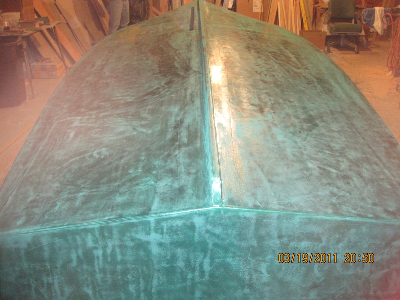

wkisting Posted January 28, 2011 Report Share Posted January 28, 2011 I did 6 oz. on the bottom and sides of the hull, overlapping at the chine so that there is actually a double layer of 6 oz. covering the chine and about 3" to either side of it. I did 4 oz. on the deck. In my experience, Okoume is fairly soft and prone to indentations or scarring, but this is considerably reduced by a layer of 'glass (merely epoxy saturating the Okoume helps, but adding a layer of 'glass is noticeably more dent resistant). The 4 oz. was plenty to make the deck nice and scuff resistant, yet still easy and attractive to finish bright/varnished with no weave showing. The 6 oz. on the hull has stood up to abuse nicely. The chines and keel take the brunt of the abuse, so I'm glad I doubled/overlapped the 'glass at the chines (we used a protective strip of stainless on the keel). That's the layup I recommend on our experience, but as others have noted, you don't technically need to use 'glass at all. Quote Link to comment Share on other sites More sharing options...

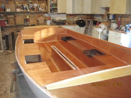

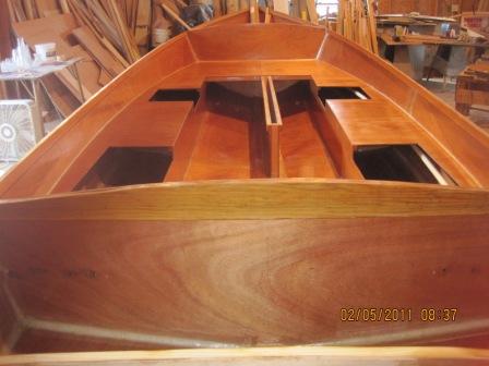

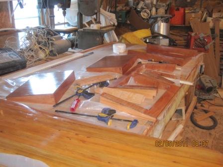

Twetmore Posted March 23, 2011 Author Report Share Posted March 23, 2011 I haven't updated in a while so I thought I would upload some pictures for everyone. Hope you enjoy. Quote Link to comment Share on other sites More sharing options...

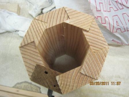

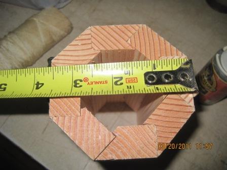

Twetmore Posted March 23, 2011 Author Report Share Posted March 23, 2011 I used wood the entire way and actually I built the mast this last weekend. I used some really nice 2x material that I found at the lumber yard and let it dry inside for almost 8 months. I ripped the 2x down to 3/4" strips which gave me a 1-3/4"x3/4" strip which is pretty close to what the plans call for. Then I used an 8 sided birdsmouth router bit to birds mouth one side of each rip. Finally, I setup a jib for my table saw to rip the taper of 3/4" at the top down to 1-3/4" at the bottom 6' per the plans on the non-birdsmouth side. The jig was just a 2x6 set tight against the fence and blade and nailing the rips onto a pre-marked angle so that all were uniform. Finally, I put glue on all birdsmouths, fit 4-5 pieces together, inserted the blocking, and slipped the last couple of pieces together. Then I used some nylon webbing straps as tourniquets to pull the mast tight together and taped it with re-enforced parking tape. Pulling the mast together really takes 3-4 guys to do it right as well as many of the other tasks since the wood is so long. I chose to use gorilla glue as a dark resin glue was recommended on several different websites that I looked at. I am comfortable with gorilla glue, it is waterproof, and it has greater strength then the wood, as does epoxy. I could not believe how easy this whole process turned out to be in the end and would definitely recommend it to others. Then again, I still have to sand the mast smooth and we will have to see how they hold up. I haven't been home since the masts have been completed so I will post some pictures next time. Quote Link to comment Share on other sites More sharing options...

hokeyhydro Posted March 24, 2011 Report Share Posted March 24, 2011 Thanks for birdsmouth info. I built a 22' birdsmouth mast but only tapered, after glue-up, the top 7 or 8'. Did that with a plane. I considered your method, set-up jig on table saw, for my next couple masts. Also considered a clamp/jig gizmo to run several staves at once through my surface planer to shave the taper, or just go old school and plane the taper with a hand plane. Have to think on it and sketch a bit. I rolled up the 22' mast myself. Arraigned all the staves edge-to-edge on duct tape strips spaced about 6' apart, slobbered WEST epoxy on them, then filled WEST on glue edges. Near the middle I rolled the staves up in a bundle and they all seemed to click into place. Duct tape sorta held in it together while I took a few breaths, then I used cable ties (Zip ties)every few inches to clamp `er up. Cleaned as much goo off the outside as I could and let it cure. The staves were 14mm X 28mm which produced a mast about 70mm Diam. It is a stayed mast, unlike the free standing Core Sound masts, so I just thinned the upper section to get a taper. So far the rig has survived a 20+ knot blow when it got caught in a pre-storm wind burst. The little Catamaran was hauling tail in that blow! Quote Link to comment Share on other sites More sharing options...

Twetmore Posted May 13, 2011 Author Report Share Posted May 13, 2011 So I framed in the decks last weekend and at the aft I put the hatch in the center thinking it would be easier to access things. It just dawned on me that it is laid out to the side because it will conflict with the rudder...I will have to reframe the area. Also, I would appreciate any input from anyone that you might have on my mast question about the flex. Thanks, Tom Quote Link to comment Share on other sites More sharing options...
