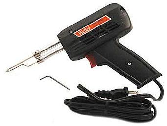

A variant on "shorting the wires with a 12v battery":  If using a soldering gun,  you can remove the 2-pronged heating element and insert instead the two ends of the wire so that you let the wire play the role of heating element.  Squeeze the trigger to get a red-hot wire.  If you don't need to "nuke it" red hot,  you can just hold a hot soldering iron against one end of the wire as you and Peter mentioned.

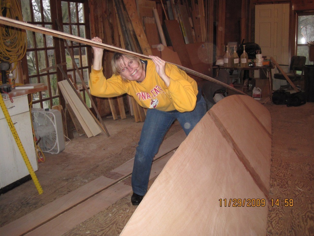

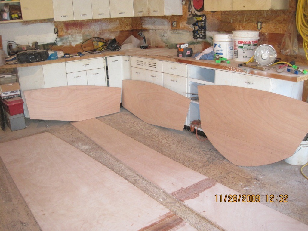

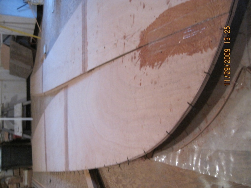

Jeff,

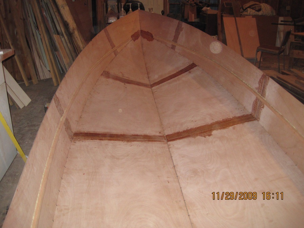

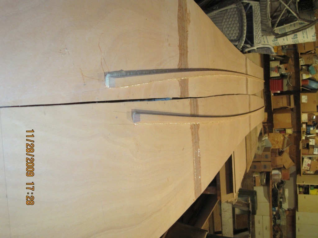

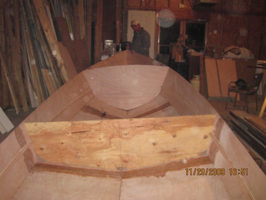

Here are some pictures.  Just FYI, the one that you see with the stringer and foam on the sides is because I used Gorilla glue to attach it.  At the time I had total confidence in it because of its strength properties and it is waterproof but I decided to epoxy fillet the underside of the stringers just in case.

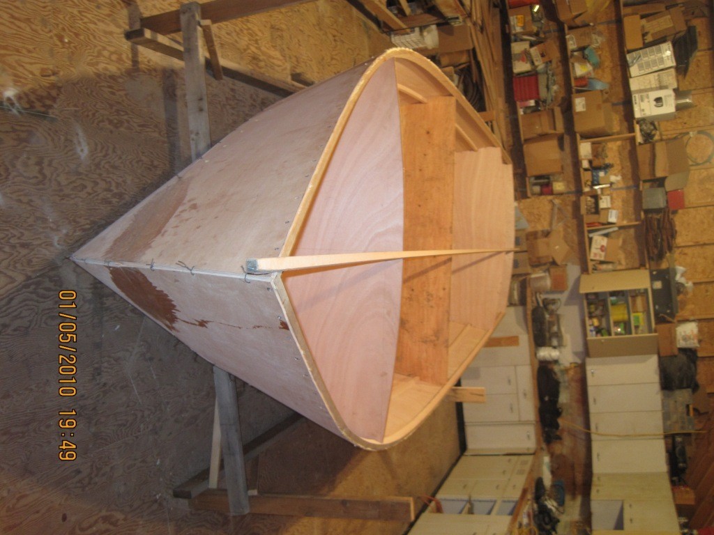

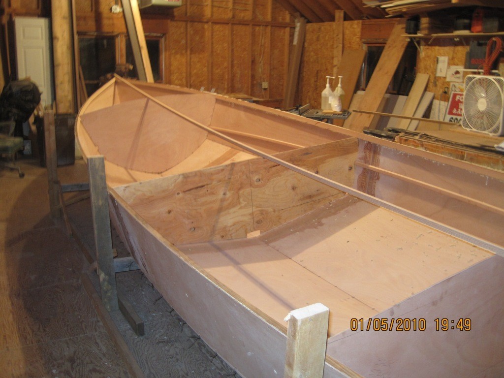

I am installing the 4 bottom stringers aft of the forward bulkhead.  The outer stringer is missing the bottom of the boat by about 1/4".  However, I was able to find some good posts about this and it looks like I should scribe this stringer to the bottom.
