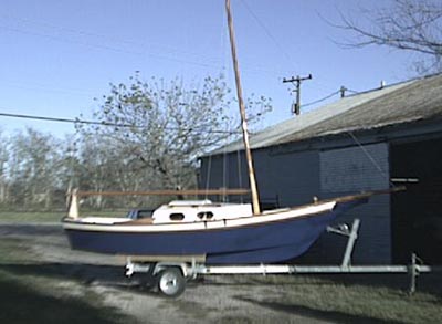

Charlie Jones Posted February 19, 2006 Report Share Posted February 19, 2006 When I built the Weekender I did, I went to a local power boat dealer who sold aluminum boats. Bought a small tilt trailer from them, had them change the short bunk risers for longer ones and reused the same bunk boards. Then I used the centerline rollers for the keel to ride on. Balanced the boat correctly over the wheels for a good tongue weight, then moved the winch stand to the correct location. Worked very well. I just looked into my records and that trailer new retailed for 800. Pic is about the best one I have that shows the trailer. The owner said it towed like a dream. Oh- and by the way- when we built the trailer for our 21 footer it cost us 400 bucks just for the steel, not counting axle, hubs, wheels, tires, winch stand, bunks, etc. And steel has sky-rocketed since then. Quote Link to comment Share on other sites More sharing options...
