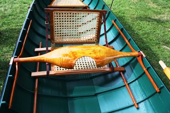

The right place for your yoke is at the center of gravity (CG). So, as Jeff suggests, pick up the boat upside down and see where it balances. If you will be stowing paddles and other gear in the boat as your portage, lash those in place when determining the CG. If the place you determine is clear of thwarts and not otherwise in the way, you can permanently attach the yoke there, as is done on many canoes. If the yoke would be in the way, rig up a removable yoke as is standard on Adirondack guide boats. Guide boats have wood cleats on both sides with U-shaped slots where the ends of the yoke fit. See the attached photo as an example.
Fair winds, Andy

As for locations I just walked out and looked at mine and because the seat is so close to center on this boat I think that two thwarts will work better. And I think your yoke is probably going to be in the way of the seat, so you will probably want it removable.
