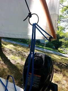

I think a pretty good solution to this was discovered by David Jost? Here is his blog
http://jostboats.blogspot.com/
He used a ring that takes up the mizzen slack during a tack when the sheet goes limp so that it can pass over the outboard. While sailing the sheet hardens up and the bungee is just along for the ride. Another tip is to make a custom stop block for your outboard so that instead of it being tilted all the way up to the built in lock position you can only tilt it up enough to let the lower unit and prop clear the water. This cuts down on the prop fouling the sheet since it's much lower down but still out of the water.
-Alan

Thanks Dave F, but rowing long distances against the wind really sucks! Thanks also Alan for the pics, I will try David J's method (too many David's here?). I did a trial fit today and used a carabiner instead of a ring so it can easily be detached. I will try it on the water ASAP.

Don, I'm thinking (hoping) that the bungee and ring will simply ride up the sheets and hang loose, since the tension in the fore and aft direction is no longer there. It would be interesting to hear from David Jost on this if he is still following the forum. I assume that the ring finds its natural position such that when the sheets are close hauled and going about the ring rides to the position where the sheets are at an angle like in the pictures above.

I think David's setup is the one I remember.  If there's too much tension it may be a pain when you're sailing in very light wind but using a carabiner will allow you to take the bungee cord out of the system easily.  Experimentation with the amount of tension and the attachment position should be a fun way to spend a day on the water (I'd try it if I still had a mizzen). :)

I use a custom block like this on Summer Breeze. The sheet doesn't catch on the lower unit, but does catch on the power head of the motor. It also catches on my boarding ladder. I like David's idea and will try it next time we go sailing.

sorry for the delay.  Just noticed the post with photo failed.  Here is a link to the blog http://jostboats.blogspot.com/2015/09/pleasant-bay-and-simple-rig-adjustment.html
2 photos show the points of attachment.  No issues,  when closed hauled, the ring barely impacts the sheet, when on a run. the bungee keeps tension on the sheet so that it runs forward of the upright motor.  No downside that I can see so far.

Hmm, that seems to do the trick. Thanks, Dnjost!
