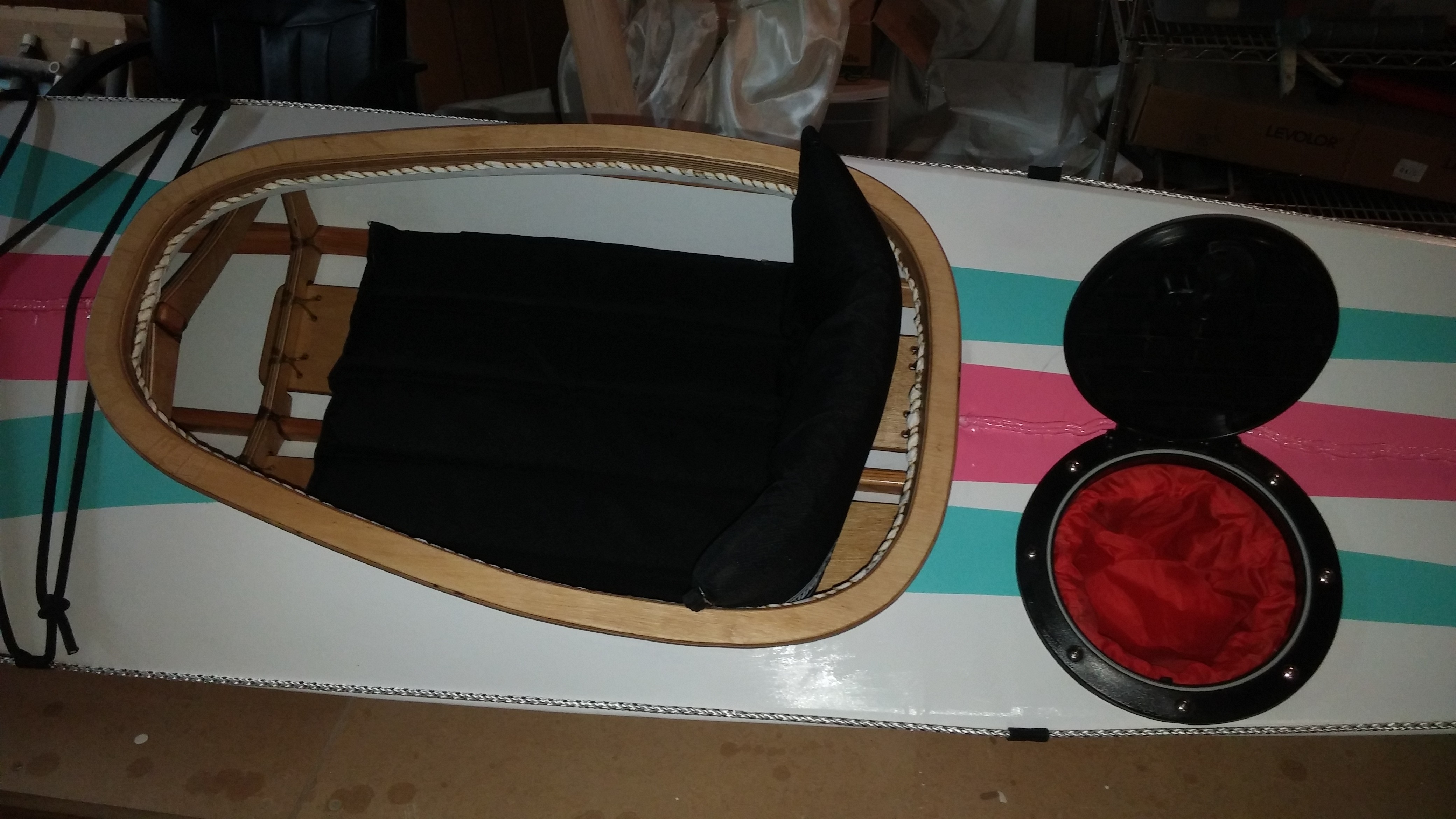

To Abyssdncr: I see no drilled holes or stitching on the outside of your coaming. Are you saying you cut a fourth layer and attached it under the skin?
Link to comment
Share on other sites
No 4th layer.  The lip is covering the holes appearance from the outside, but you can clearly see the fabric and stitches inside the coaming.  I'll take a better pic tonight.
