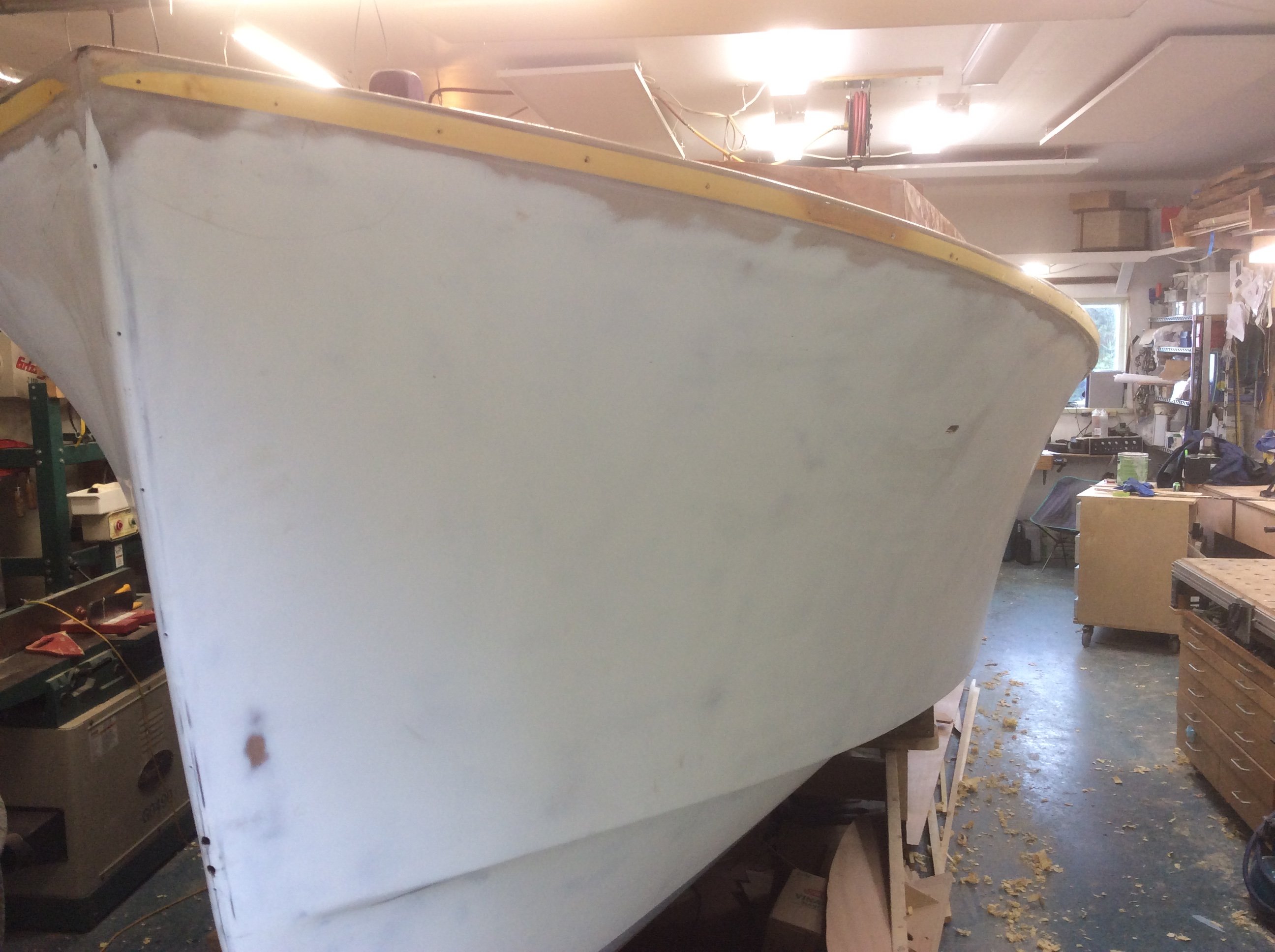

Hi All,
It has been a long time since I sat down to share my progress on Rosie.  The decks are on, sheer line tweaked and foredeck faired to look correct, anchor well in place, some ceiling added in the forward cabin and tank coffin compete. I also added a strip of wood with a rolling bevel to the forward 16’ feet of the sheer.  This will make the Sapelle rub rail easier to bend in place since it is no longer needs to be twisted into shape.  The price we pay for a beautifully flared bow. There is floatation in the bilge areas which may have been a waste of time.  Hope never to find out. I will begin the interior framing very soon. Need to make some decisions on the layout. Things are moving along.
Ken

Hi All,
Making a bit of progress on ROSIE these days.  Somehow managed to have a cardiac arrest a few weeks back which slowed me down a bit.  Pretty close to normal these days and spending time in the shop.
I have the cockpit seating and pilot house “furniture” roughed in.  The fuel tank is installed and mostly plumbed. Love seeing the interior taking shape.
Ken
