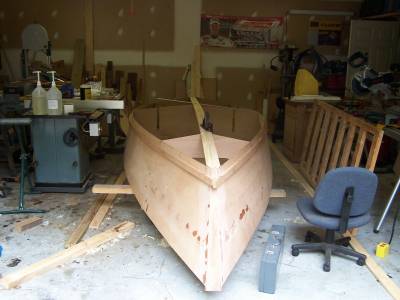

I am building the BRS17 that Graham has just done the first kit on. So far everything has fitted together very well. I have contacted Graham and told him I am ready for the bottom to be cut. The CNC scarf joints are great and saved a lot of time. see picture below Phil
