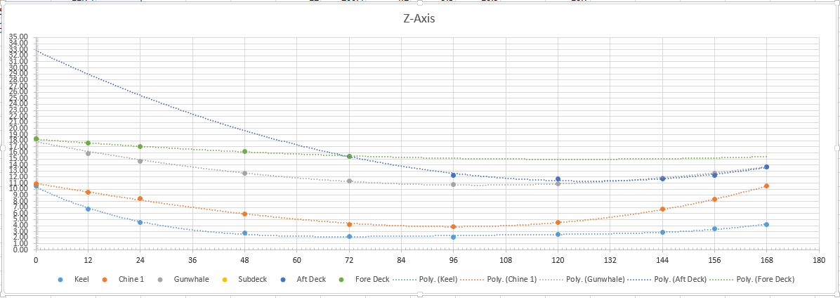

  2. I'm planning to buld a Greenland-style kayak using the fuselage technique. To try and determine the offsets, I measured a diagram of the boat that had "slices" roughly every foot and entered the heights and widths into Excel (one sheet of X-Y and one sheet of X-Z data). I then plotted them in an XY plot and added a curved trendline. The resulting curves look pretty accurate an I think I can extrapolate offsets from them. So, my questions are: 1: Has anyone else tried this? 2: Does it sound like a valid technique? Thanks. Mike
