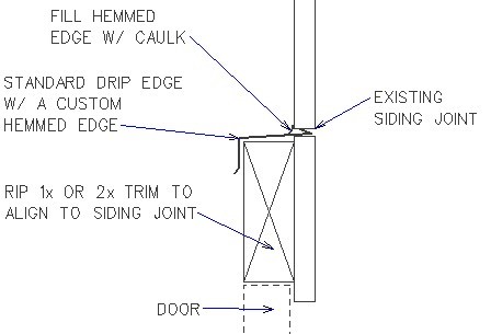

Greg We're on the same page. That's basicly what the drawing abv. is. I just wasn't sure if that was a butt joint or not. The normal drip edge on a door also has siding over it which provides a counter flashing of sort, with T1-11 you don't have that luxury. If you can get the drip edge back past the face of the T1-11, idealy like you're upper joint with a vertical leg, you're 2 steps up. It is a pain to make the extra cut, but just think of the T1-11 behind the head casing as a spacer. Good rule of thumb for all flashing details: If you can make the water run uphill 1" or more before it gets inside. It probably wont leak, but....
Greg Here's a detail for the top of the doors in the gable endwall. It looks like there is a T1-11 joint +/- 5" above the doors to insert the drip edge. If not a 1/4" deep sawcut would suffice but not work as well. Note how the hem is bent up so it wedges tightly into the joint. For the small amount of effort, this would add considerable life to the doors and jamb casings.
