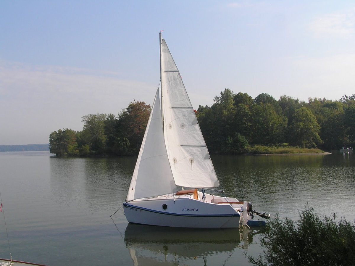

"Primrose" my No Frills 15 has not been seeing the time on the water she deserves since I launched my Core Sound 17. She was very solidly built by me a professional remodeling carpenter and was around boat number 8 or 9 that I have built over the years as an amateur boatbuilder. Boats built include a Vacationer, Core Sound 17, multiple skin on frame kayaks, a mirror dinghy from a 30 year old kit, 6 hour canoe and others. All meranti ply and 10oz cloth hull. Sails look brand new, hull needs a touch up but in excellent condition, interior upholstery is in great shape. Sleeps two, very sea worthy, sailed on Lake Erie and trailered down to FL for two BEER cruises. I will include pictures taken this past fall before she was covered for the winter (appears there was wash water on my camera lens in case your are wondering about the distorted bits). I will also include a link to the orginal building pic album. The core sound is my go to and I am currently building out a camper van so she has to go. Feel free to contact me for additional details. She is in the 44134 zip code for anyone googling location. No Frills 15 build Thanks for looking, Jim

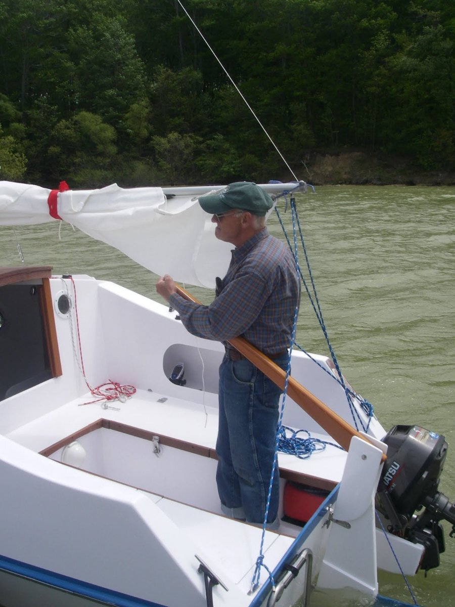

Hello All, Its been a couple of years since I checked in. This will be the my 9th season with my CS and I am thinking about an easier way to step the mast (more the main and not as much the mizzen). Lifting the mast strait up and dropping it into the step while standing on the fore deck becomes less safe each year and I am not interested in modifying the fore deck and installing a well with a pivoting tabernacle. In years past I have seen some of the deck mounted guides and was kicking that idea around when my very creative boat building buddy had this idea, he didn't have all of the details in his head but when searching the web we stumbled across this picture on Russ Livingstone's web site. All though not exactly what we need the concept is there. A small knuckle at the bottom of the mast to catch the top of mast tube and guide the mast into the tube as it is being pivoted/lifted and would drop into the mast tube. Any thoughts on the idea would be greatly appreciated. As always thanks in advance for your help.

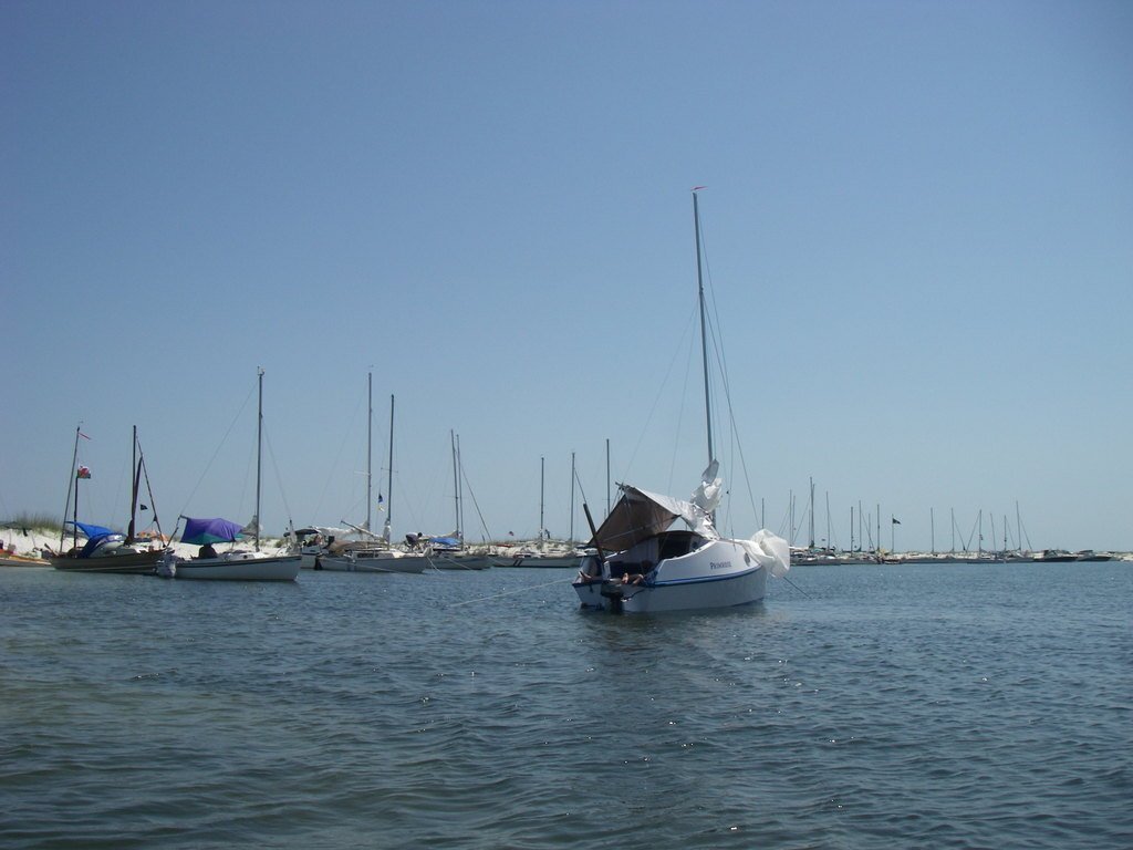

Sun shade progress This is what I would consider a picnic canopy or hanging out at the anchorage sun shade. Certainly not to be used underway. Still working out lines and misc. shown below is a pic with it at rest for overhead sun and then another pic with it under tension for side shade, you can almost pull it to the deck if needed. The loose flap forward was left to go around the mast and eventually attached to the camper to fill in the void between the camper and the mast where I am sure 90% of the sun will fall in a strip across my napping face.
I thought that I would start a new thread on my camper top build. I started with an inexpensive bimini from Amazon. https://www.amazon.com/Oceansouth-Bimini-Available-Three-Different/dp/B013ASEG9E/ref=sr_1_1?srs=8055815011&ie=UTF8&qid=1491246347&sr=8-1&keywords=2+bow+bimini I have the Bimini installed backwards (on purpose) so that it folds forward. The secondary leg was shortened by about 10 inches as the frame is not centered fore and aft in the forward cockpit. I did not center the frame as I wanted to repurpose the forward oarlocks for the deck hinge. The removable deck hinge is screwed to a riser block. The block has a carriage bolt dropped through the center of it and is wing nutted under the deck. This is kind of cool as the bolt acts as a pivot point for the hinge and gives you the ability to accommodate some twist for alignment. The grey fabric hanging from the blue top (this bimini only comes in blue) is an apron piece that I am sewing to the top for attachment of the side wall curtains. The corners are not completed in the picture and were a major undertaking as you have to be able to sew in 3d, if you follow my lead on this project you will need the help of a very good friend as this can get a little frustrating and intense. They are currently finished and I will have to get some pics posted. So far so good I will keep you posted. I also just completed a sun shade for the aft cockpit and will post some pics, that is a more floating assembly and more of a fly. The above bimini would probably work in the aft cockpit if you don't mind all of the addition hardware but it would fit. More progress pics as they come available. Thanks, Jim
