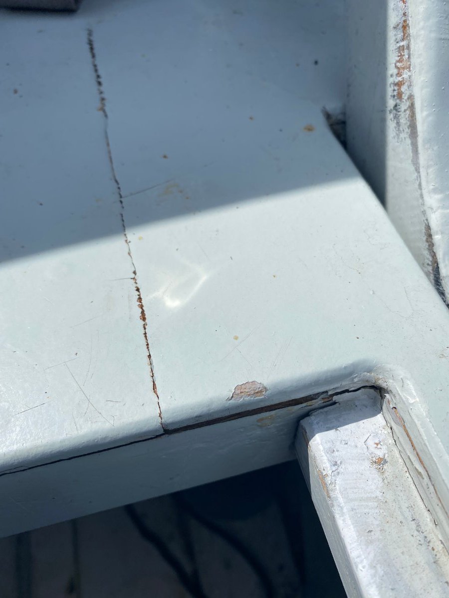

  7. I was putting on the main mast on my CS 17 and stepped back on to the seating area of the boat and heard a crack. See the damage below. It is on the step area just forward of the centerboard trunk. I was planning on sanding the area down and putting down a strip of fiberglass and epoxy and maybe wrap it around the edge. Any further ideas or advice for this repair?
